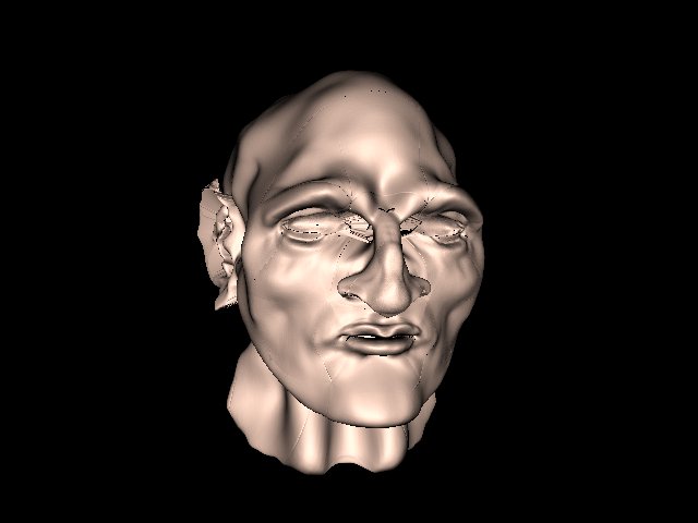

Second: this is my result however I pretty followed your video instructions.
Why?
I don’t understand! :grimacing:
Please solve my problem! :cry:

Ok firstly,
can I see the original model of Zbrush as well as the meshs of the low model polygon.
Two advices:
first: when you note defects on your model, you possibly owe verify your mapping (test the various methods suggested by Zbrush, namely, UVtile, Guvtiles, Auvtiles…
Second: control if your model does not have a Triangle, it cause defects of seams.
I believe to see on your image of one of the defects because you have some triangles and bad values of levels, tests to increase or decrease these values, while leaving to the negative value half less than the positive value.

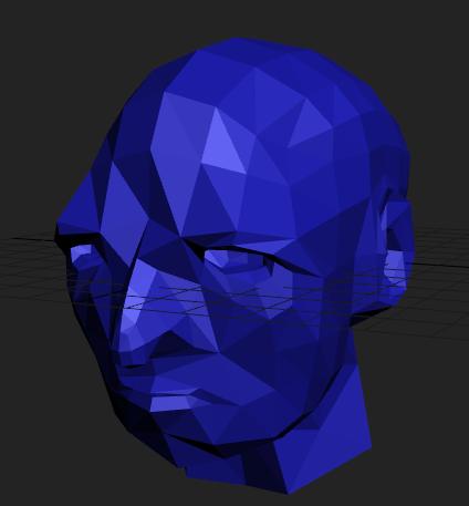

the problem is that my model is full of triangles (see the figure #1) however in the export options in zbrush I clicled on Quads…

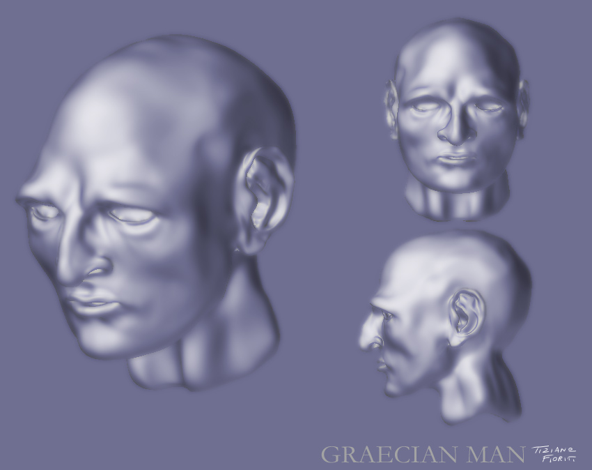

The original model in ZBrush is this (see the figure #2).
The question is: how can I solve the triangulation problem? :cry:

I don’t have an magic answer but if you want, post here you low poly model and your Displacement map picture and I will try to see…
