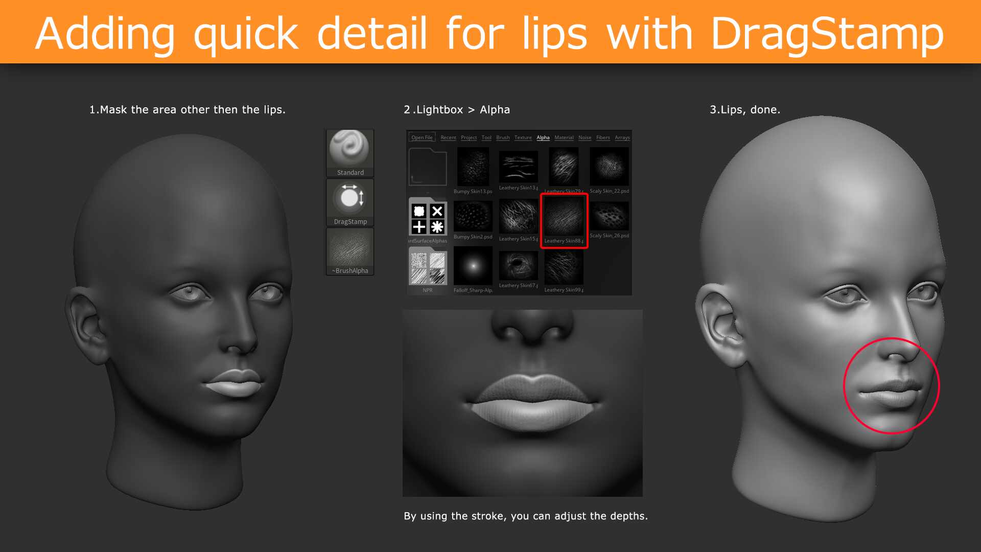

Quick and rough detailing on lips
lips_alpha_eng

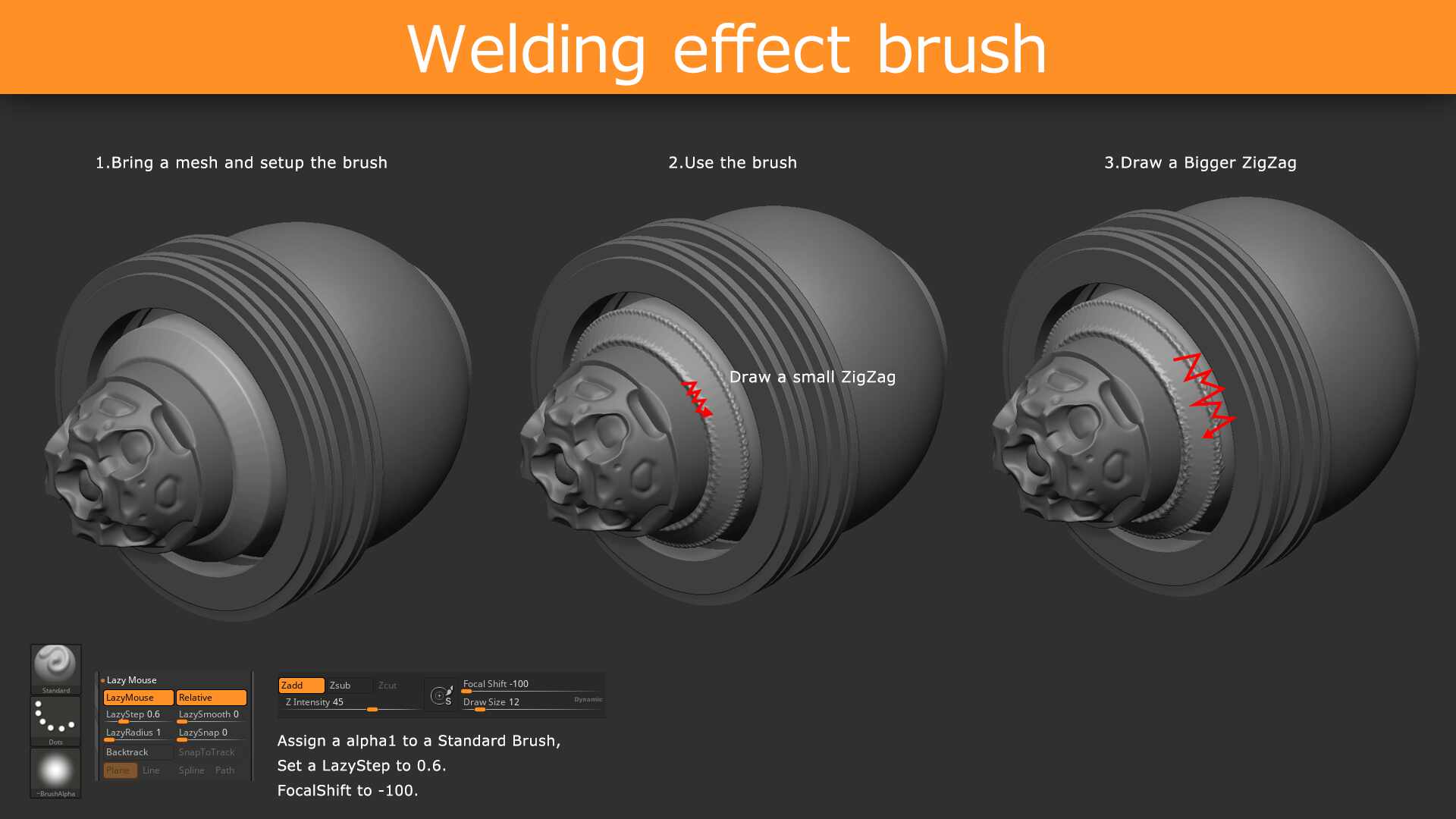

Creating a welding effect brush
welding_brush_eng

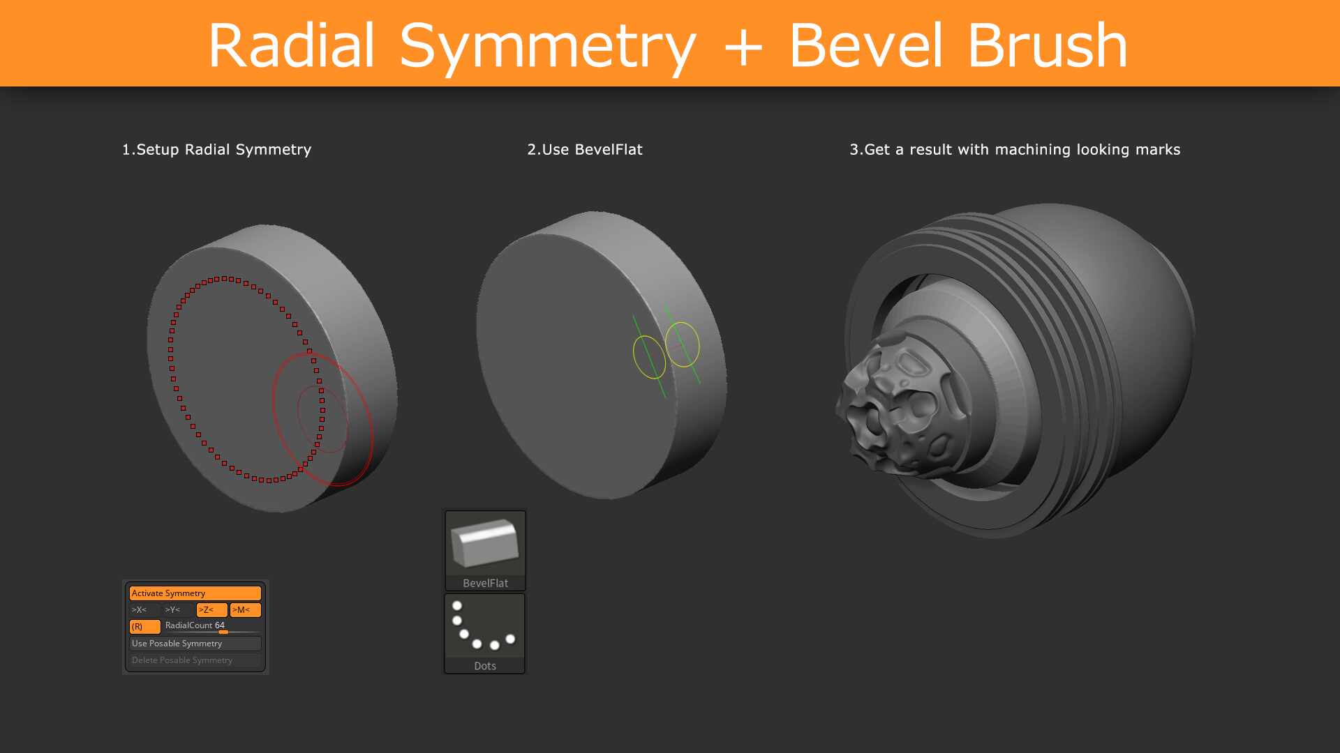

Radial Symmetry + Bevel brush
bevel_radial_eng

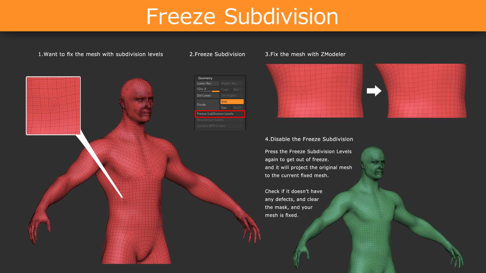

How to use Freeze Subdivision and fixing a mesh with subdivision levels.
freeze_subdivision_eng

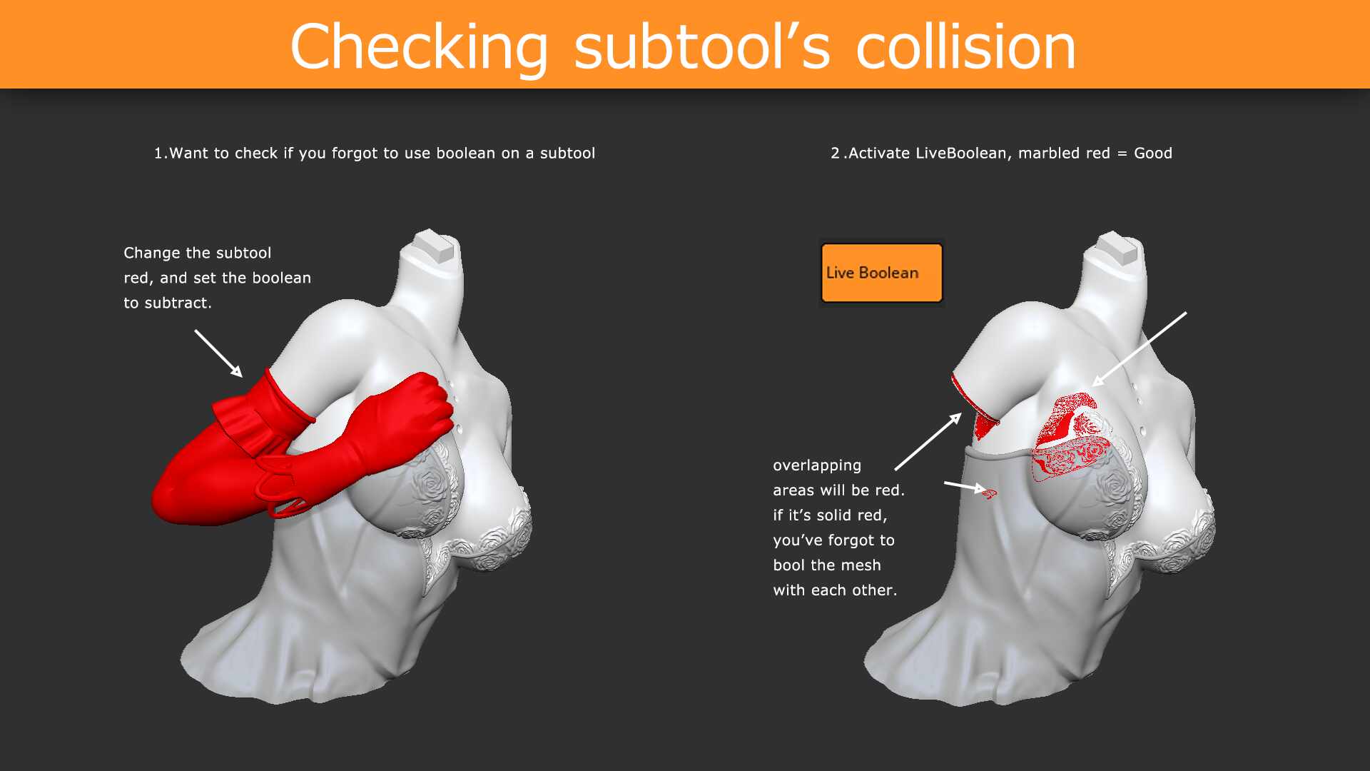

How to check if you’ve forgot to do some keying when using boolean.
collision_checksubtool_eng

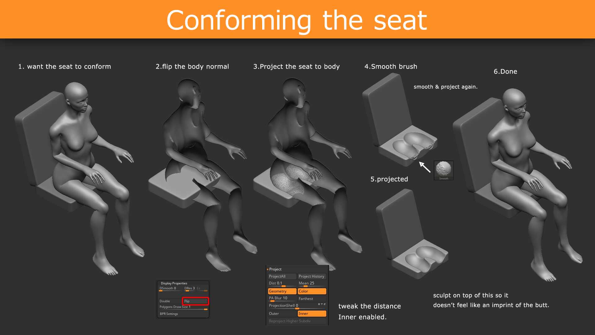

Using Project Inner setting to conforming the seat to the body.
conform_eng

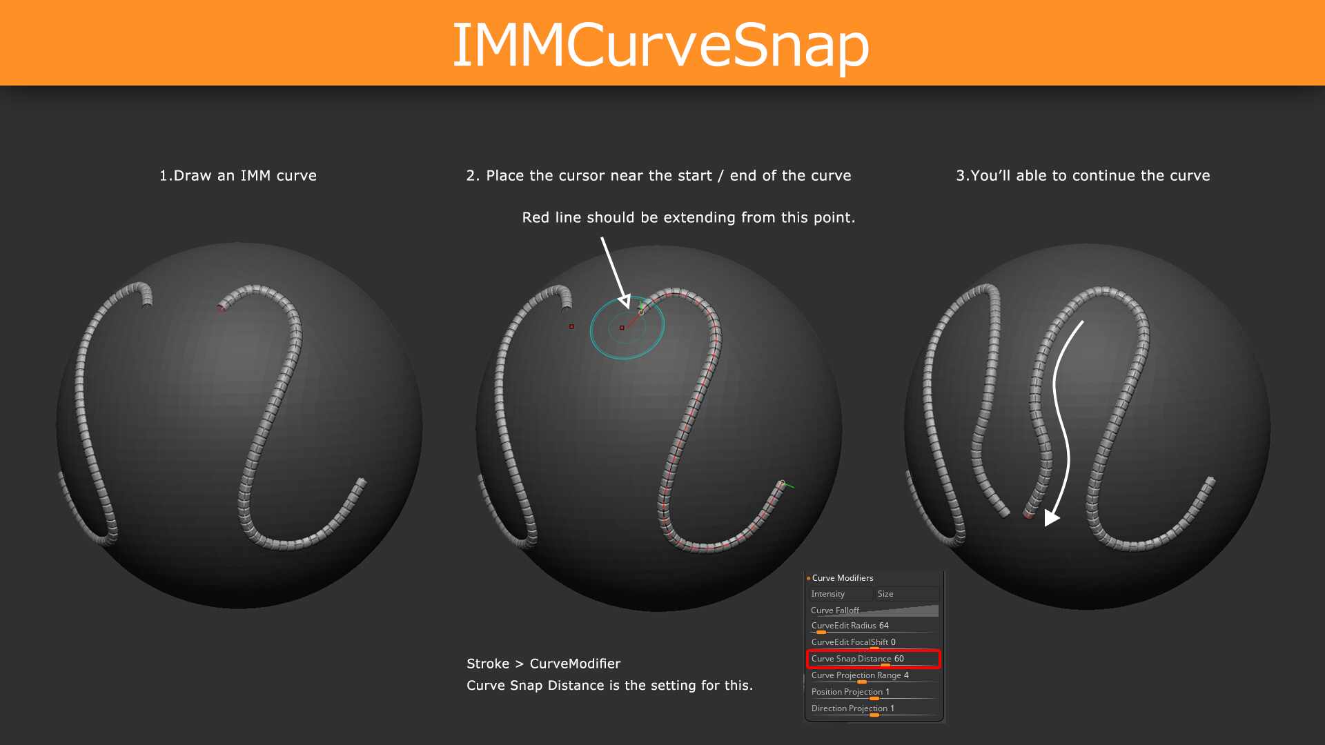

When you want to draw a looong IMM Curve, the snap feature is your friend.
curve_snap_eng

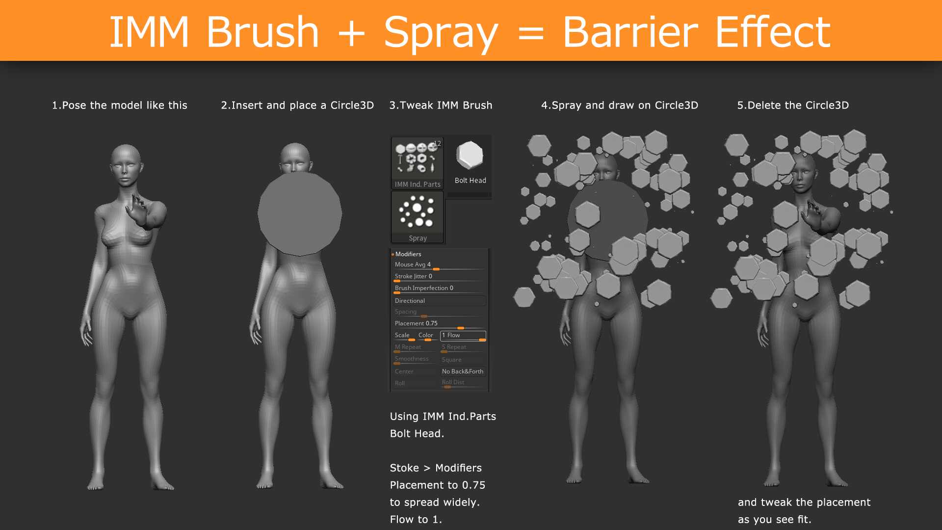

Using ZBrush 2024’s IMM Brush spray to get a Barrier Effect.
imm_brush_spray_eng

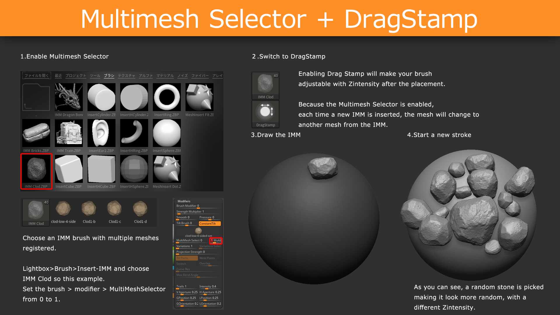

Using ZBrush 2024’s DragStamp + Multimesh selector to get random IMM inserts.
mminsert_dragstamp_eng

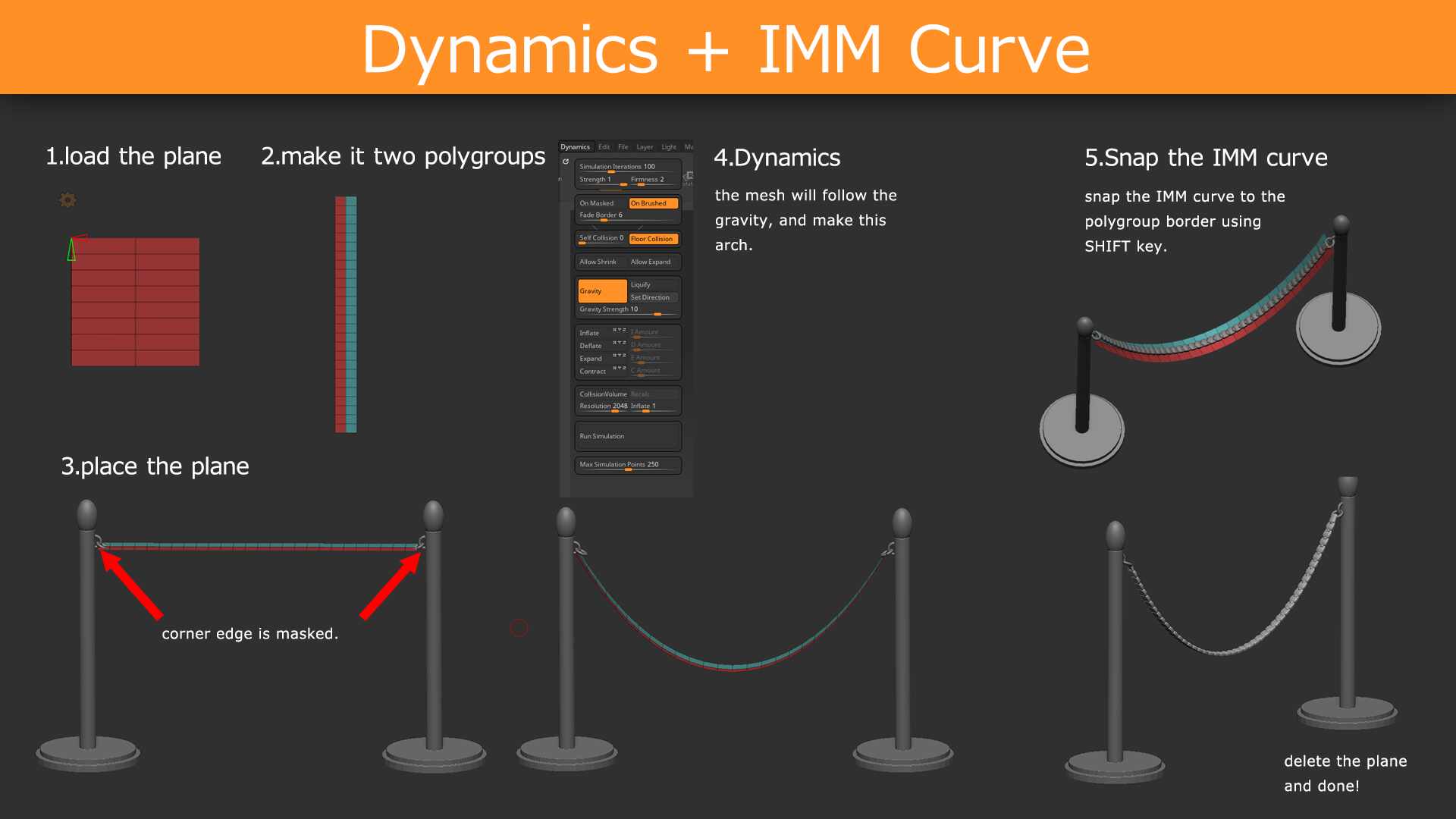

plane → dynamics → IMM curve combo
imm_curve_dynamics_eng

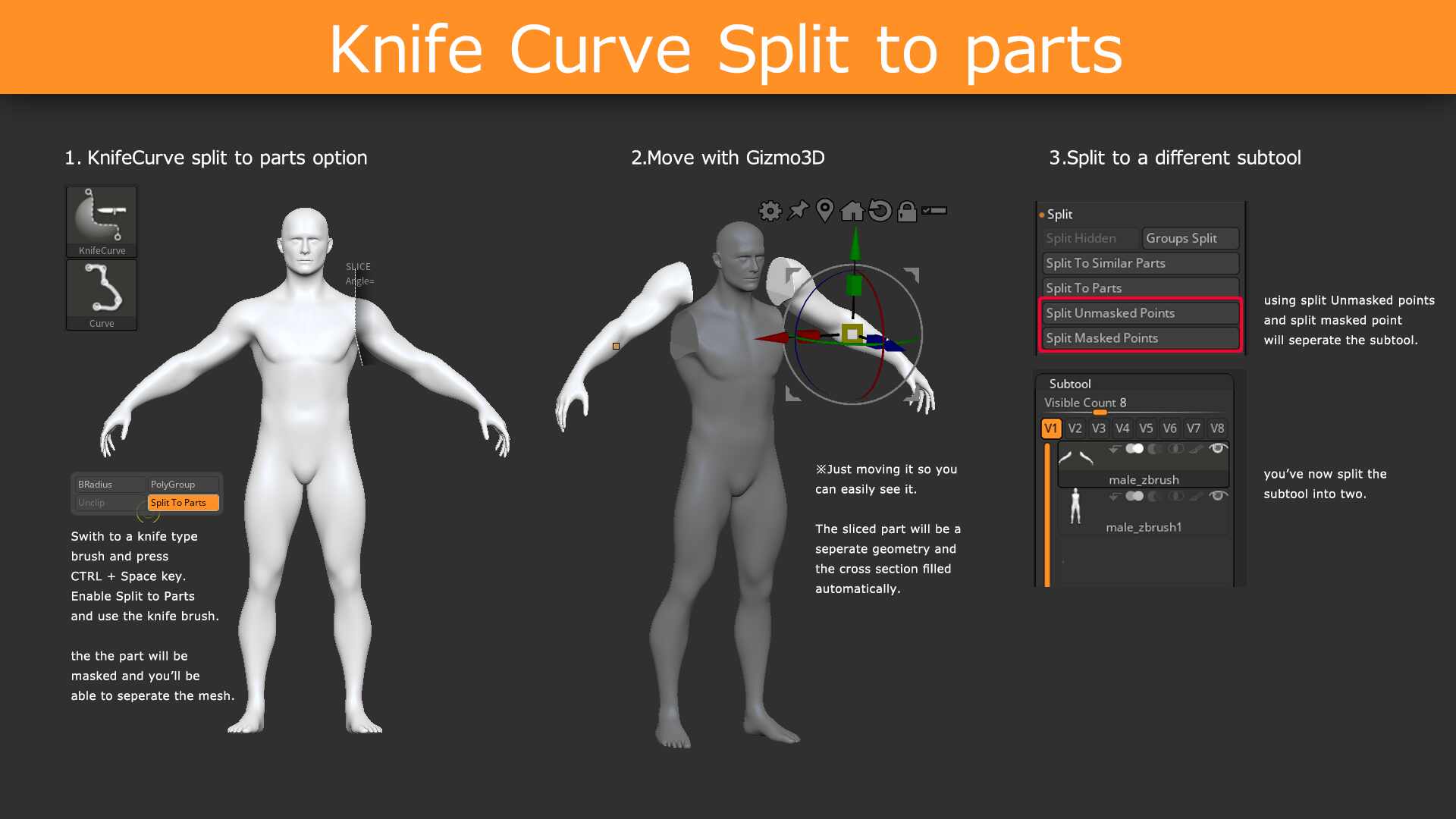

ZBrush 2024’s knife curve split to parts option.
knife_keep_eng

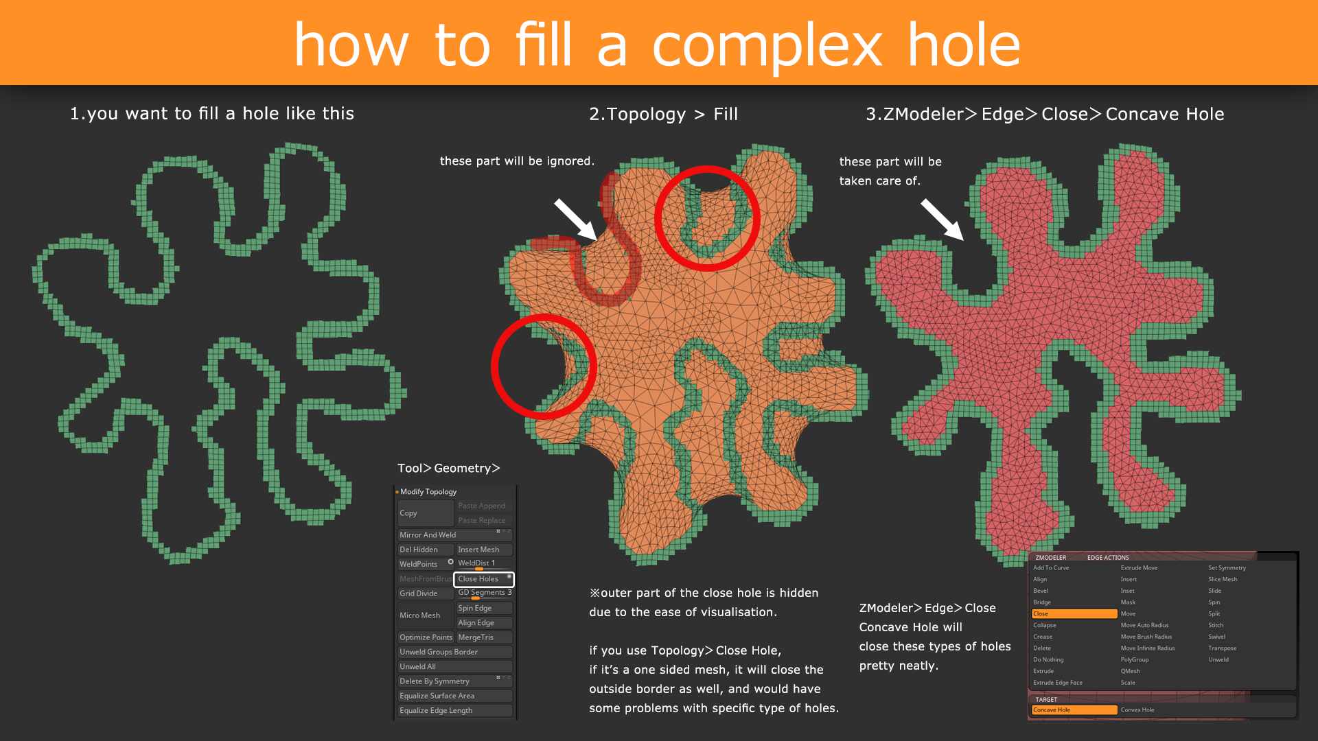

Modify Topology Close hole vs ZModeler’s Close
curve_hole_eng
Modify Topology’s close hole is easy to use onclick solution to multiple holes, but if you want to close a specific hole, it’s better to use ZModeler’s close hole feature.
