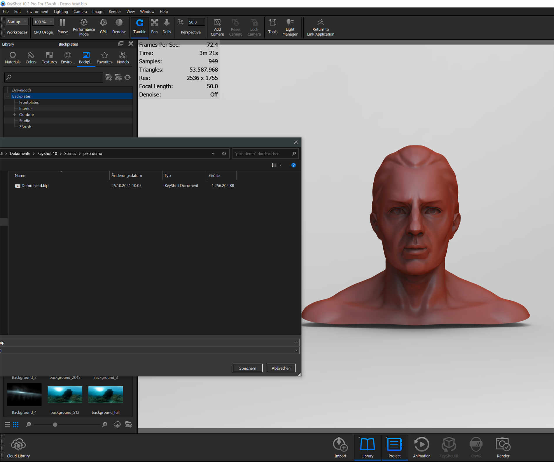

To show that this has nothing to do with my work,
I enlarged the original Pixologic demo head
to SDiv 7 = 14.582 Mil .ztl = 746.109 KB
saved as Keyshot .bip = 1.256.202 KB
Demo head
I can only hope that the Pixologic Support can help me.
