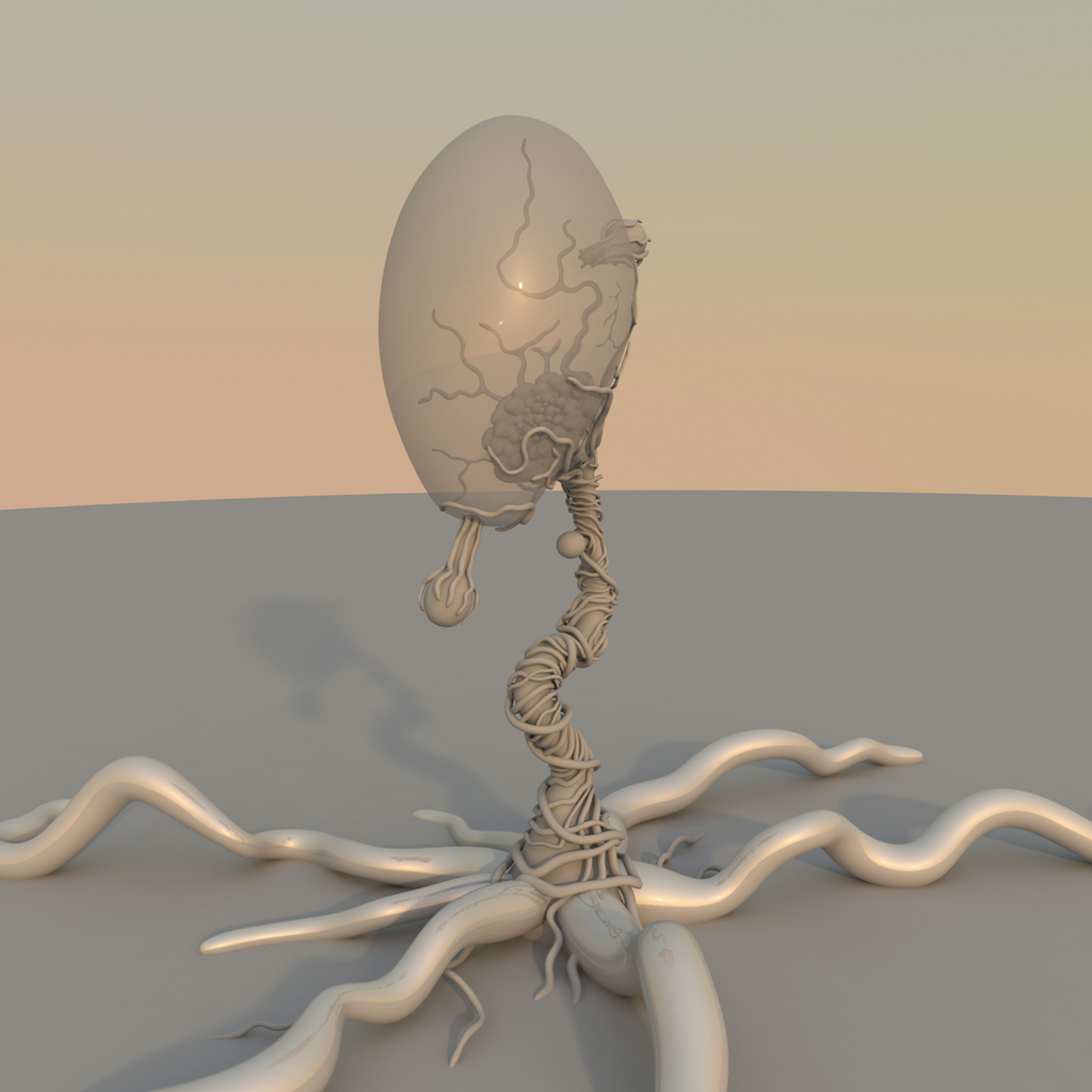

this picture below is what i am trying to do with the “vines” currently i am using zspheres but the curvetube brush is alot more “fluidly” if thats a word and it makes nicer looking vines opposed to zspheres and i am just trying to speed things up a bit as pulling out each vine with zspheres is taking ages and i still have a lot more to do…

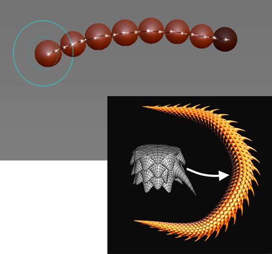

Yes you can repeat. Just click the 5 key or the Snapshot button that is in the Stroke palette and ZBrush will drop the chain and allow you to move the curve around. I would also turn bend off if you were going to do the above.

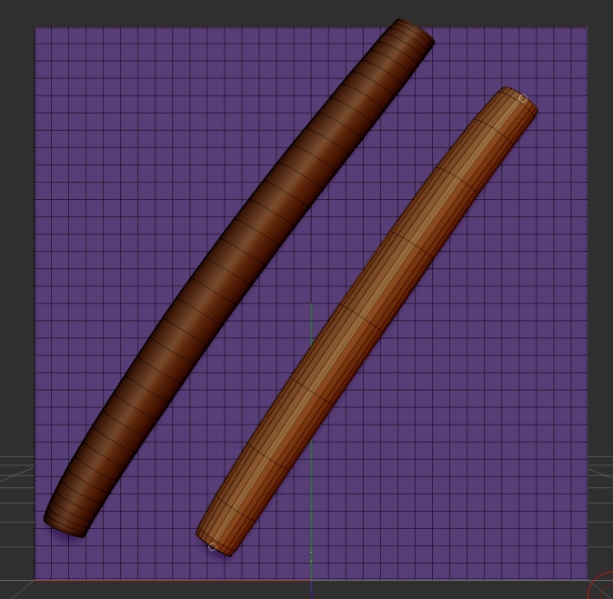

To change the spades you are looking for you need to first add those spans to the ring before selecting it on the brush. In the example below I change the SDivide and LDivide to 100 for the tube that is to the left of the plane and the tube that is on the right I changed the SDivide and LDivide to 19.
Make sure to make these changes before you select the ring on the CurveTube brush.
Let me know if this is what you were looking for.

really, i am not in love with the idea of using dynamesh to make all of the vines into one mesh as this messes up all of the clean topo (see pic) maybe theres another way , which i havent found yet.

well i just tried lowering the denisty of the ring in the initialize tab and then cloned it , to add to insert mesh tab , but still not getting the resolution the same as the curvetube brush (see below)
All the default CurveTube brush is using for the mesh is the Cylinder3D so if you do the same as you did with Ring3D and change the initialize state of the Cylinder3D then select that in that preview window in the Brush>Modifiers palette you will get what you want.

i really need the tidy mesh like what you get with zspheres as i export them out for render/animation in Maya like in the picture above. and using the curvetube brush to make a tree branch has sperate pieces so you have to dynamesh them to create a single mesh , but this becomes “lumpy” and unweilding , the topo is in all the wrong directions and i wouldnt want to spend ages retopoing… the idea to use the curvetube brush on the above model was supposed to speed my workflow up not slow it down…
also the cylinder3d has those triangle poles which are undesirable for this model…and the ring3d is open and make a nice “tube” , but i think it will be double sided which could cause issues in Maya… i will have to check that…

Thanks for your answer, but this is not what I’m looking for. If we could repeat a shape inside of the chain/curve…
