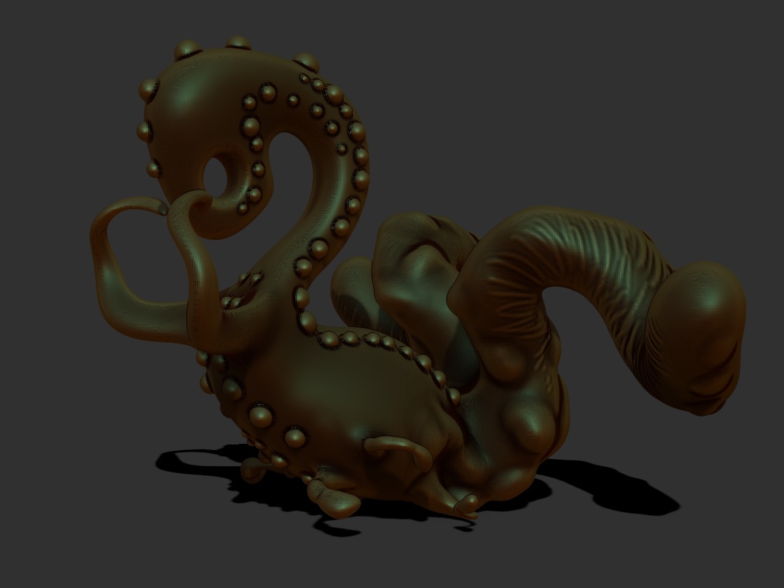

Oh!
Speaking of being an airhead after noticing it looked like a beasty and adding those spheres you mentioned I went a bit over the edge playing with color too:

Finally after many hours playing around this is as close as I could get.:frowning:
  1. Nudge brush needs a LOT of practice. You can see how out of wack the wings are…all wavey :slight_smile:
  2. Still not sure how Pixolator cut both wings. Tried symmetry Ctrl Move but things just went horribly wrong. I ended up cutting the one wing, hid/del half the model then used Mirror&Weld. Tried Smart Resym and a few others which didn’t work.
  3. Couldn’t get the color right, ie. when cutting, etc. on top of that my pc had problems handling the Sub operation and ZB crashd a lot…time to upgrade
  4. Watching the video, I’m not sure if he inserted a new sphere of different color (black,red,blue) or used a polypaint trick to change the color
  5. Need to figure out Insert brush controls, ie. rotation, scaling, etc. My object always out upside down or back to front or something and I have to use W/E/R to get it correct.
  6. Polypaint - Lazymouse only seems to work with the initial drawing of a curve but not after you pull the curve to paint
  7. Polypaint - Not sure how to get the glow effect around the balls. Is the intensity just set very low so the it creates a gradient effect and doesn’t wash out the black behind it?
Thanks again for the Making Of video guys…helped a lot :slight_smile:

  1. Nudge is WAY harder then move, but easier (for some stuff then SnakeHook).
  2. I think I would have used Mirror and Weld on the wings as well. (I do not think that Pixolator did however.)
  3. Not sure what you mean by "Sub Operation".
  4. I think the spheres are mesh insert with different color, just set to RGB? (you need to set the initial color and materiel to do this using "Fill Object" in the Color Menu while set to MRGB).
  5. I have no control over MeshInsert brushes either, If I move the mouse at all after the first stroke they go insane.
  6. Lazymouse baffles me mostly, I try to avoid it as it makes lines I did not draw..... I think.....
  7. Glow only works in Best render mode which is apparently geared to 2.5D I think.... but I would ask some one who has a clue, Zbrush rendering is different from every thing else evidently. I honestly haven't a clue, I dont have anything else yet!

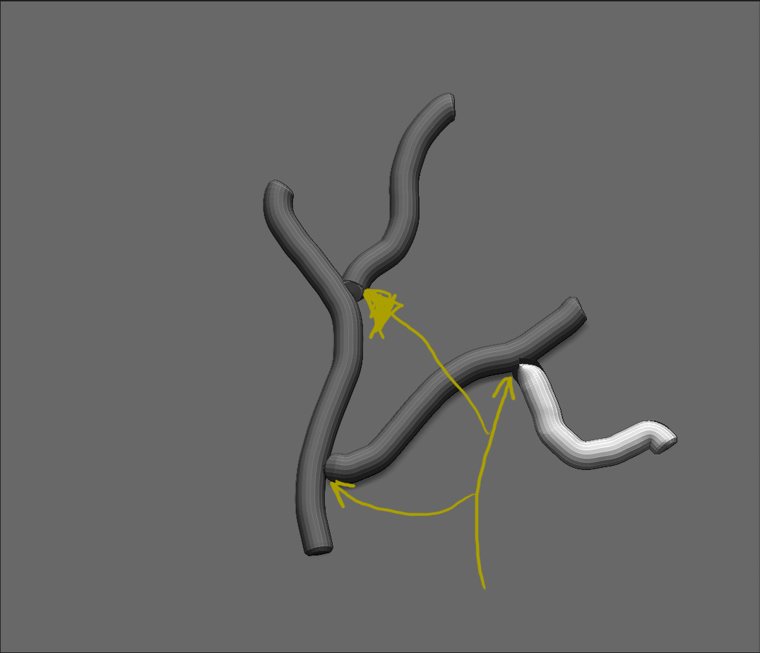

i just used a sphere as a example … i have been using zspheres to create a dense patch of creeping vines on a tree trunk and some one suggested using the curvetube brush to speed up the workflow, i had tried zsketch aswell which produced a more organic look ,over the zspheres , but obviously the mesh is too dense.
with the curvetube brush it produces a nice ā€œorganicā€ looking branch but the mesh itself has triangles on the caps and the mesh is still quite dense, there doesnt seem to be a way to lower the rez on the strokes., or to create ā€œoneā€ winding stroke around another mesh…

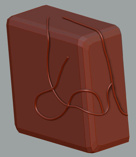

well been messing about with the curvetube brush and "sort of " came up with a solution for using multiple strokes, as you make the strokes they auto group but they are inside the subtool you are using for the guide so you have to group split and then merge down so that each individual stroke become one subtool you can then dynamesh it and then youve got a " vine "…
however … i really dont like the way the mesh is generated , its nothing like zspheres…

@ tyrellcorp
  1. Select the CurveTubeSnap brush.
  2. Decrease the brush size.
  3. Draw on your polymesh.
  4. Adjust the curve if needed.
  5. Press CTRL+D to subdivide the tube if needed.
  6. Smooth if needed.
  7. Unmask and go to step 3.
You can do this either as a dynamesh or not, it’s your choice. Some things to experiment with:
  • Brush:Modifiers:MeshInsert Preview (You can choose a polymesh to draw with. Stroke doesn’t have to be drag.)
  • Brush:Depth:Imbed (Increase this if your tube is too imbedded.)
  • Stroke:CurveEdit Radius (Decrease to make finer edits to the curve after drawing it.)
The CurveTube brush with snap turned on works too, but changing the imbed for it has little effect.
i will give it a try … but how do you turn youre mesh around to another angle and still draw out the same tube? this is really what i am trying to achieve… as soon as you go to rotate your mesh you end up having to draw out another tube and not the same one… if that makes any sense,…
thanks by the way…!!
The only way to do that is to use symmetry as far as I know… MatchMaker wont even do that as far as I know. Basically you are going to have to make it with either the tubes or Zspheres and then sculpt the imperfections I suspect, but even with the tubes that is not all that hard to do I wouldent think…
