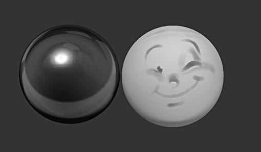

After getting mad searching for knowledge about transparency in Zbrush, finding only a pair of good tutorials about it, but for the previous Zbrush 4 release, I have just found the way to achieve transparency in Zbrush 4R2, with a very easy method.
Maybe everybody knows about it, I´m a sort of newbe in Zbrush, but I thought it was a good idea to clearify with a videotutorial.
Here you can see the easy way of rendering transparency in Zbrush 4R2, thanx for watching.
[youtubehd]wwHCsJyKxKs&hd=1[/youtubehd]
