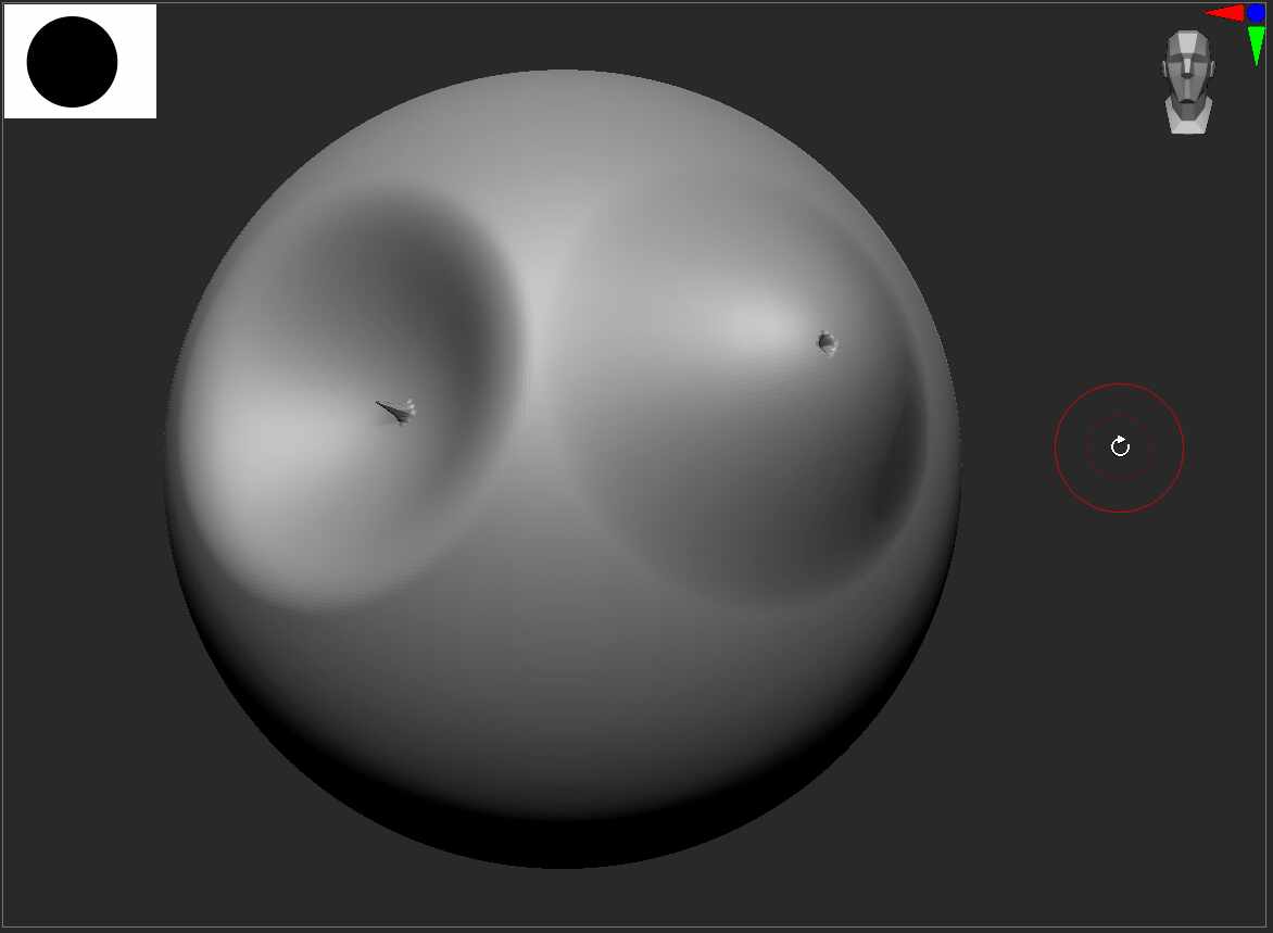

I have a problem with using the move topology brush. Every time I use it, an artifact like the one in the screenshot below is created. :thinking:
It seems to me as if the vertex located at the center of the brush circle was moved less than the others, so that spike is created.
I tried restarting ZB, resetting the brush and also resetting the entire ZB interface, but the problem didn’t go away. It happens with each polymesh I tried with and in whatever direction I move the mesh. :weary:
