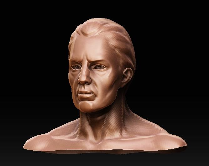

I made a quick tutorial to show you how to make a multi-pass rendering with zbrush and photoshop. Thanks to stumpf and Erklaerbar for sharing your materials.
You can download RS_GreenClay [here](http://www.zbrushcentral.com/zbc/showpost.php?p=387852&postcount=57).
The original OK set 15 can be found [here](http://www.zbrushcentral.com/zbc/showpost.php?p=377613&postcount=37) and the modified one [here](http://www.zbrushcentral.com/zbc/attachment.php?attachmentid=73589).
[![tutorial.jpg|1200x978](upload://lctVN8lAZMObTIWOj6c51BiyjgP.jpeg)]![example.jpg|912x460](upload://6OdAVMTQkQEV2v5GmD6Mr3y4vEa.jpeg)

Just a question. What is the difference between Opacity and Fill in Photoshop?
best
Henning+
Opacity controls how much the layer is going to be seen and fill controls the blending effect itensity.
btw: sorry for my english :confused:

Thanks for this tutorial. it helped me understand multi pass redering better, but I have a small issue.
I am using GIMP (as I cannot afford PS for some time yet) and I cannot see a FILL setting. There is only the soft light setting and transparencey setting. I seem to be getting a kind of metalic look to my models when using this method. I used the demo head tool with the sculpy material and then layered all the passes as you said, but without the fill level set as I could not see this in GIMP.
Is there an alternative to this fill setting? or am I looking in the wrong place if anyone else uses GIMP?
