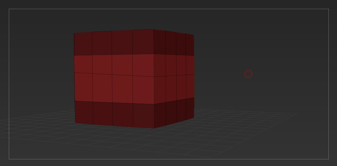

@Spyndel your ClipCurve (stretch Edge) methode works not really.
Watch after the ClipCurve your Backside of your Edge Loop.
The only methode where works good is the Point > transpose (methode). ;o)
And if is for someone helpful:
Preferences > Transpose or also Transpose Units. You can optimize your own transpose tool. ;o) For work more exactly with the transpose tool.
It’s more of a “flatten edge” method, and it’s not my method. Picked it up from a video.
I didn’t fabricate the screenshots. It’s possible you’re not understanding something or other. Would you care to illustrate how it’s not working for you?
Holy s***. Häääääääääh* lol, now it worked.
Really strange.
But I think I’ve found my problem:
If you move the point-(the shifted Edges) with: Point > Move (so you have moved the point manually/by hand) and the Edges are not set “correctly” straight down. And if you want now have again back the straight edgeloop/the two Edges with that point, then gives “your” method this result:
The Edges are now back stretched. But in the backside is the Edgeloop higher as result.
But if you move the Point (for receive the shifted Edges back) with the transpose tool methode before, you receive the right result with your Edges stretched method (ClipBrush).
So seen, it was my fault. Therefore sorry for that.
But in the same time it shows that this method works not always (if you move as an example your Edges with the: Point > move method before).

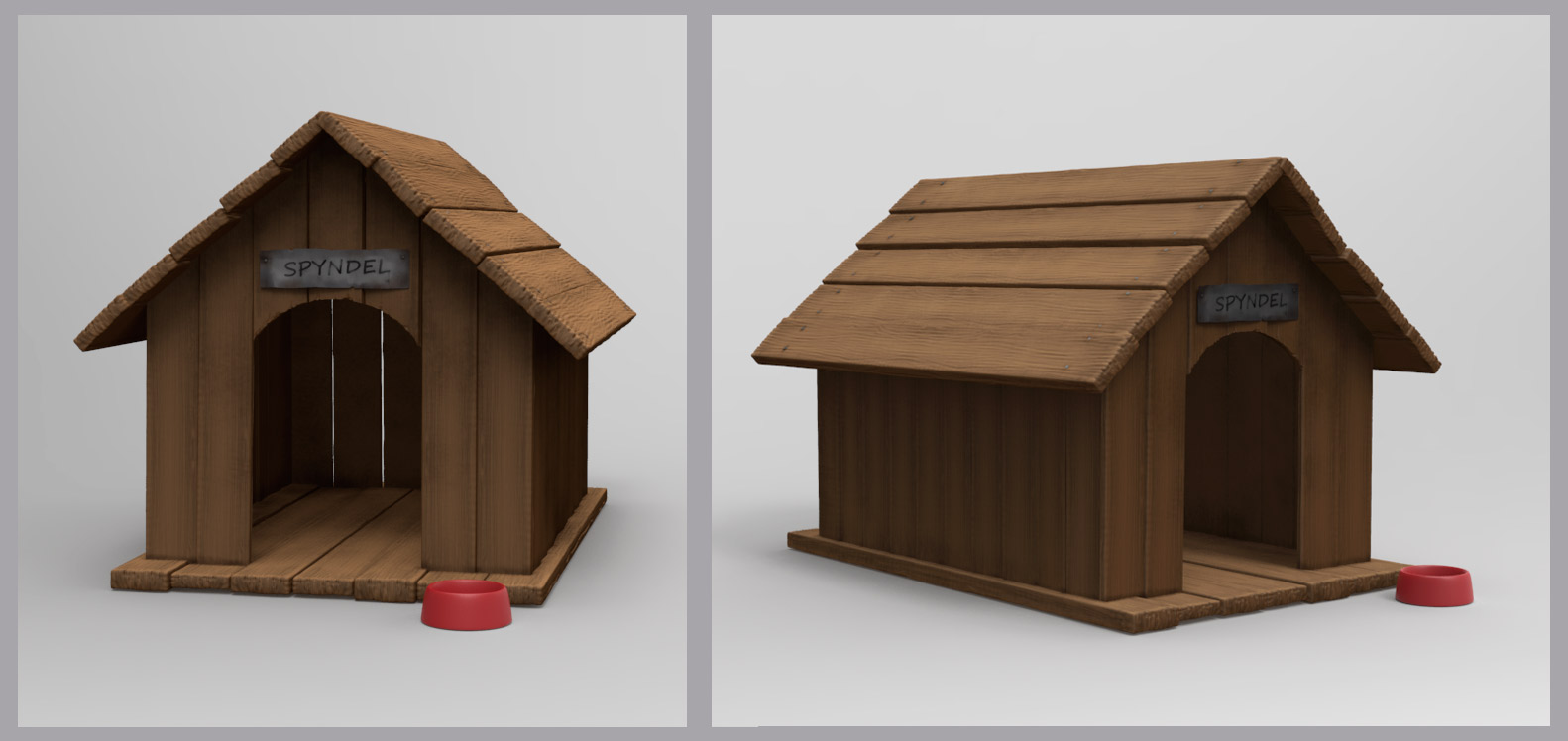

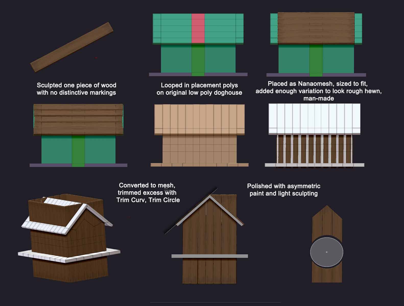

I wanted to spruce up my doghouse a bit, so I built a Nanomesh doghouse on top of my original low poly doghouse using it as a sort of frame. I doubt it’s 3d print friendly. I’d have to merge all the planks with the underlying frame to make it solid, but I just wanted to see those little cracks of light in between the wood. :slight_smile:
The basic process here ( Tip! You must sometimes use Tool > Geometry> Modify Topology > Align Edge to get all your Nanos going in the direction you want them to):
Spyndel what are the step for use nanomesh? i still confuse with it,
thanks in advance:+1:
There are a couple different ways to get started with it, I think.
First, prepare your nano by angling the camera at it in the way you’d like it to appear on the target polygon (front facing, side facing, etc.)
Then:
  1. If ZModeler is active, you can make it into a nano by using POLYGON > MESH to BRUSH > Target:ALL POLYGONS and clicking on one of the model polygons.
OR
  1. Prepare your Nano, and in the Brush menu, select “Create Insert Mesh Brush”, and then “Create Nanomesh Brush”
Either way basically creates a new ZModeler brush with the Nano loaded. Select POLYGON > INSERT NANOMESH with the desired target, and insert the nano on the desired polys. Once placed, you can change their attributes in the Tool > Nanomesh menu.

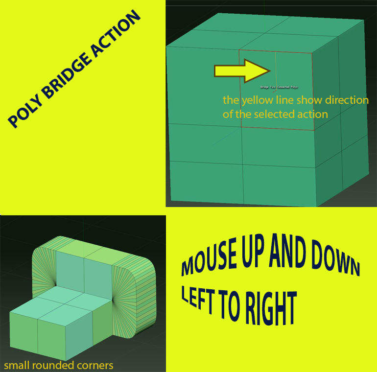

ps:the image below is related to bridge action on connected polys that some guy in other thread asked for…
Great Thread :slight_smile:
When bridging two adjecent faces zb seems to not merge the tris to the center vtx, but quad it out so that point has a bunch of extra edges. Anyone else zoomed in close and noticed that?
Edge Align tool looks great as well. Anyone know if there is a way to perfectly center a loop between two other loops after it has been created? That would have been neet :slight_smile:
