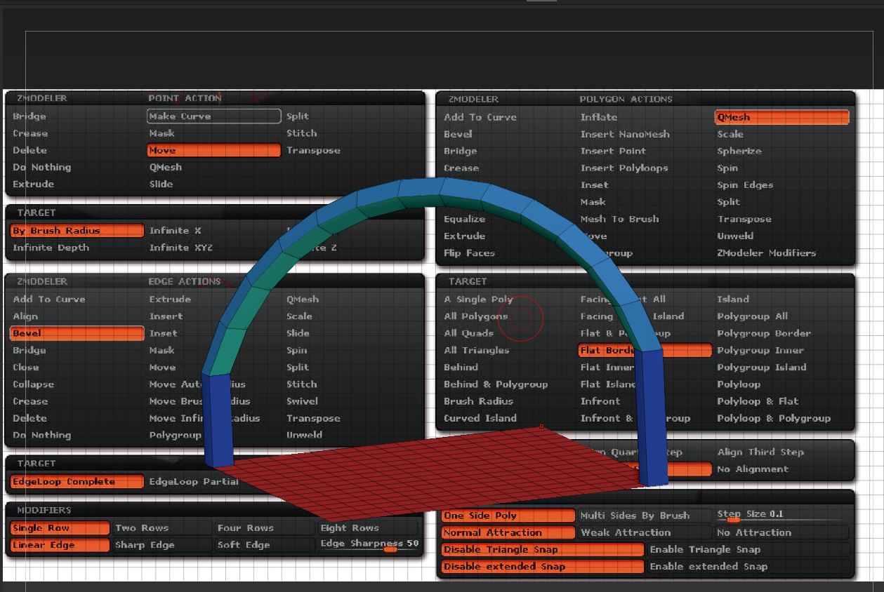

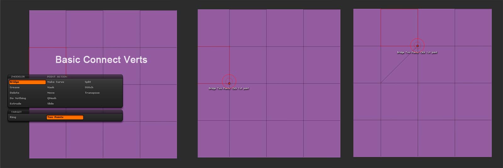

  1. Connect the dots. Basic vertex connection. Point> Bridge> Two Points :

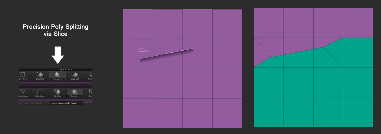

  1. Precise Poly Splitting via Slice. Slicing is by far the easiest way to do this, although you will have to hide any backfacing polygons you want to protect, as it will slice through the other side as well. It will also reassign your polygrouping, which may not always be desirous. (Tip: don’t slice completely across the edge of a polygon that is bordered by hidden geometry–it will insert nearly invisible geometry to force quads that will cause smoothing issues, but can’t be easily seen or isolated):

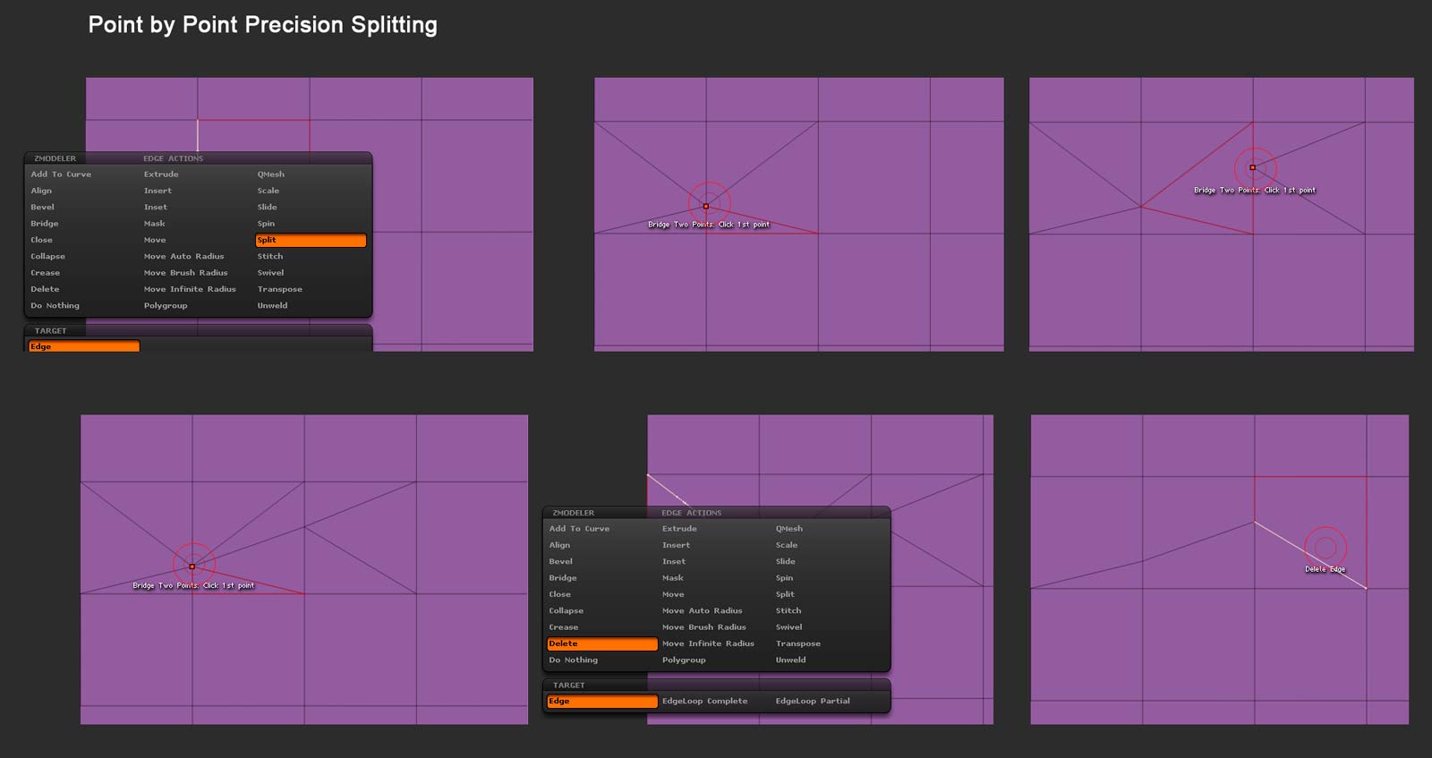

  1. Precise Point by Point Poly Splitting. This is a little messier, but it may be the best way to work on some complicated situations not easily sliced, or if you want to preserve complex polygrouping. It’s important to remember that Zbrush won’t tolerate N-gons, so it’s going to insert a lot of extraneous edges as you do this to force quads and tris. Just try to ignore them and focus on the placement of the verts. Edges can be cleaned up afterward. Split the lines first with Edge>Split, and sliding the verts along the edge to where you want to put them. Then use the point by point connection in number one to draw the actual line you want, and delete any unnecessary edges:

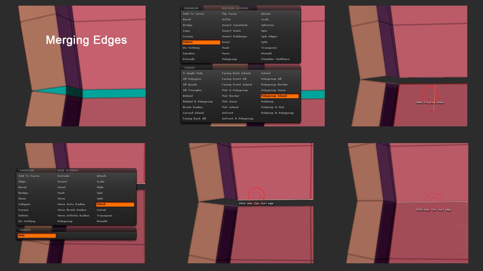

  1. Edge Merging. Speaking of cleanup, sooner or later you’re going to end up with some garbage geo you’re going to want to simplify in an isolated area where loops don’t apply well. QMesh is so magic in other ways, I’m not convinced that I’m not missing a mode somewhere where you can just slide Geometry into other geometry and have it auto merge. But in the meantime, this is the best way I’ve found to take care of that. Unlike Point stitching, Edge Stitching requires a hole, so you must first delete the target polys via polygroup selection, or highlighting them one by one with alt clicks. Then set edge mode to Edge>Stitch, and click on the edges on each edge of the hole to merge them. It will average the position of the two.

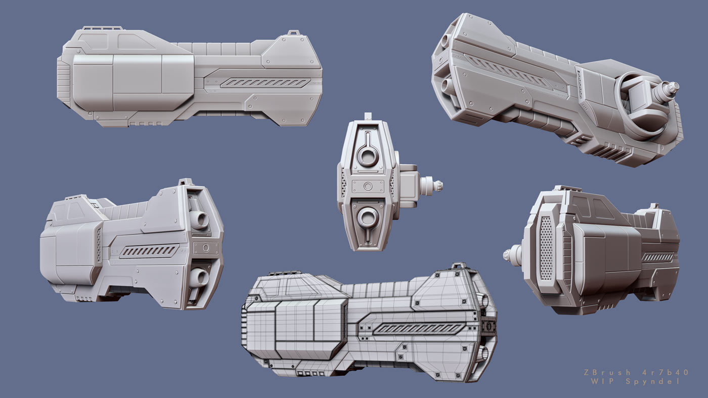

That said, its entirely possible to use ZModdeler as a polygonal modeler once you learn the best way to go about things. This Laser cannon was entirely modeled in Zbrush at the wire and vertex level, as I would in a traditional modeler, which you can see by all my crazy ugly wiring all over the place to reinforce edges and curves. It’s mostly one piece (click on the lower attached image thumbnail for a larger version, I didn’t want to blow out the thread formatting):
It’s a tool, like anything else. It can be learned to various degrees of proficiency. Some people might stop at at QMeshing, but you can take it farther.

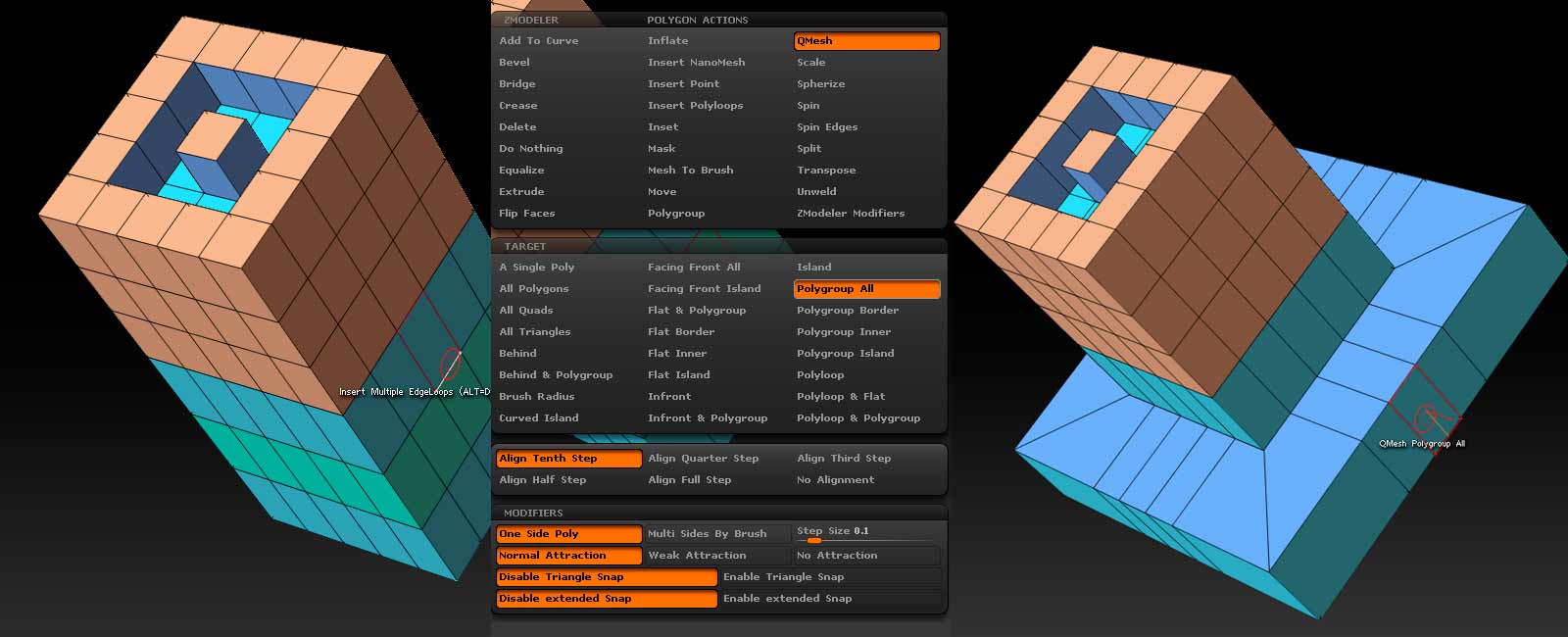

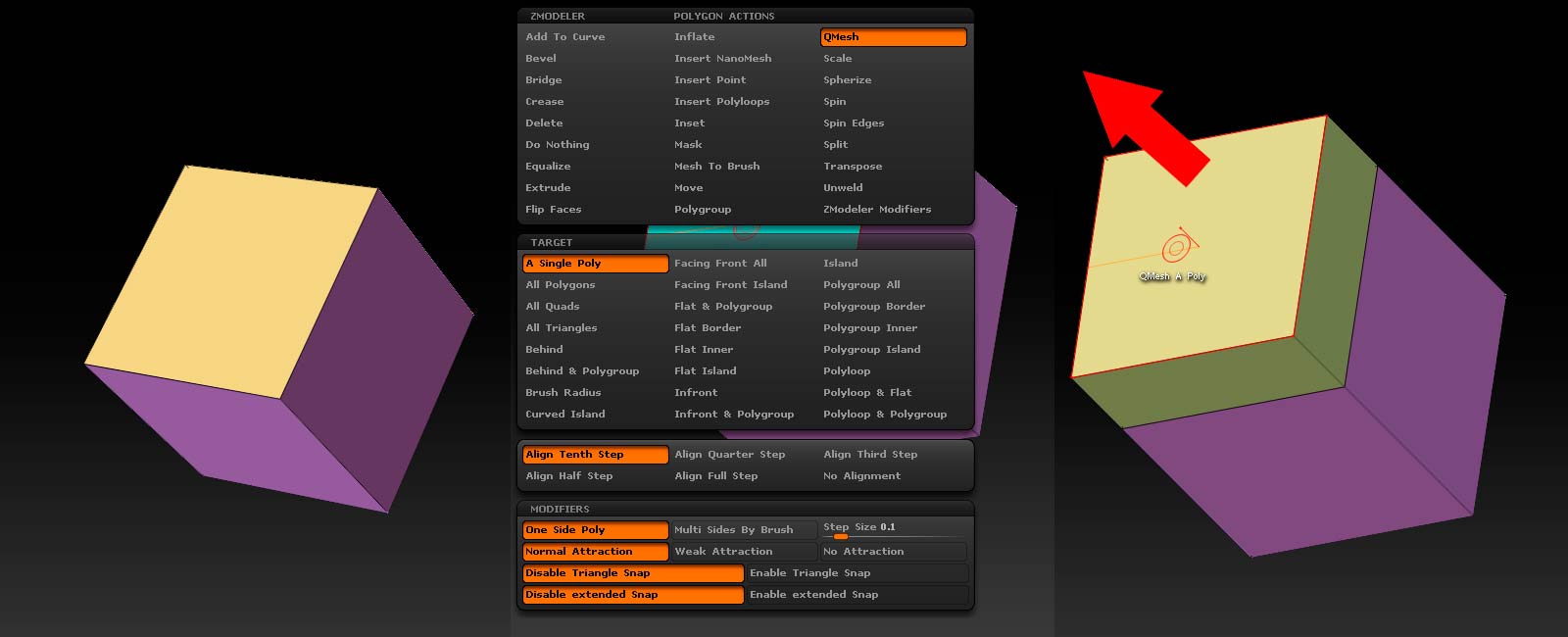

Before I model the doghouse for which I’ll be using QMesh a lot, I thought it would be best that everyone had the Qmesh fundamentals down. QMesh is the heart and soul of ZModeller, and a lot of fun to use. This should cover the basic points.

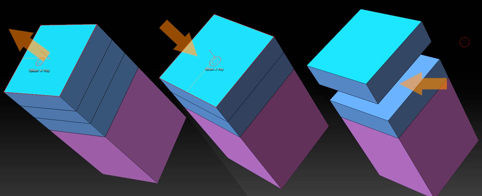

  1. I’ll start with a simple 6 sided cube. Selecting the ZModeler tool, I set the polygon action to QMesh, and the Target to “Single Poly” (we’ll talk a little more about targets later). (Tip: ZMod can have context actions for points, edges, and polygons, and will execute that action depending on what you are highlighting when you start the action. At times, it may be helpful to set the action to “Do Nothing” for components you aren’t focusing on at the time. This will keep you from inadvertently committing an unwanted change if your aim is off.)
QMesh extrudes polys outward or inward depending on the context of your cursor movement relative to the model. In most cases it’s pretty intuitive. I click on one side of the cube, and drag it outward, which creates new geometry from the starting point:

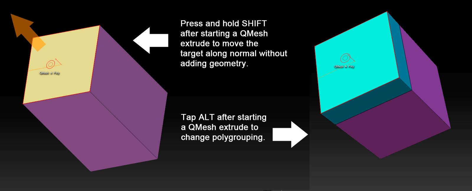

  1. QMesh has certain functions which are context sensitive to that specific tool. For instance, you can use it to simply move a polygon selection inward or outward without creating new geometry by holding down SHIFT after you you start to drag. Likewise, you can change to new polygrouping by tapping ALT after you start to drag:
  1. Continue making click and drag actions on the resulting top polygons, and you can extrude out a series. If you simply click on the target poly with QMesh active without dragging, it will repeat the last action you performed with it, which is a simple way to get even spacing.
You can then push or drag with an inward motion towards the model which will result in an inward extrusion, effectively “erasing” that polygon chunk. If you dont want to entirely clear it, but rather just reposition it, hold down Shift during the action. You can even push from the side of one of the middle polygons to eliminate entire “chunks” out of the chain altogether, resulting into two separate meshes.

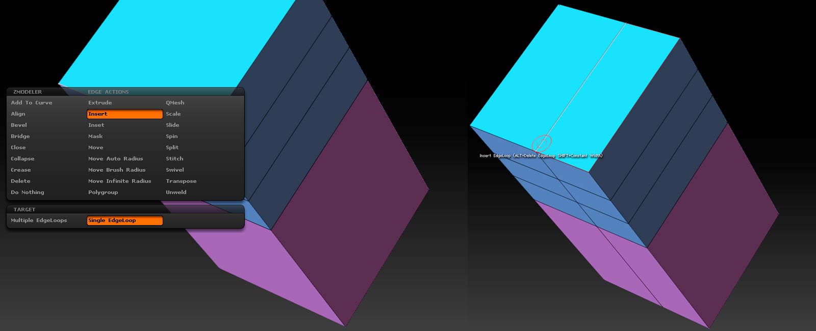

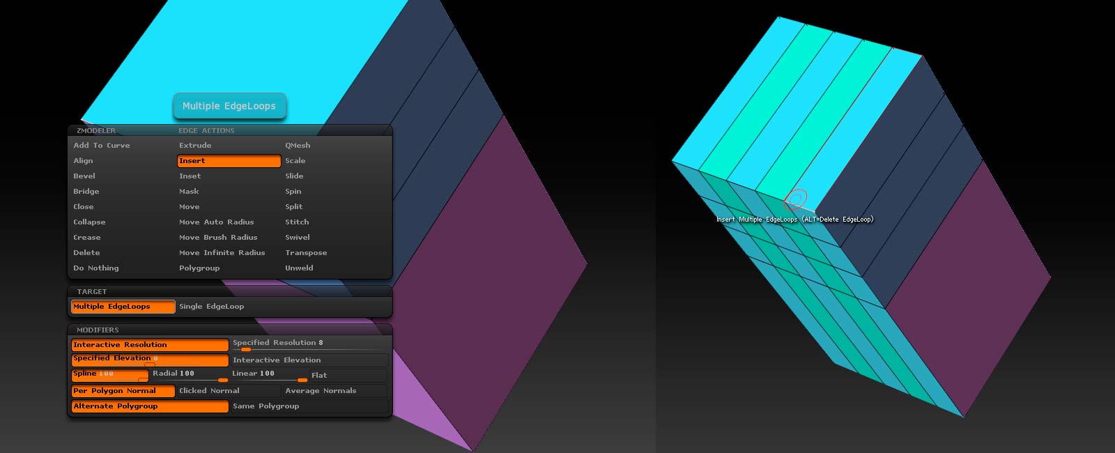

  1. To make things more interesting, I’m going to slice up the geometry a little bit, by inserting some edge loops, which is an Edge action. So I hover over the target edge, and set the action to “Insert”, with a “Single Loop” target modifier. This will allow me to click on that edge, and insert a perpendicular loop anywher along the line I want it.:
  2. However, I decide I want more evenly spaced loops to divide the cube into uniform sections. Sp I change the Edge > Insert target modifier to “Mulitple Loops”. This lets me interactively drag out a series of evenly spaced loops. I repeat the action on the other side with intersecting loops:
  1. I unify the polygrouping on my newly segmented cube to make it easier on the eyes. Then I just play around a bit, pushing and pulling single polys out.:

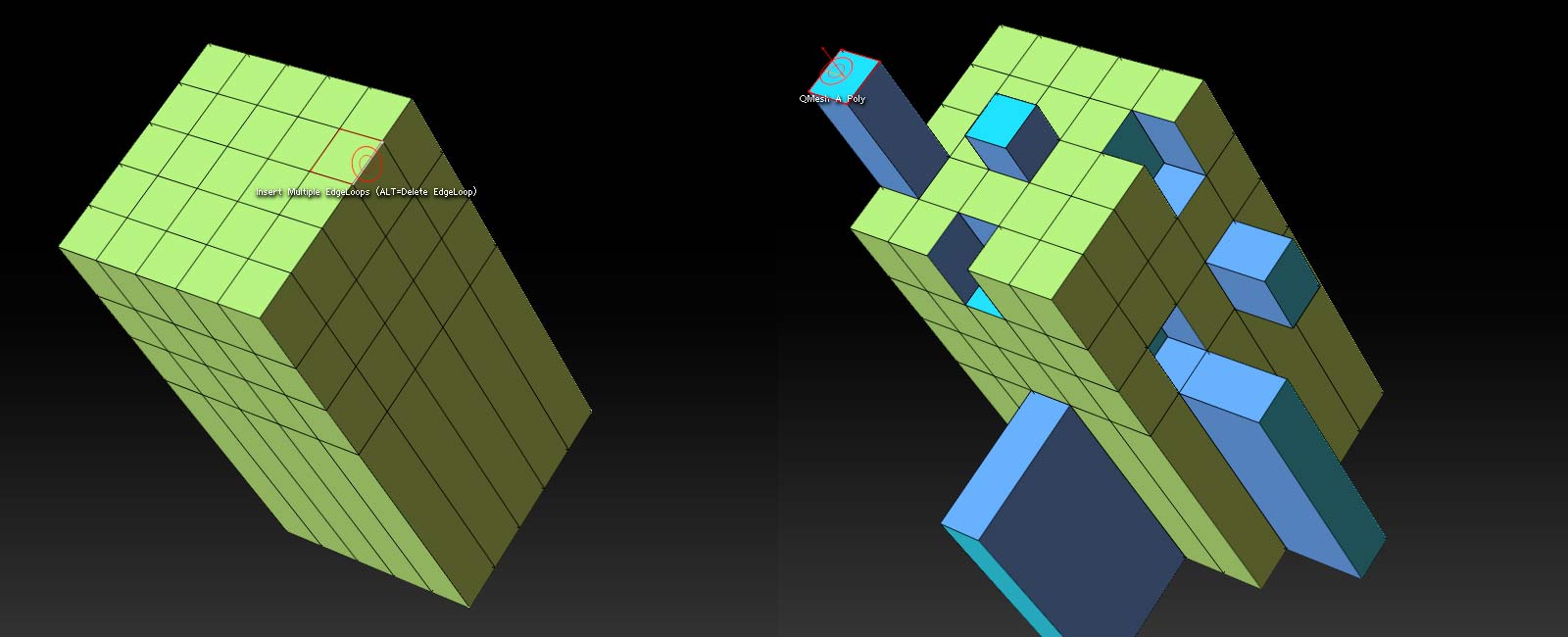

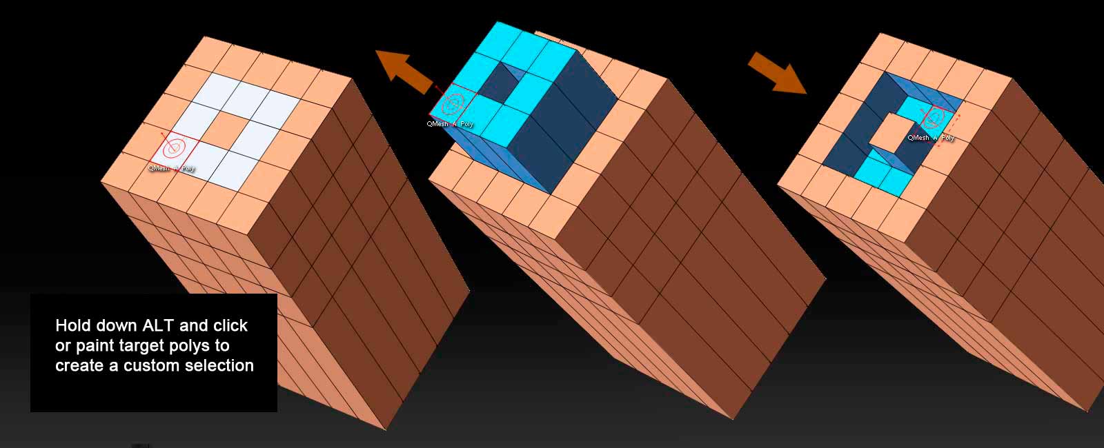

  1. But what if I want to affect more than a single polygon with my QMeshing? If you want a quick custom selection, you can simply hold down ALT with ZMod active, and click or paint a series of polygons which will turn them white. In Single Poly mode, this selection will be affected next instead of the poly you click on:
  1. Likewise, there are a ton of different target selections you can set the tool to, that can produce really interesting effects when used creatively. These are documented elsewhere, and you’ll just have to play around with them a bit to get a feel for which does what. In this example, I’m going to insert another loop of polys with Insert Loop, that will all be the same polygroup. Since they are the only polygroup of that color on the cube, when I set the QMesh Target to “Polygroup All”, it will extrude all the polygons of the same polygroup that you click on. In this case, it’s just that one polygroup, so I get a wrap around extrusion around the base of the cube.

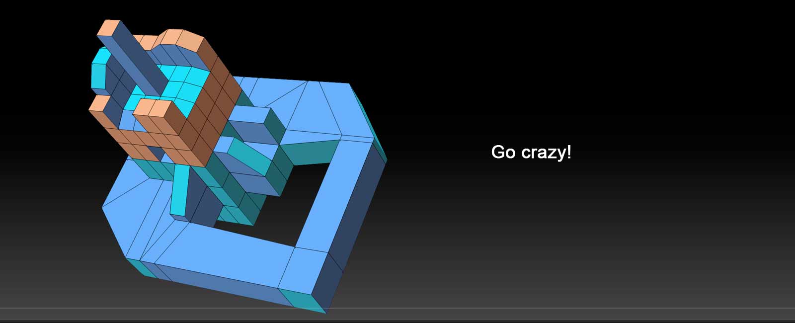

  1. Go crazy pushing and pulling polygons out from, and into each other to make bridge connections. Get a feel for the “snapping” sensitivity which can be adjusted in the QMesh modifiers. Get a feel for if you only drag a polygon out slightly rather than to the full snap, you can create inclines. Have fun!

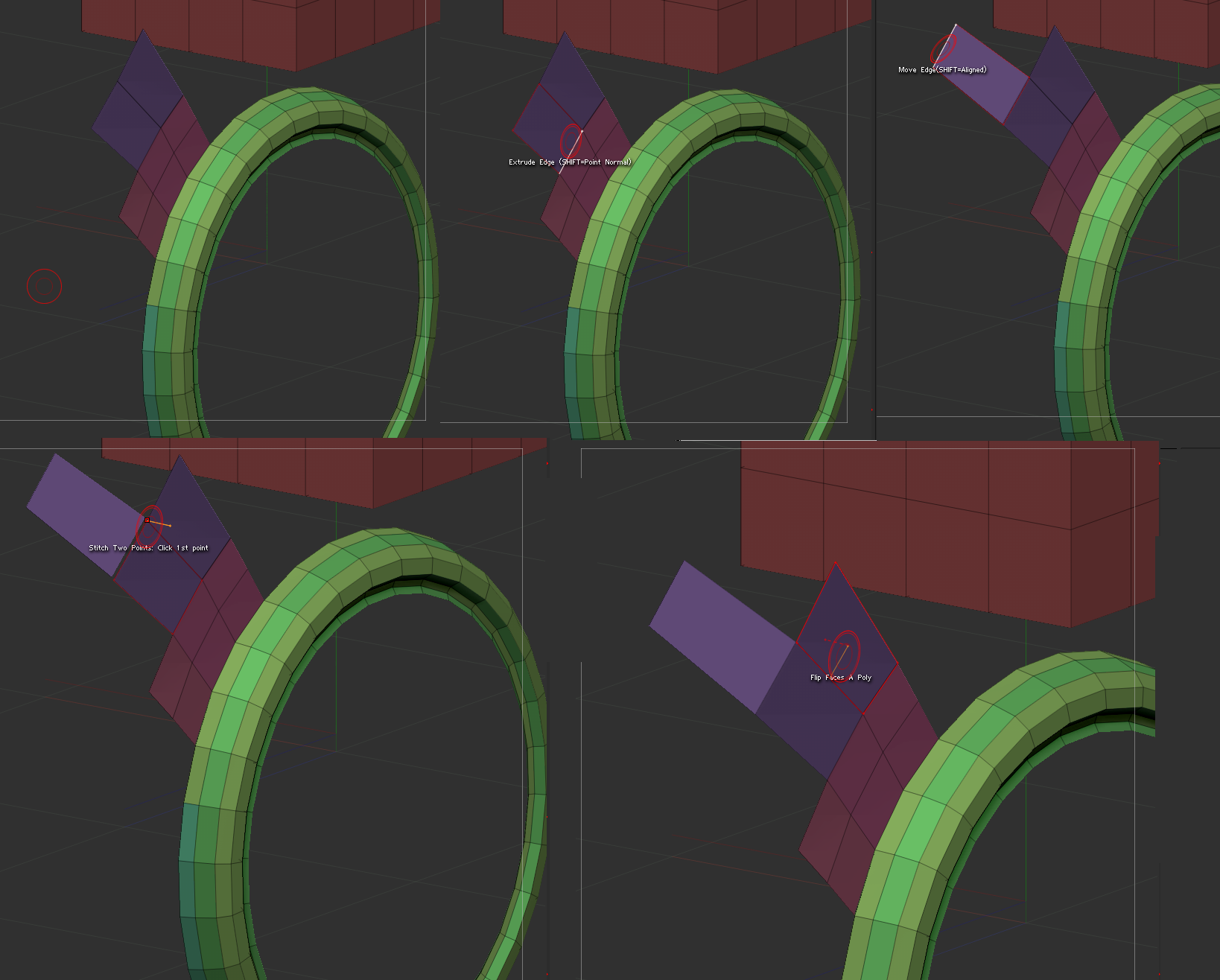

poly by poly is tricky and in this example really cumbersome but still possible.
in edge mode, use the Extrude Edge option -> go to the “inside” pof the edge which you want to extrude, use shift to only extrude a poly ->move it via the Move edge option
in point mode select stitch two points (I set the modifier to Start point) click first and last point.
and that pointmode you have to use at least two times since the extrude edge mode splits the faces.
if the face is hidden, go to polygon actions, use Flip Faces and flip the hidden face.
