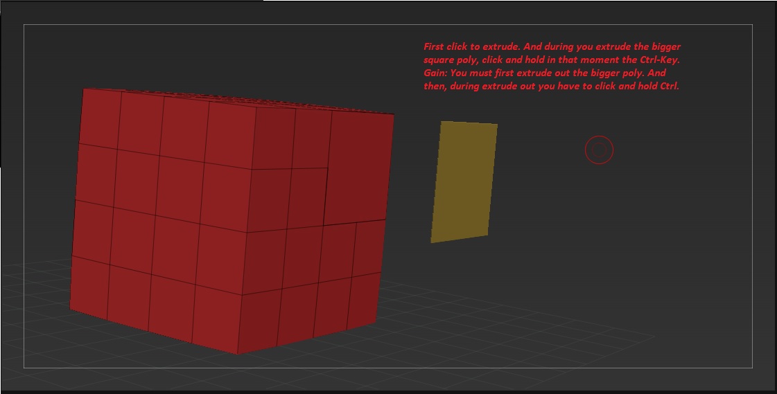

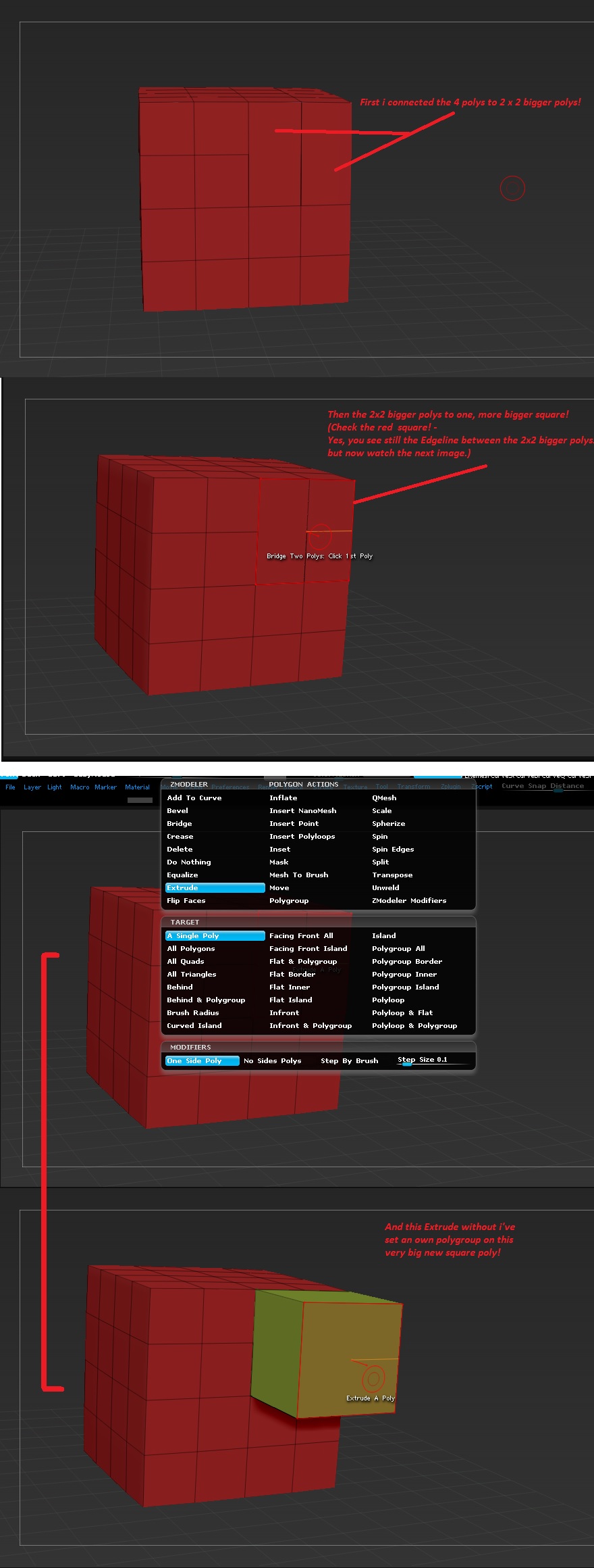

@Spyndel Check:
And now check the other thing hehe Such a big Square-Big-Poly out:
@DesignitLive
Yes, but you’ve still got some awkward stretched geometry at the join there. You’re not really merging any polygons. You’re making an almost invisible bridge of stretched polygons, connecting to a new stretched quad that is overlapping other polygons.
As you say, if you’re going to dynamesh it together, this is no big deal. Dynamesh closes minor gaps and holes. From a modeling standpoint, it will cause problems. Was just letting you know.
Yeah, right. looool
This was more a secret, overdose special thing. Not really useful. lol
But maybe one can use this for receive a very Big Square or some special shapes, produced by the orignal Sculpt/Model with that bridge poly connection and Ctrl+hold Extrude that special shape/square area.
(but first you have to duplicate your original Sculpt/Model on the Subtool list and then split that special shape or big Hero lol square) and delete this duplicated Model then later. hehe
Ok, was a bit a stupid idea. But an idea hehe ;oP :smiley:

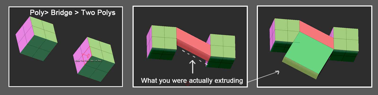

Just to illustrate the point though, in case anyone else new to modeling is wondering, let me show what I’m talking about.
  1. Poly > Bridge > Two Polys is used to designate two unconnected polygons to make a bridge between. If these polygons were aligned and across from each other, you could just QMesh them into each other. If the target polygon is not aligned with the first one, then you might use this function to create a bridge.
Since you were selecting two adjacent, co-planar polygons to be the target, it created a flattened bridge between the two, and that’s what you were extruding from–not a merged polygon. Overlapping co-planar polygons are problematic in modeling, and would cause any number of issues.

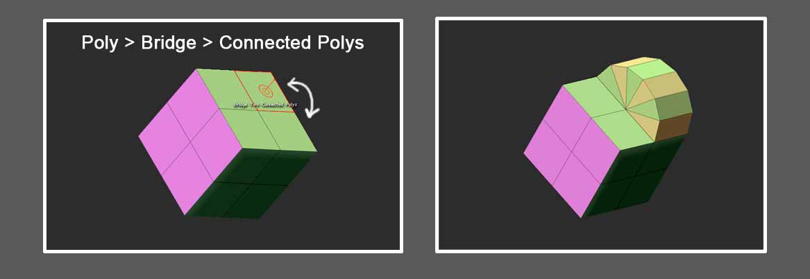

  1. Now the Polygon > Bridge > Connect Polygons action IS designed to be used with two adjacent polygons, and it can be used to create cool looking curved extrusions between the two polygons, by dragging one into the other. Your drag direction will determine the shape of the arc, and the number of segments.

[i]Ok, this is now sure a cool thing. That i believe 100%:
It’s a bit long, but read it! The image is too big, therefore a link (for upload it):
http://fs1.directupload.net/images/150202/rwf7nijb.jpg
[THE MOST IMPORTANT PART ON THIS IS: THAT YOUR WISH-SHAPE MUST BE FINALLY INVISIBLE/HIDDEN, BEFORE YOU SPLIT IT.
BECAUSE ONLY THAT POLYS SAVE THE UNDO-HISTORY WHERE ARE NOT HIDDEN SPLITTED.]
*EDIT
Sorry, was wrong the image. Now is correct.[/i]

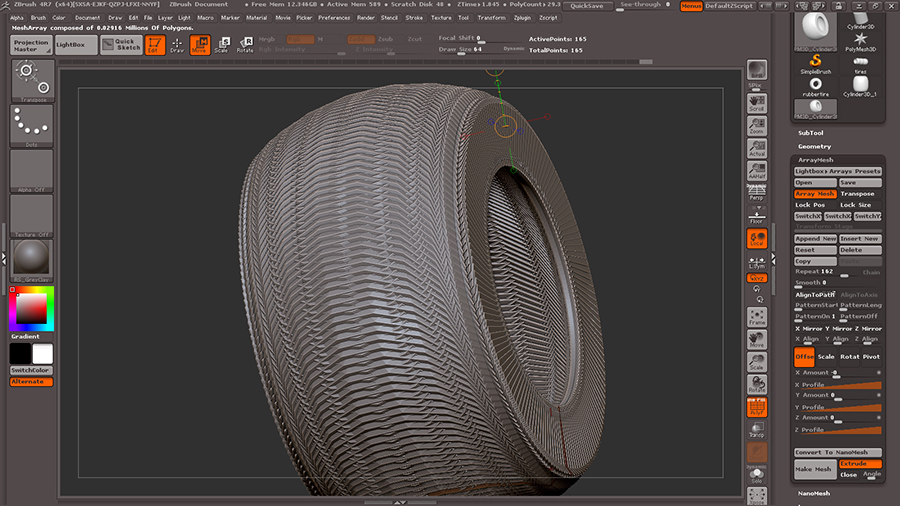

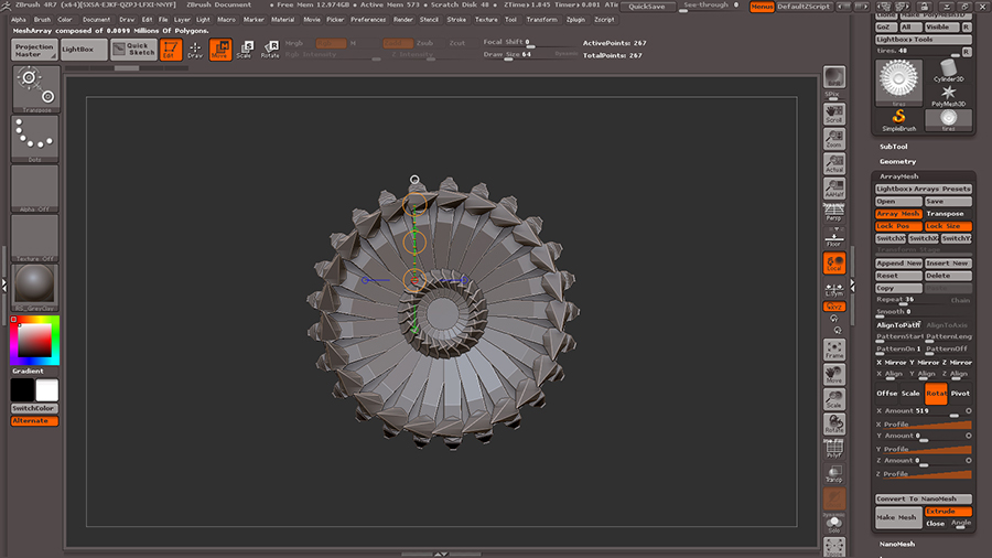

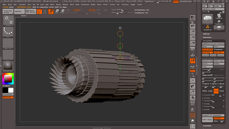

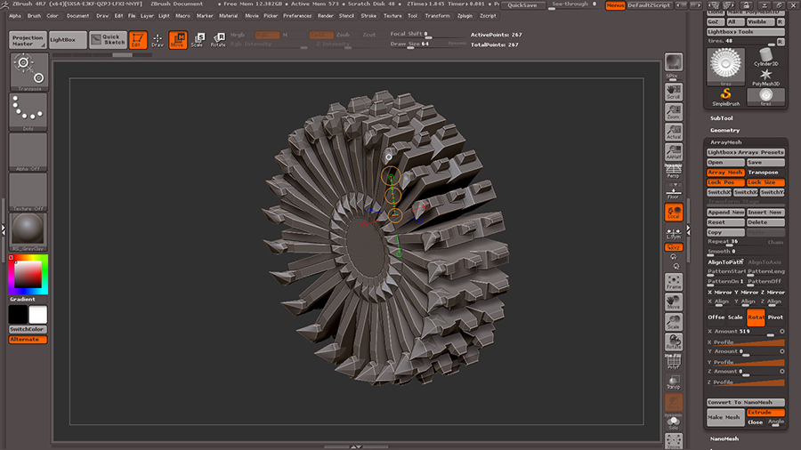

My contribution to this thread is probably very little and very basic to most but I thought I’d share some array and nanomesh things.
After you have created some random object and used a profile from the array presets if you turn off transpose in the array tab you can use the transpose
move line to manipulate the object further.
Some objects that in your head start out as something different after playing with the array mesh presets. I modeled a quick and dirty mudding
tire, mirrored it on the Y axis and pulled it out with the transpose line and applied the array tire prest with a high repeat.
Thus giving me something way different than what I planned, or as I like to refer to it “a happy surprise”.

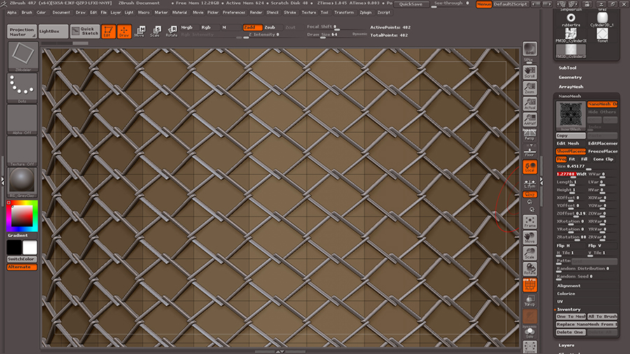

Now something I’m sure many thought when they seen nanomesh previewed, fish net, fence, etc. Here I modeled a quick net piece, made it an array mesh
then converted to nanomesh in array tab. In the nanomesh tab assigned it to the zmodeler brush, then set the polygon order of the brush to “insert nanomesh,
all polygons”. Play around with the rotation and size in the nanomesh tab to get best effect.

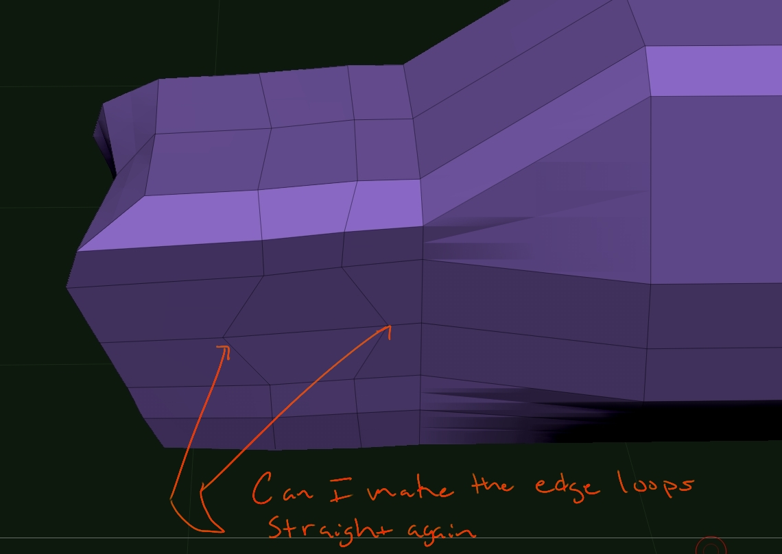

I know I can delete them and bring them back holding shift
One possibility is to delete the Edge Loops and make two new Edges.
es.
just say you don’t know

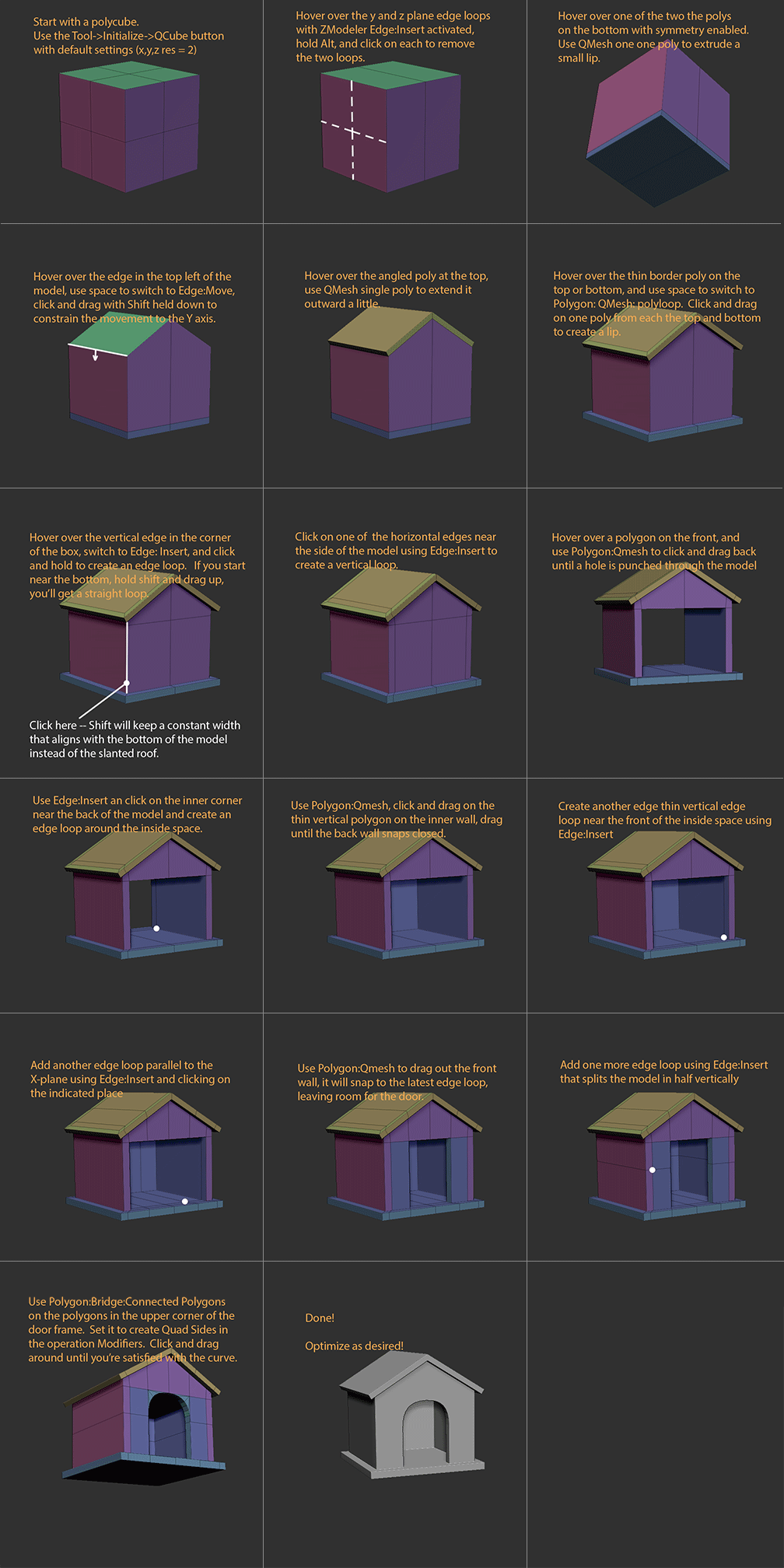

A bit late on this
 I thought showing how to make the doghouse was a great way to show off the basics of ZModeler, so I made a tutorial image myself. Wasn’t able to get it uploaded until today, and I see that Spyndel already put up a great one.
Still, below is how I went about making it
 a little simpler I think. I hope it’s useful to see a slightly different way to go about modeling the same thing. ZModeler is really fantastic
 so much power tucked away in a rather efficient tool. Some rough edges, and some opportunities for workflow improvements, but it definitely seems to have nearly all of the key features I’d ever want to use for low res modeling!

1.) Right click to one Edge > choose: Delete > choose: EdgeLoops Complete. = Then delete your Edge Loop comlete.
2.) Now again right click to once Edge > choose: Insert (RRRRRt! Not inset!) > choose: Single EdgeLoop = create your new, or two new straight EdgeLoop/s.
I said I knew how to do that
