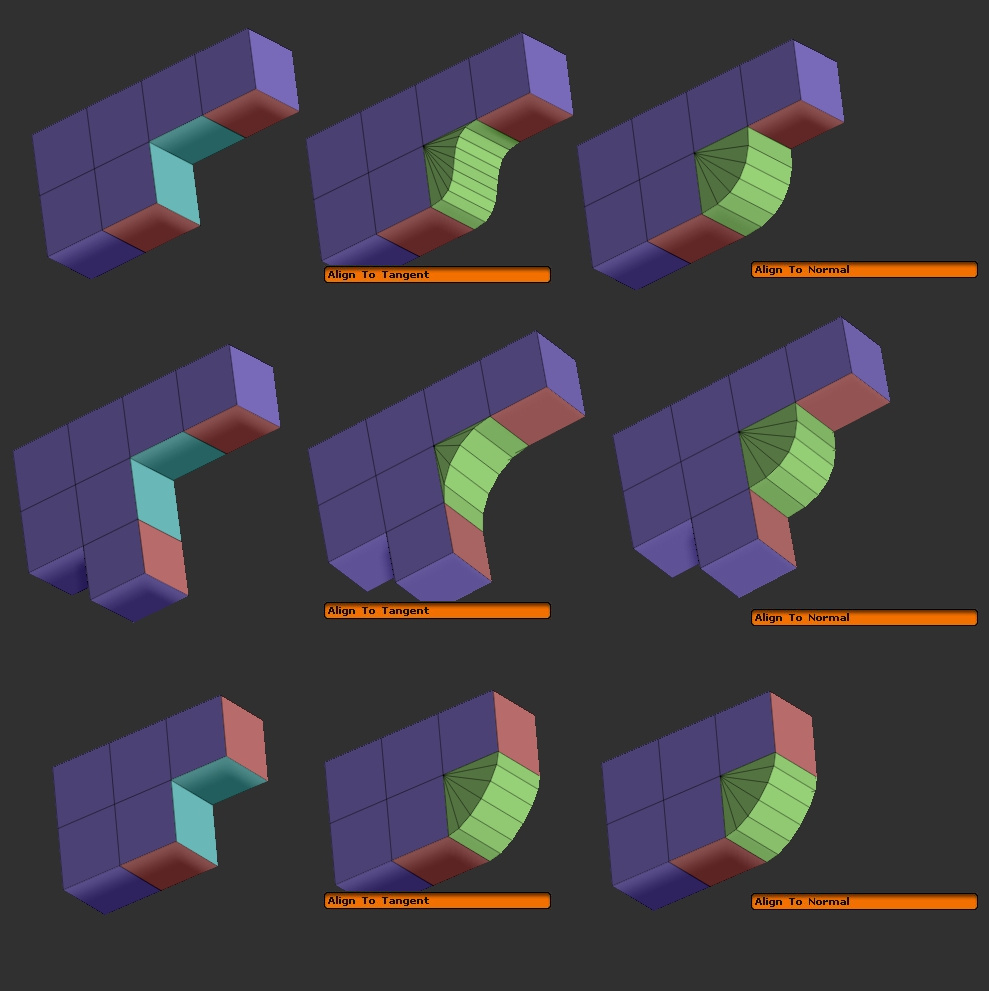

Did you make sure you had poly’s extending beyond the two poly’s you are attempting to bridge? See before and after images below
Hi Daimondo,
If I understand your issue correctly it seems to me that you need to look at neighboring polygons (reddish in my example) especially when choosing the Align To Tangent version of the Poly Bridge Action.
Here’s a comparison of the effects and as you can see the S curve is created when you choose the Align to Tangent option and the neighboring polys (red) are parallel to each other.
All of the below actions are created by moving the cursor outward (that is to the right in this case).
The concave curve in the second row is due to the curve being aligned to tangent of two red polys facing each other at 90 degrees and still dragged outward - to the right (and not aligned to normal dragged inward - to the left - that would give an overlapping geometry as in your later example).
If my explanation is not clear then I hope the image is :smiley:

Wow, very astute! I think you solved my issue. Thanks for taking the time to demonstrate. Perhaps they can add the vital information you’ve provided to their ZBrush Docs for ZModeler. Thanks!

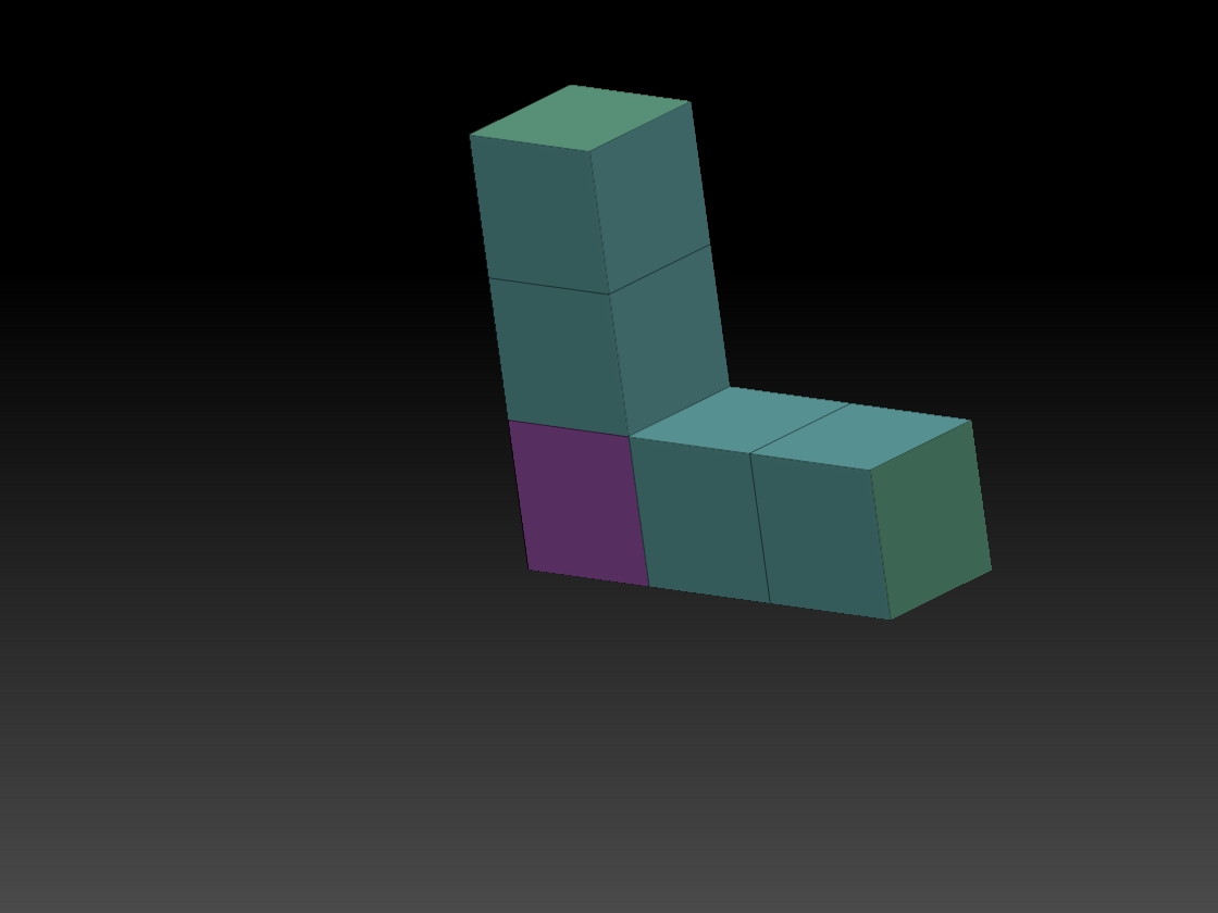

So, every time I try this I seem to get a different result, sometimes the edge goes UP and sometimes the edge goes ALONG. It doesn’t seem to matter which way I drag the cursor, the edge just does what it wants to. If I drag it up real high and then hit shift I would expect the edge to stick to the vertical axis, but nope, it goes along the horizontal one - and vice versa. Once it’s decided which one it’s gonna follow there’s nothing I can do to get it to go along the other axis.
Anyone else seen this happen and what the hell am I doing wrong ?
cheers - Aten.

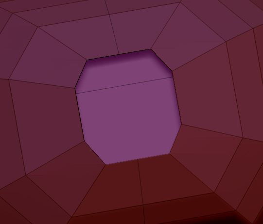

Hello guys, I,m looking for a tool in zmodeler like the spherify in max to extrude a perfect cylinder from this shape, in max I used to select all vertex and apply spherify then I extrude the edges.
Thanks in advance.
Thanks in advance.
Masking everything but the open edges, and doing a clip circle center does the job for me.
Thanks a lot, I always forget to use this function in conection with zmodeler, it´s really a good help together with masking, it works like a charm :wink:

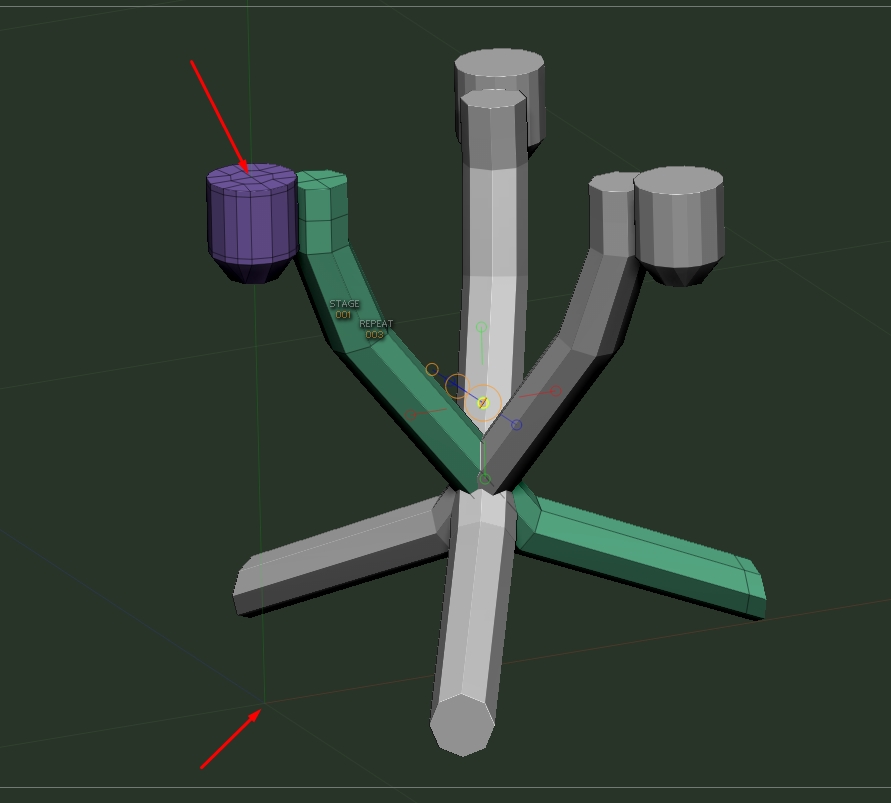

Hello,
two questions about Array mesh and pivot.
It seems to me Array mesh uses the pivot of the bounding box of the subtool for all operations.
Instead I would like to know if:
  1. is it possible to snap the pivot point to mesh points for a better alignment?
  2. or is it possible to reset the pivot point to the <0, 0, 0> of the object even if the subtool will change shape?
    As you can see in the image, I would like to have the pivot in one of the two locations pointed by arrows.
    I mean, I’m creating the legs for this floor lamp and using array mesh to instance the modelled one.
    Is it possible to change the pivot numerically and not guessing with Pivot XYZ section?
Thank you
