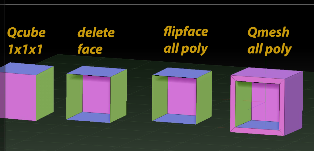

I know that way, I was just hoping that the z modeler could create shells
No worries . Dont think it can mate. IE the ‘one click option’ But it is the first iteration, so who knows what might come for ZB5.
I cant see the point personal, if it can already be done using other ZB Tools. might be a case of design your own UI once you can incorporate the Zmodeler toolset
Good luck
1.-Qcube 1x1x1
2.delete front face
3.flipface all poly
4.Qmesh all poly
IF YOU WANT 1 CLICK MAKE A MACRO!
I would have suggested the same andreseloy. But I think Thebest12, as he stated ‘any magic button - click and it turns into a shell’, which I believe, if you are looking for that “one click option”, is the unify button. Do it at a low resolution and then reactivate Zmodeler. Voila. But it’s not all within Zmodeler as he wanted - soz.

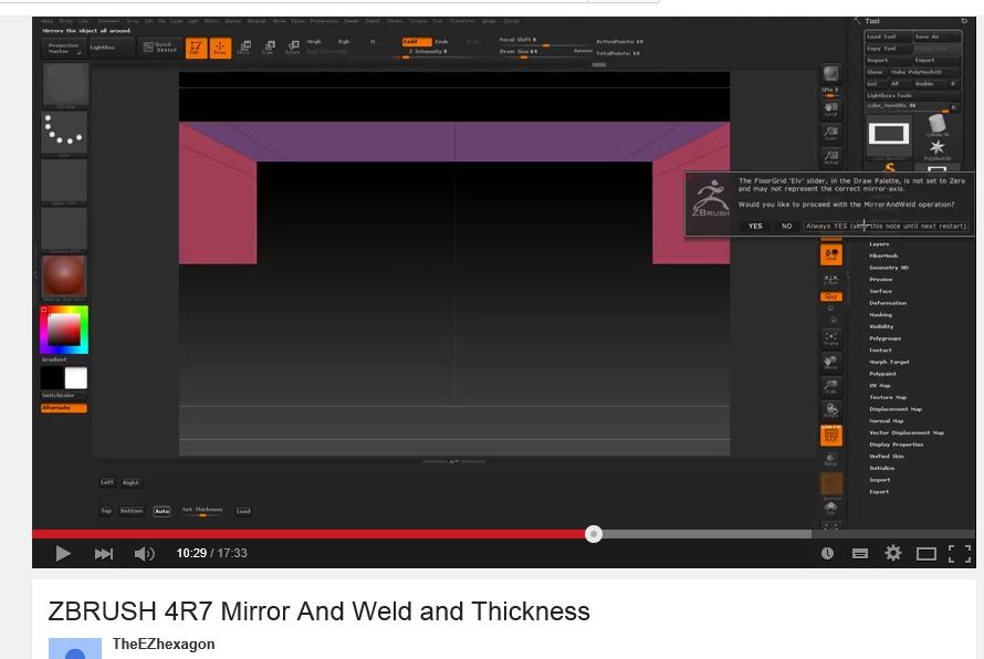

for download:
ZBRUSH 4R7 Mirror And Weld and Thickness
file http://www.ezbrush.<wbr>mediabakers.com/4R7-Mirror-<wbr>And-Weld.zip
video http://youtu.be/1_9vXhpDJiE
new video fromEZHexagon related to ONE-CLICK SHELL
https://www.youtube.com/watch?<wbr>v=OhjNZudg3CI

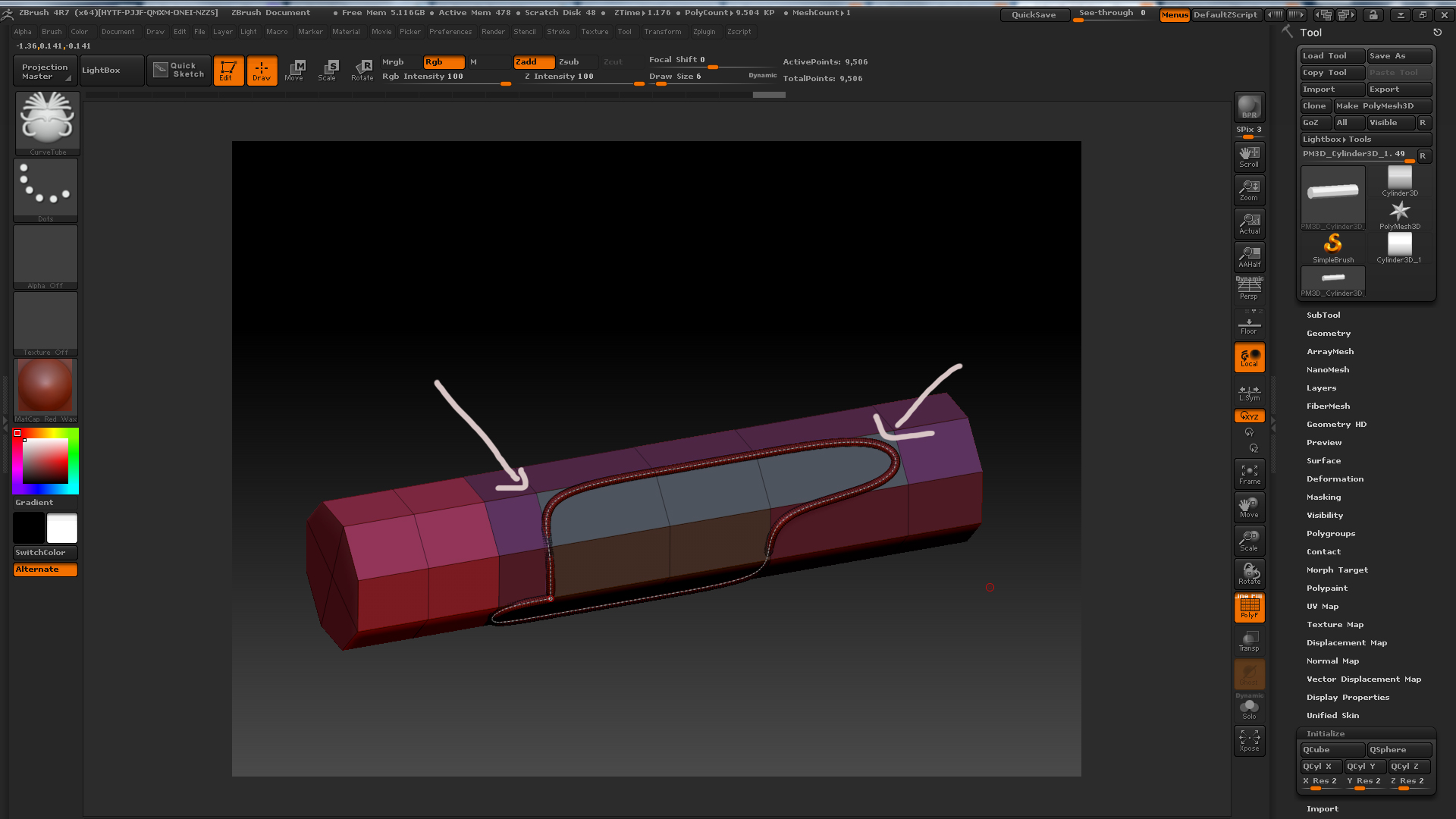

Anyone had trouble getting cylindrical array meshes to weld? Extrude and close options make no difference. Tried both open and closed meshes.
What I’m trying to do: Take a small part of a cylinder, model it to where i want, use array mesh to duplicate it 360 degrees.
Of course, I can just use the weld points button to fix it up, so I guess it’s more of a curiosity than an actual issue. It seems to weld fine for people using it in timelapses and such though. Am I not getting something?
Another one:
I’m also looking for a way to center the pivot to the zero point of the scene, “World Space” as it were? I find myself manually zooming as far as i can bother to, and placing the pivot for each cylindrical array. Gets old pretty quick :stuck_out_tongue:
Deformation Panel>Unify and then in Transform Panel press Set PIvot point
after that with Transpose ON click on the white circle to center the WRE option to the object
Hmm… That centers it to the object, yes, but not to the centre of the scene. I have one part of a cylinder, say 1/4 on one side. I then want this to duplicate in a circular fasion. This means that I then would need the transpose pivot to be in the centre of where the full circle is, not where the current centre of the mesh is. Being able to put the pivot in zero world space would solve this.
