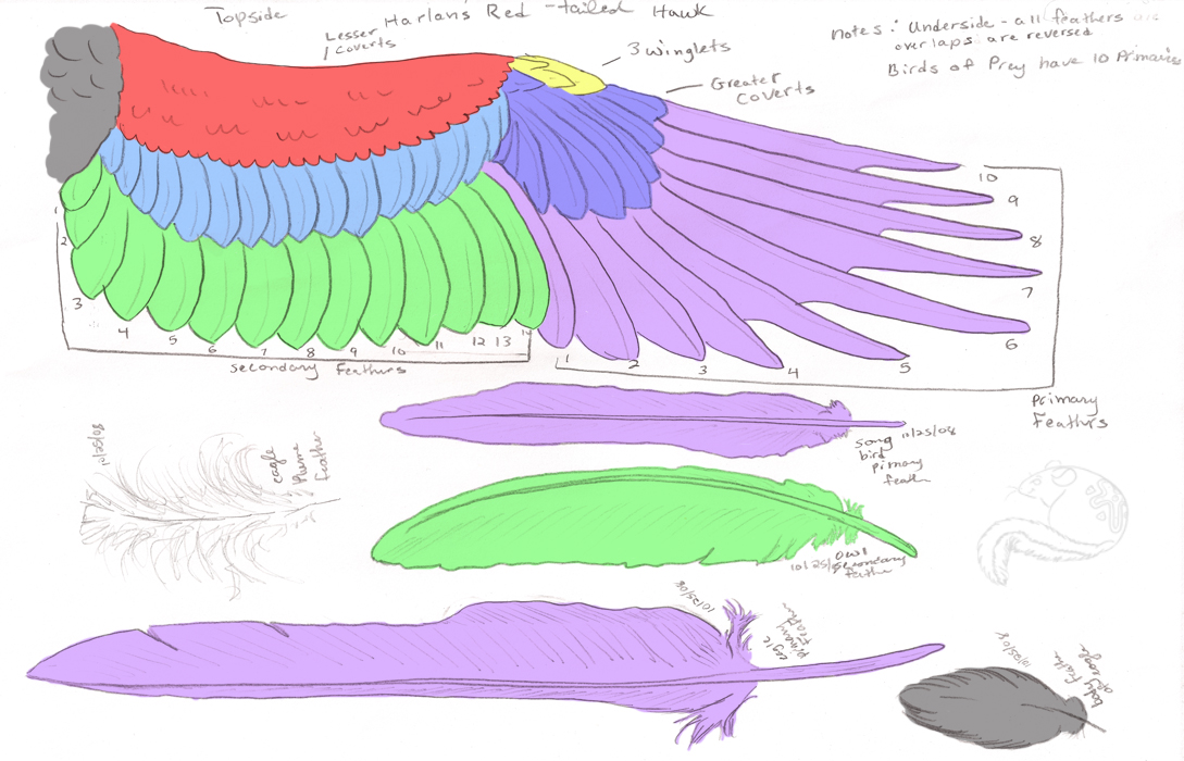

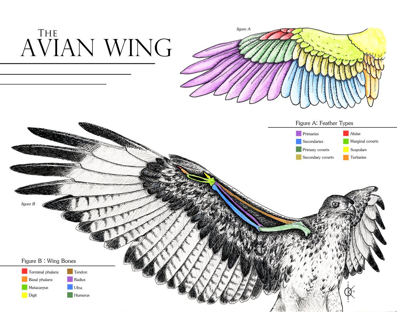

You don’t need a tutorial, you need reference!
just google “wing anatomy” and you’ll get plenty of it.
create a few feathers; then create a proxy mesh for the wing’s “meaty part”; use zmodeler’s “insert NanoMesh” to populate the proxy mesh with the feathers, or you could create a InsertMultiMesh brush with those feathers and then drag them out one by one or in groups, you choose.
21427f3fa10d5f71fafeb3ba85a6174f.jpgbird_anatomy__wing_and_feather_Bird-Wing-Anatomy-example-best-detail-ideas-free-purple-image.jpg
