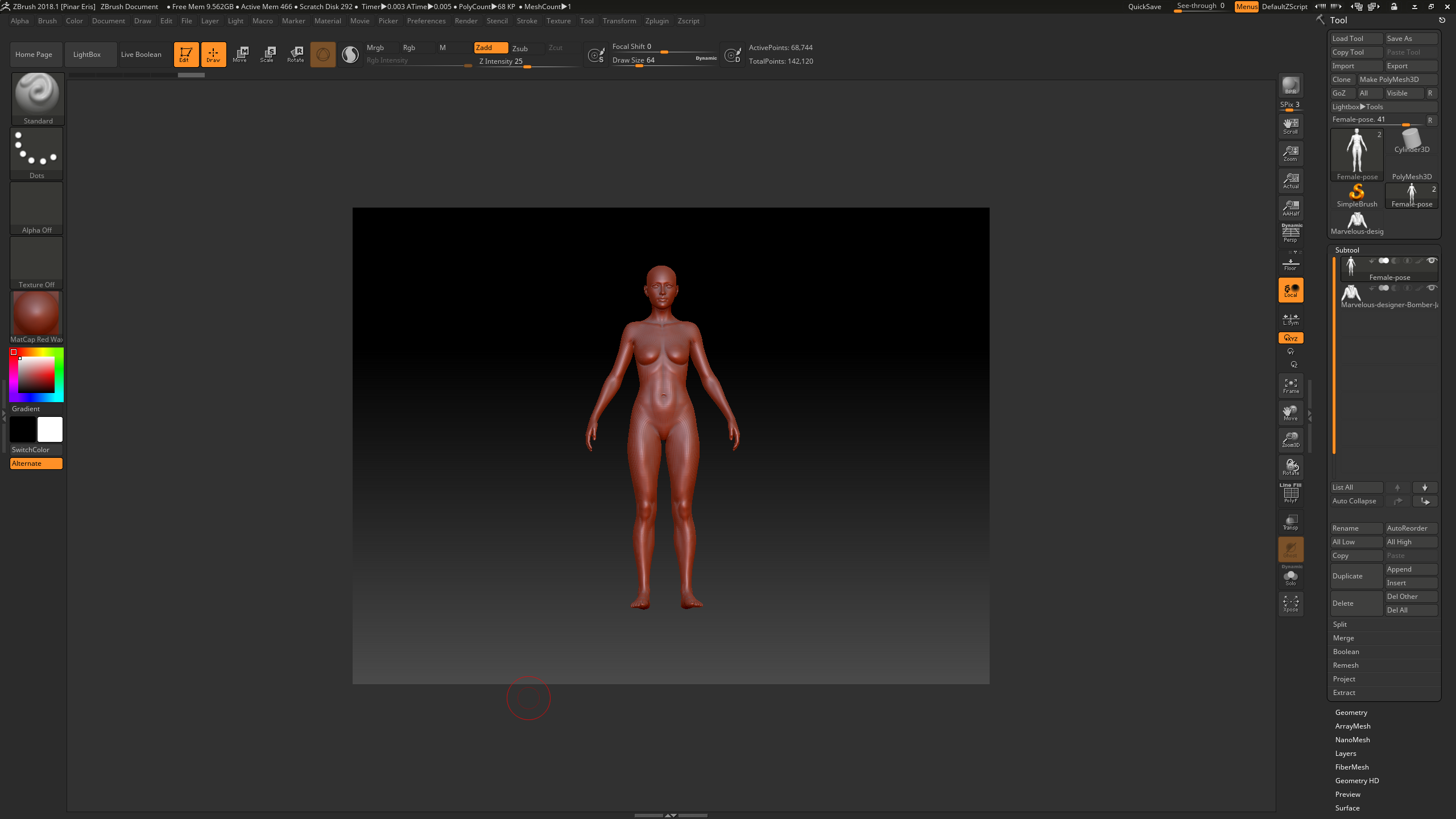

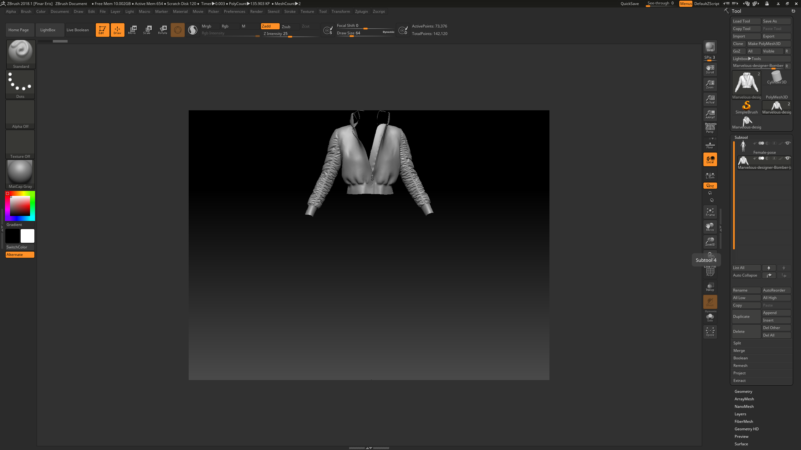

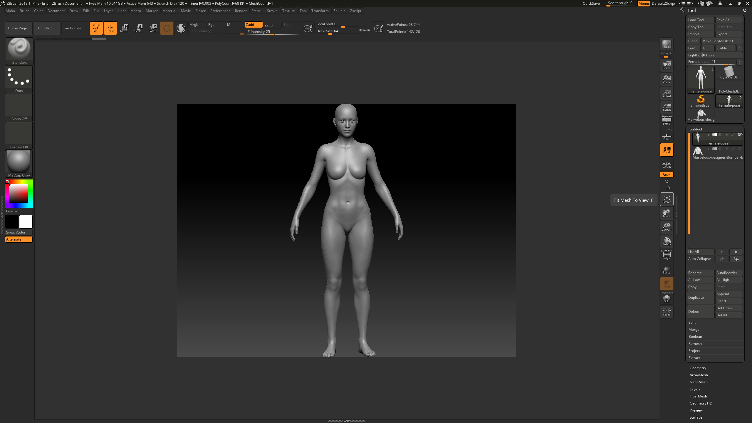

sorry for my many replies… to me looks like the size fine but there is some position issue in relation to each other. You can also see from the screen shots that i attached. jacket looks much higher then the avatar… so how can I fix the positions?
also an add to my previous to reply… I tried press Frame and took screen shots. so this is how it looks for each… may be there is some size issue? but I created the clothing on that avatarScreenshot%20(7) Screenshot%20(8)
