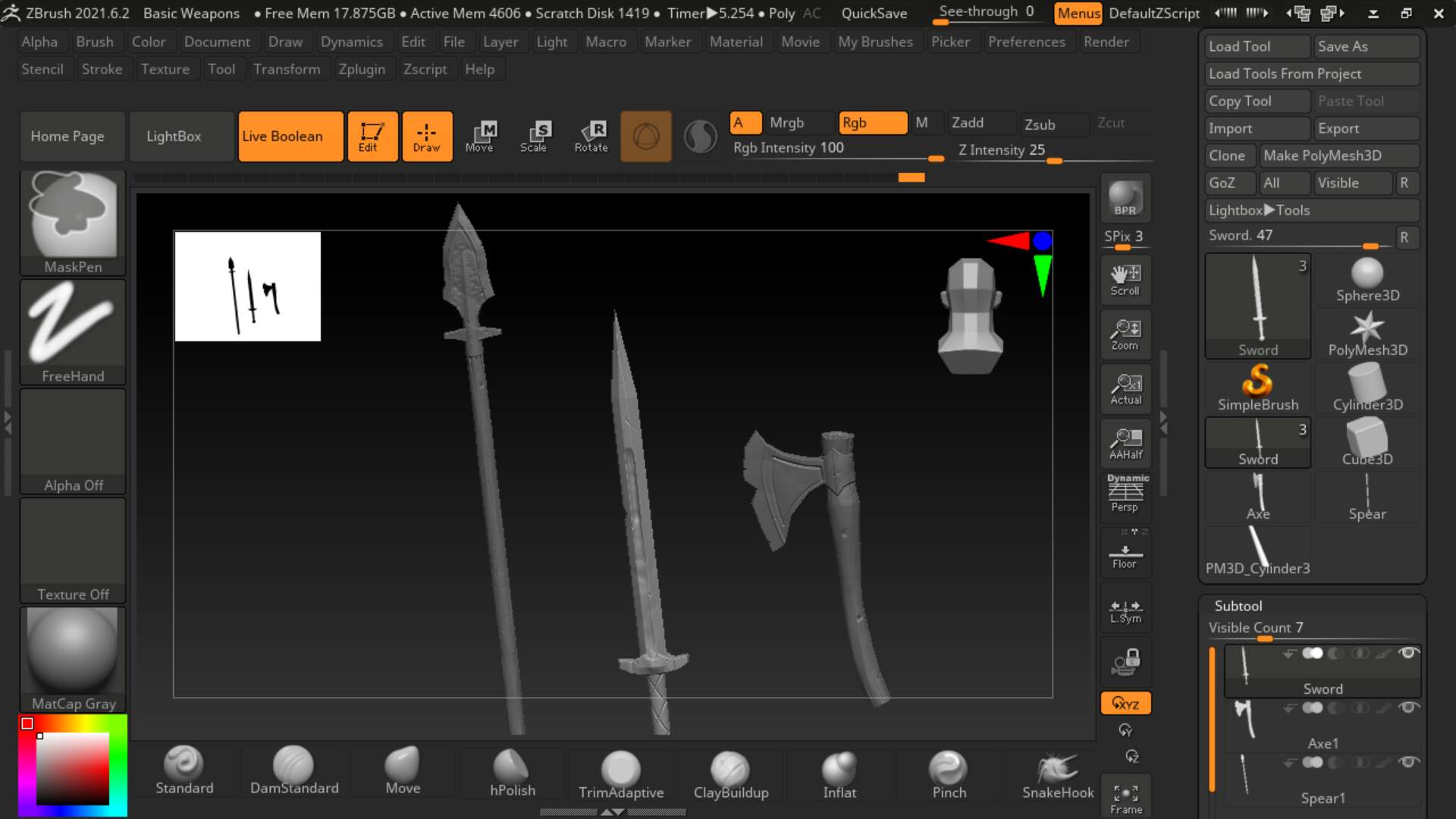

Hey I’m new to zbrush, and i’ve been noticing the visuals of the actual model seem to be pixelated. When looking at tutorials and everything they seem so crisp idk what is going on with mine. It’s not a matter of using the wrong zoom, I’ve hit the Actual and AAhalf buttons and it doesn’t seem to fix it.
I really had no clue what to look up for it, and couldn’t find anything within preferences that seemed like it would be the solution. Its not a huge issue its just kind of annoying.
Is it just the program? Am I doing something wrong? Any help would be really appreciated.
Picture for reference.
Zbrush pixel bois

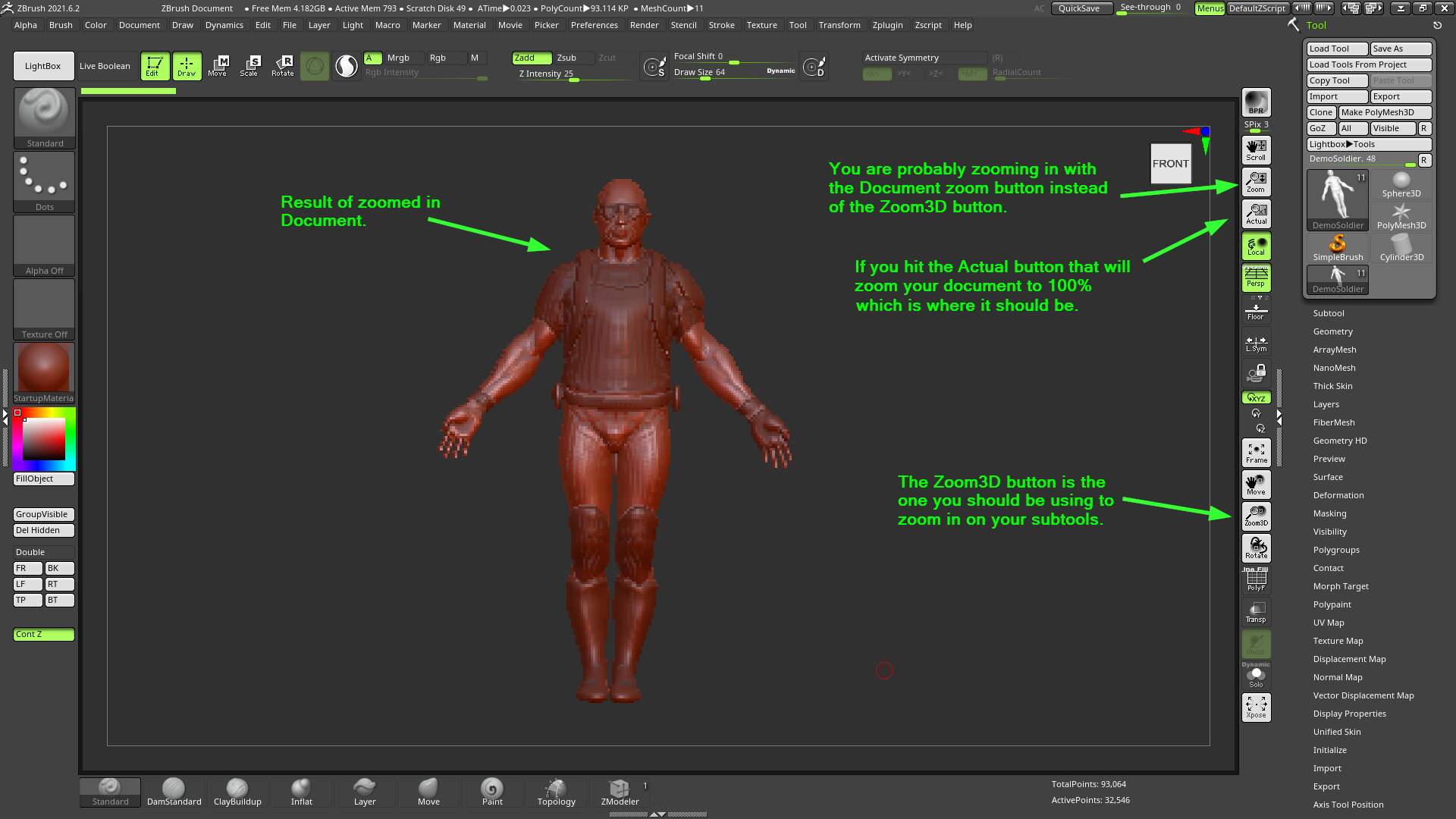

Looks like you might be zoomed in on the document instead of the subtools (see image). You are missing a lot of buttons on the right and left shelves because the screen resolution you are using is cutting them off on the bottom (see image). See my post here on how to move the shelves so you can access all the buttons. Your missing buttons are also in the Transform palette/menu.
After you click the Actual button, you should turn Edit off then clear the canvas (Ctrl+N), redraw the tool on the canvas, turn Edit back on then use the Zoom3D button to zoom in on the subtools.
