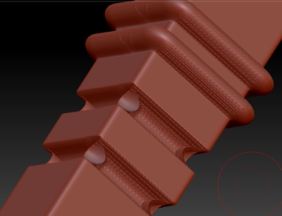

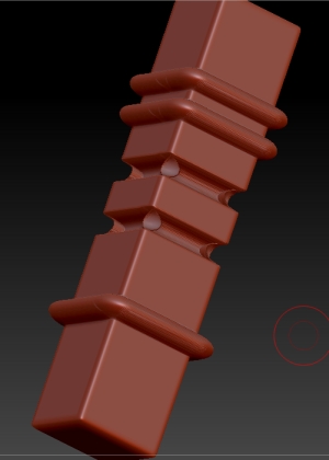

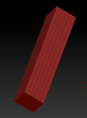

I did exactly what 3djock and nickz said but the final tool has very ugly geometry.
Still no luck.

ZBrush4R6_p2 win7X64 Intel i7 6gbRAM nvidia gforce 250s.
Anyone else with the same problem or a solution.
