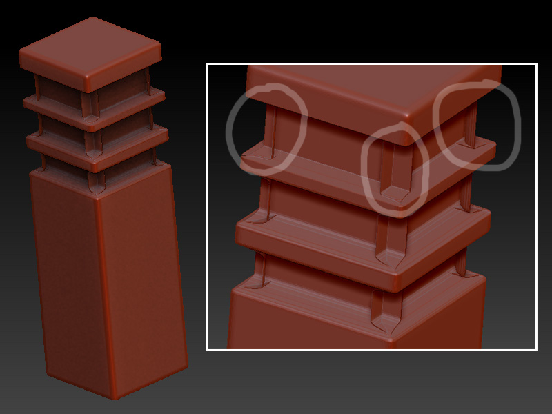

hi,
i have some problem with Zsub, some strange polys.here is my pic

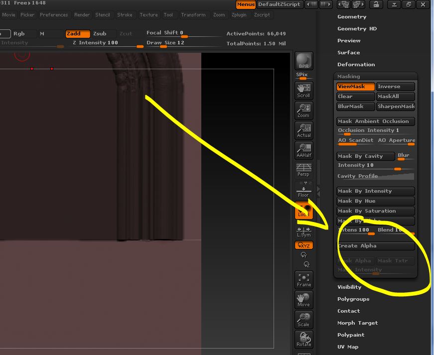

when I get to the part where you click ā€œHidePTā€ the button isnt even there. I’ve got zBrush 4, can anyone help me?! :frowning: :frowning:
HidePt and ShowPt have been moved to the Visibility Palette. (Right below the Masking Palette in the options for your tool.)
Peace-NickZ. :slight_smile:

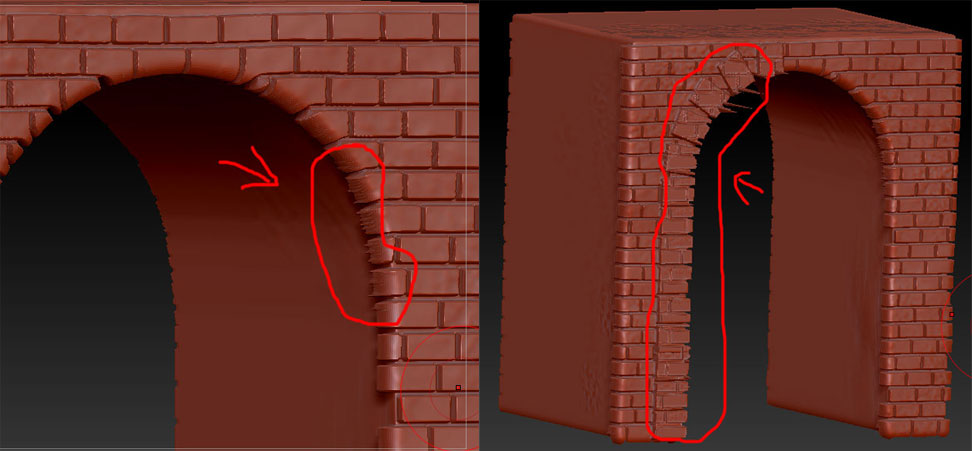

I got some problem, not sure why … Can anybody help me fix those ?
  1. while using projection, at the edge there is some problem(left image).
  2. I tried to project like another bigger block on top of the current brick but it seems, also the below part is seen and again same problem in the edges.(right image)
  3. how to project something in arc uniformly, need to place them manually or some brush stroke is there? like in the ā€œgod of warā€ sample

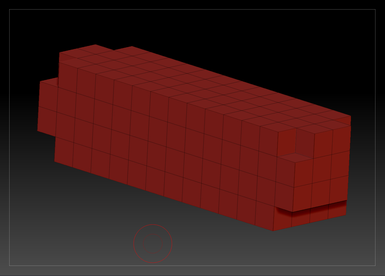

Hello guys, I’m kind of new so i apologies for this. I’m using version 4 and trying to follow the tutorial, but when it comes to the part of applying Unified Skin at the very beginning, the shape of the Skin_Cube3d resultant is not like the one in the video… i have read that the options in the Unified Skin menu changed… for example, you cannot go down to Resolution 8 like in the video… and if i leave it to 16… etc… so, is there’s a way to following the tutorial with new versions?
This is the error i get… i would appreciate any suggestions… thanks! :slight_smile:
Here is what you need to do to make it the same if you have the latest version, Unified skin> Resolution 32> smooth 0> Geometry> Divide 1 with smt off > divide to 7 with smt on and that will get you the same results as the video. That is the only way I could find… Cheers :wink:

Same issue here, it clips some parts of the geo
