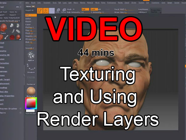

VIDEO - Render Layers and Texturing
[[video-splash.jpg]](javascript:zb_insimg(‘63740’,‘video-splash.jpg’,1,0))
Part 1 20 mins (texturing the head by hand)
Part 2 22mins (using render layers)
[i]Quicktime required (files are zipped as winrar files to save space)
Veoh Links
Part 1 on Veoh
Part 2 on Veoh
[/i]
Topics covered:
[i]Speed texturing by hand without photo reference
Rendering out lay passes
Compositing and adjusting layer passes in photoshop
Use of cavity masking as a texturing tool[/i]
This video runs 42 mins in total and covers the process from texturing to final render using render passes and compostiing them in photoshop. My intention with these two videos was to outline the main concepts in an easy to understand way.
Enjoy
Wayne…
