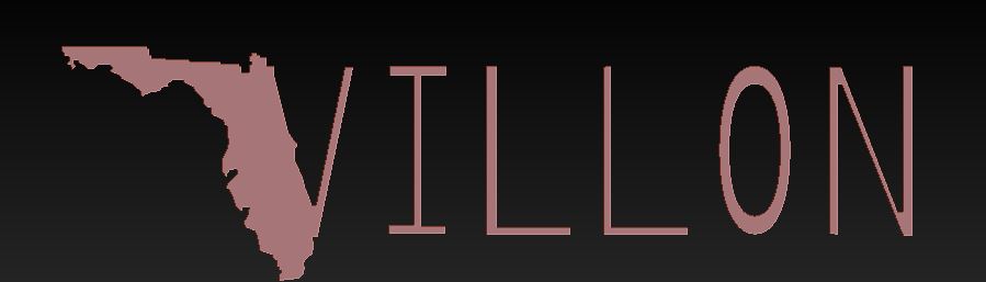

Hi everyone. I’m pretty new to Zbrush and Inskscape. I have started using it so I can create objects that I turn into 3d objects in Zbrush but I think I may have drawn the path for my letter “O” incorrectly? But since I see no path problems, is there a problem with Zbrush creating 3d objects from vectors if the paths are narrow like my letter “O” here?
Is it likely Zbrush not liking the narrow path of the “O” or is it likely I didn’t create the paths corrects in the vector?
thanks for any help.messed up o path outline mode

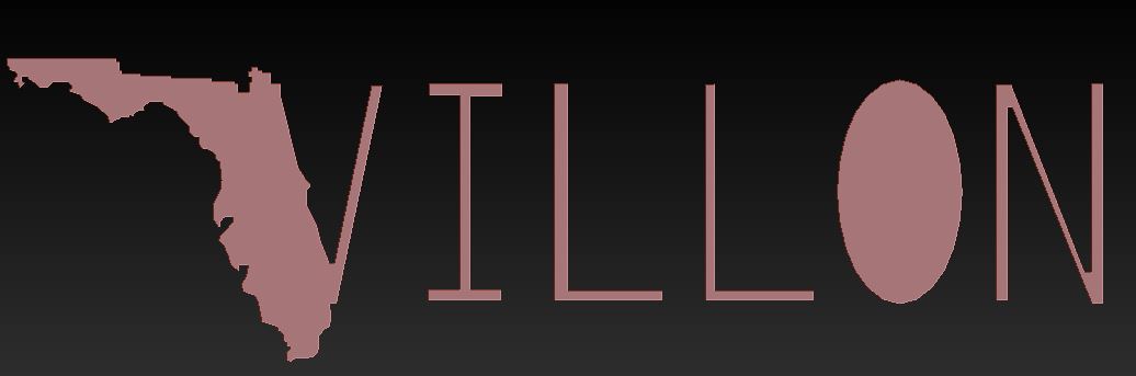

The Outer curve of the letter “O” is the only thing being considered… You’d have to define the inner curve of the O to cut it out… Does that make sense?
Inner Path and Outer path of the curve “O”
I’ve not had to use this in Zbrush but this is exactly what’s happening
Yes, you were correct. I didn’t have the correct “paths” in the original vector. It was my fault, not Zbrush.
Apparently, the paths can be reversed but they don’t appear obvious. So I made the text first in inscape with text tool, then convert to object/paths, then the nodes and paths were correct.
