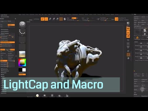

Hey I’ve found this script on a Michael Pavlovich’s tutorial:
Here is the tutorial:
Here is the script:
Hope it helps !
