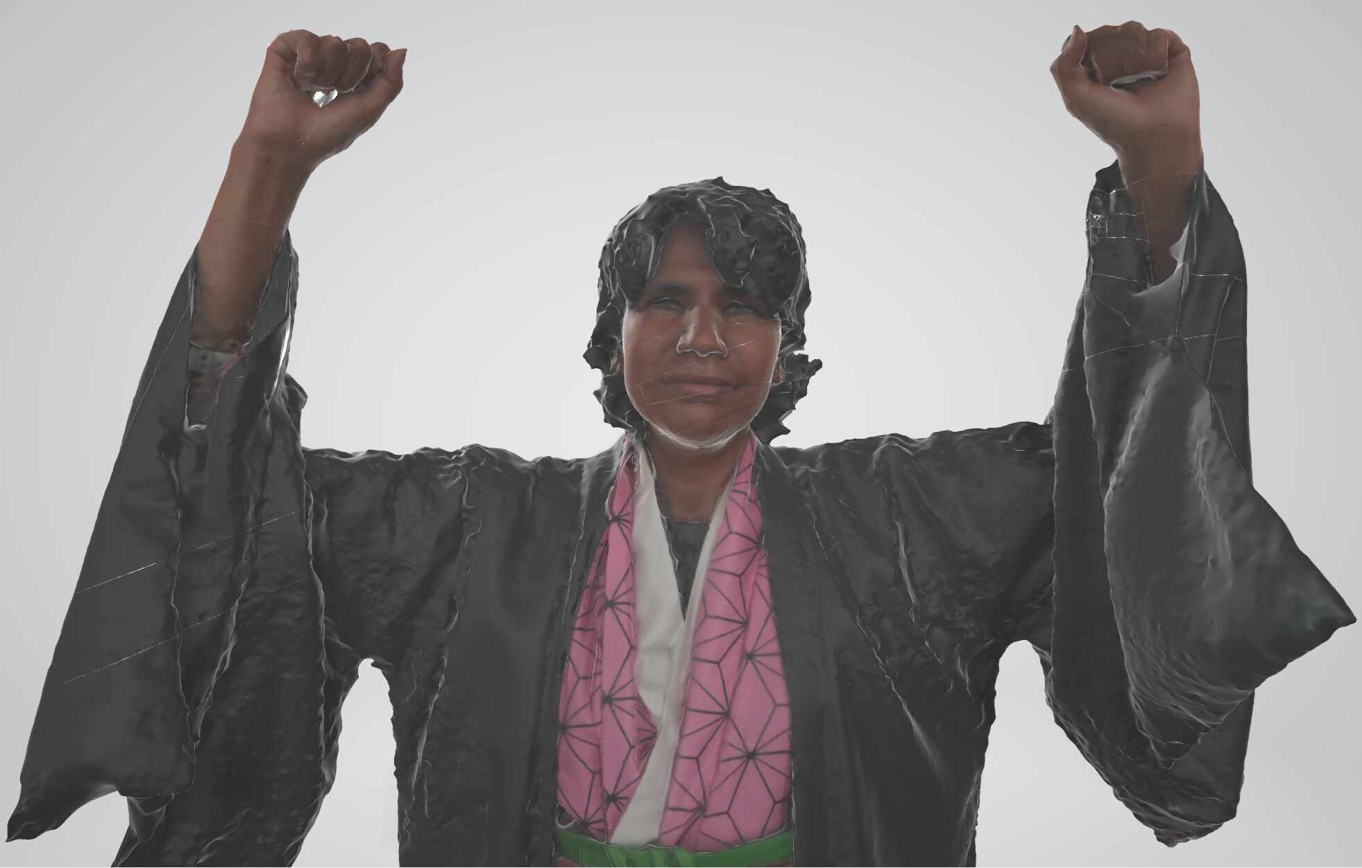

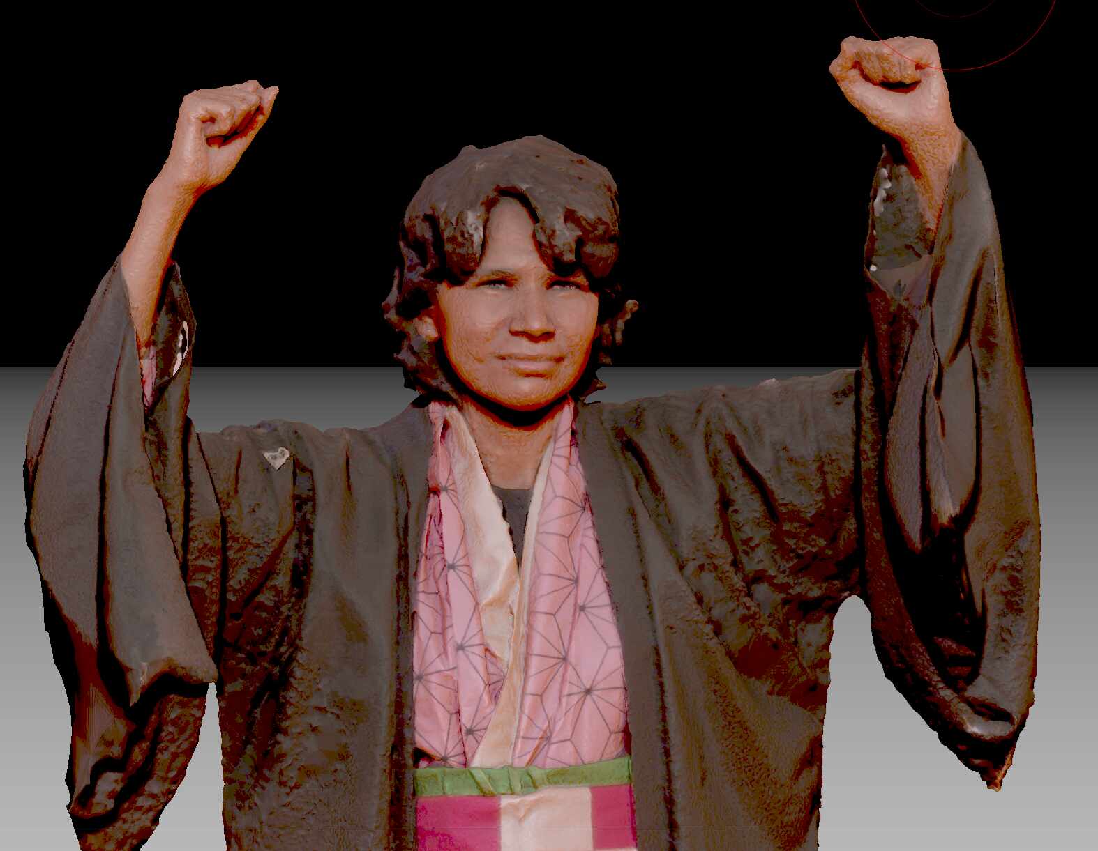

Here’s an example where I used Split and Merge quite heavily to track down exactly where the mesh had errors (as identified by Geometry > MeshIntegrity). The model looks okay at full resolution in ZBrush:
But, after decimating it, every place I used Split and Merge becomes very visible:
