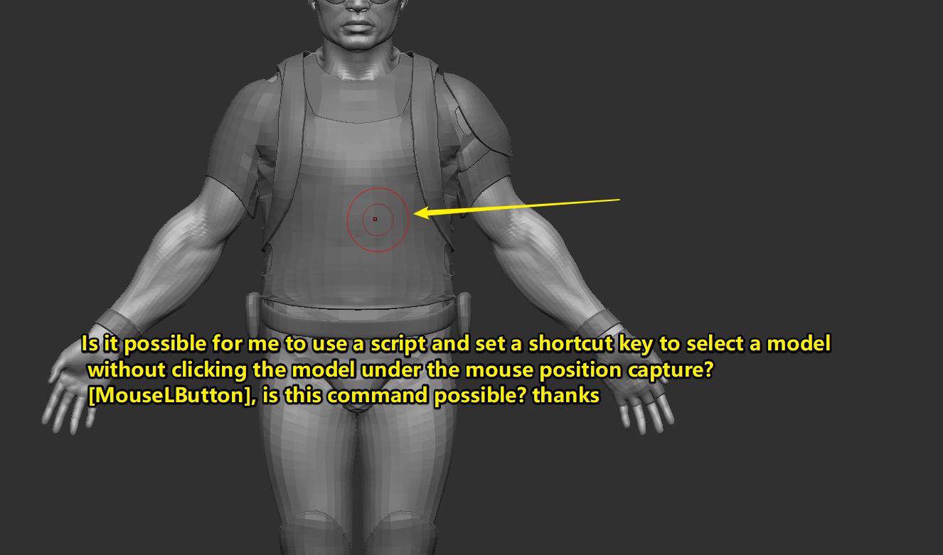

Under the mouse position capture, use the script to select the model?
Is it possible for me to use a script and set a shortcut key to select a model without clicking the model under the mouse position capture? [MouseLButton], is this command possible? thanksSnipaste_2021-12-07_16-08-04
