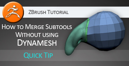

Quick tip tutorial on how to use insert brushes to merge subtools without using Dynamesh.
Check it out, share, like, subscribe.

Nice!
That made me look through the user-guide again which explains the caveats:
http://docs.pixologic.com/user-guide/3d-modeling/topology/replacing-parts/
Is there an actual button in a certain menu that does the welding operation without using the ctrl+click and drag approach? I didn’t see any reference to it in the user guide posted by Cross. I’m just wondering out of curiosity to become more familiar with the UI.
Great tutorial it was really focused on the subject. There’s a video on it in the classroom but you sort of honed in more specifically like a bite size chunk. Thanks!
