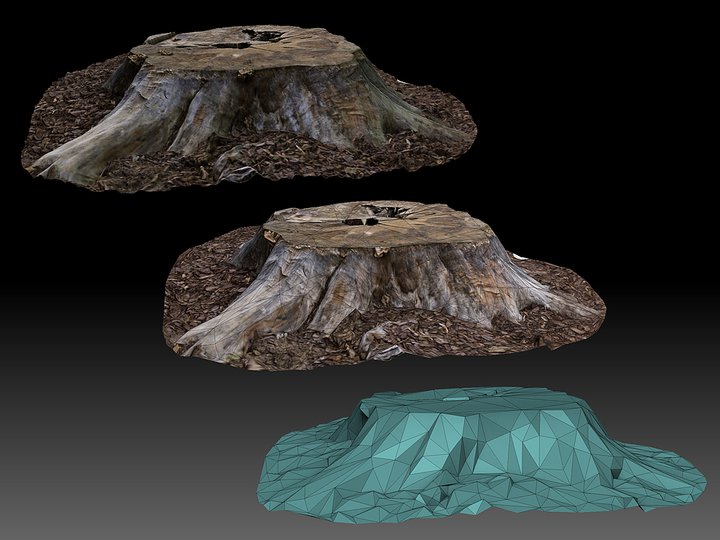

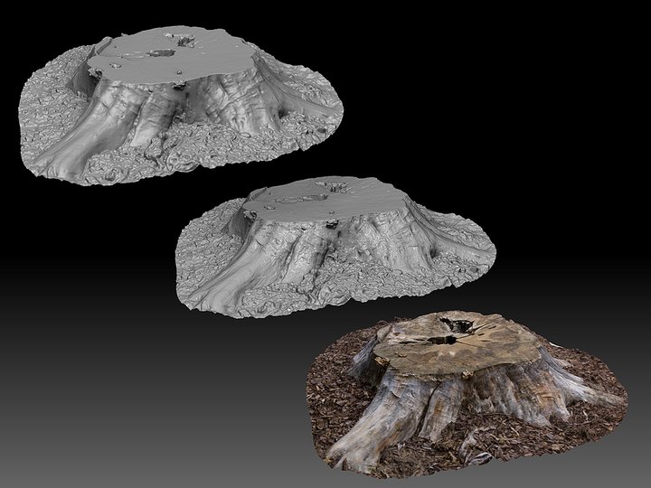

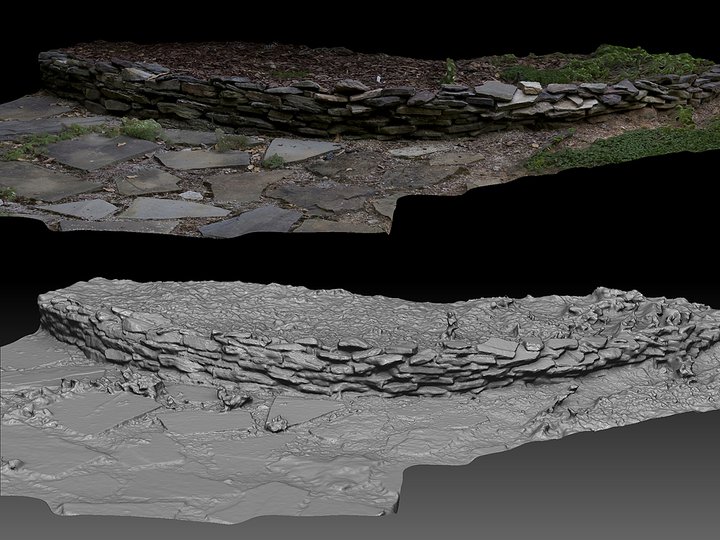

Wanted to share a quick pipeline process I found recently using Zbrush and Autodesk’s Photofly. Using a digital camera, Zbrush and Photofly you can create quick highly detailed game geometry extreamly fast. The first images show some of the test examples I have created. The youtube links are to the HD versions of the tutorial Videos.

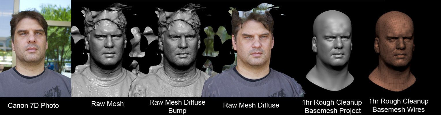

@Grfx: The stump took longer to capture then the face. The face was captured in the shade so that the lighting was even. Then I just rotated around the subject exactly like the stump and took 11 pictures (tests I have done are never exact in the amount of pictures. For a head it’s turned out to be 11-12 photos, it all depends on how many steps I take around the subject.)
After it is captured you should get a mesh that is decent (first raw model in the image) and a excellent diffuse texture. Applying the diffuse as a bump will help increase the quality of the raw model (I have been quickly dumping the diffuse to photoshop equalizing the channels then seperating the blue channel to use as a bump.) The rest of the process was just quick Zbrush sorcery using masking, retopology, projections, and simple sculpting. Creating a tutorial to cover the head process I use is on my list of to do’s.

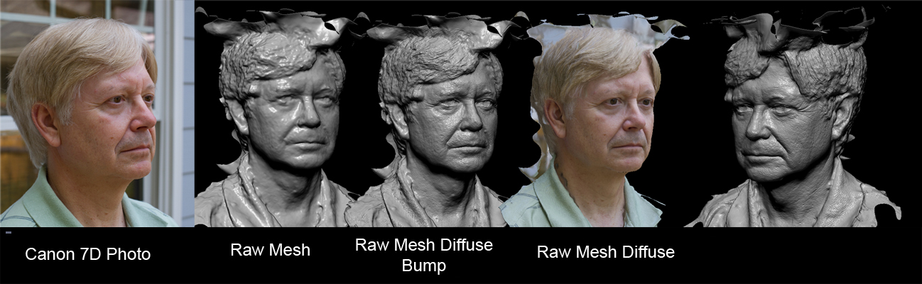

Another quick example of a head 12 pictures with a Canon 7D were used. (just the raw data from photofly)
