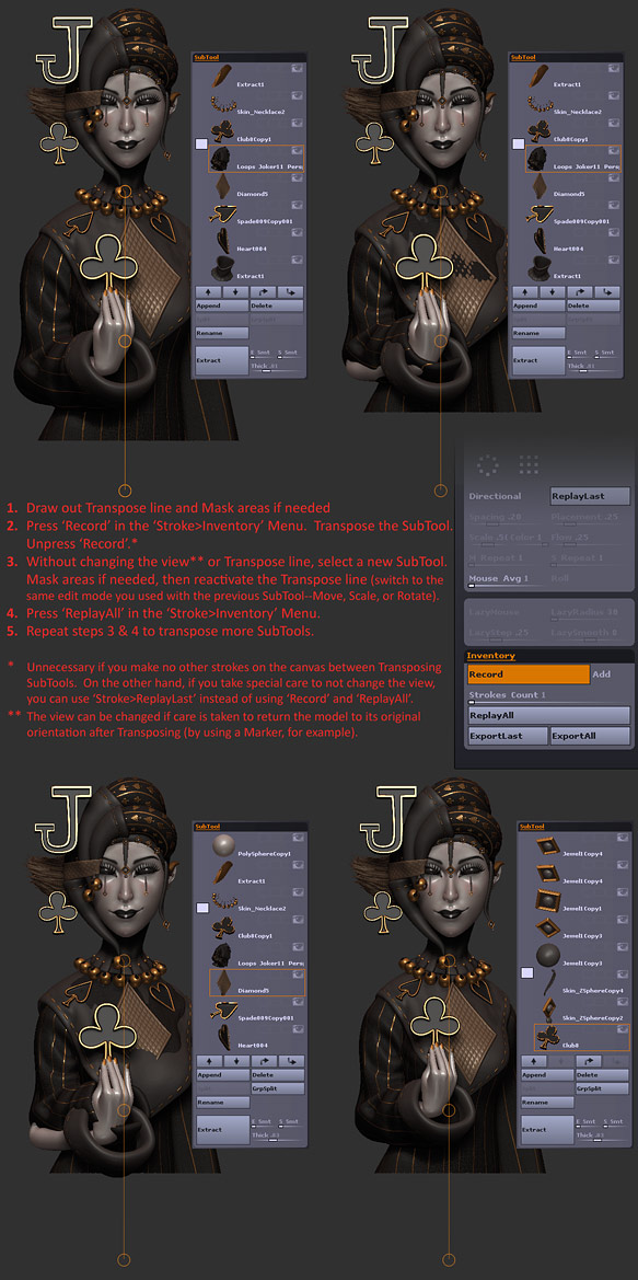

Not sure if a better way has been found for this but here’s a little method I use to transpose multiple SubTools, without having to merge them:
I originally posted this over in this thread: http://www.pixolator.com/zbc/showthread.php?p=376315#post376315
Thought it might be of more use in this forum though. :slight_smile:

what I like most about this method, as opposed to merging subtools, is that it is quicker and you don’t lose your subdivision levels on the subtools. Yes, I know there is a plugin that combines the tools for you, and kudos to the person who wrote that plugin. It is certainly quicker than cloning and combining the tools yourself, but with this method there is no need for that.
Thanks again, Marsyas!!! I just knew someone would figure out an alternative. Granted, this method requires that the strokes are recorded and nothing different is done in between, but I think for most purposes it will work out fine.

Someone asked for a movie demonstrating this method so I made a simple zscript showing some transposing with the demosoldier (I’m not familiar with the movie stuff right now).
I think you have to expand the bottom tray to see the ‘play’ button after you load the script.
