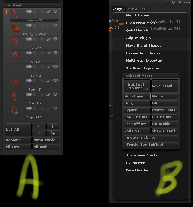

The below tips basically means select the top subtool (see fig ‘A’) selected before entering the tranpose plugin. Also have all subtools named differently. If the below fails try multi appending your ZTL file into a new project from the subtool plugin (see fig ‘B’).
