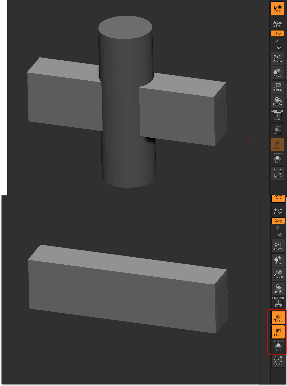

Hi, I have a issue since I use Zbrush 2020. As soon as I activate ghost mode, it seems to activate solo mode instead. I can’t view other subtool. They are not hidden.
Has anyone seen this and found a solution ?
Thanks

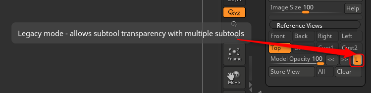

Found the solution, there is a button that I never saw before in image plane feature. It has to be activated
Thanks to the guy who commented my post then deleted his comment, he shows me the way !
Cheers !
