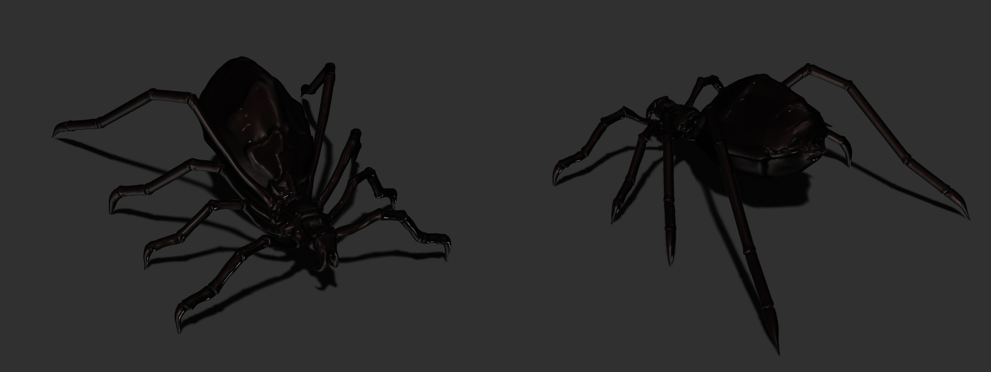

Hi all, just thought I would post this neat trick for transferring details from one mesh to another using layers.
The issue was that I had saved first after creating zsphere model and once again after posing the model. But I hadnt posed on a separate layer. So I took the early mesh and dumped it on the new mesh…watch and see.
I hope this is of help to you all!
These are the two posed and unposed…
