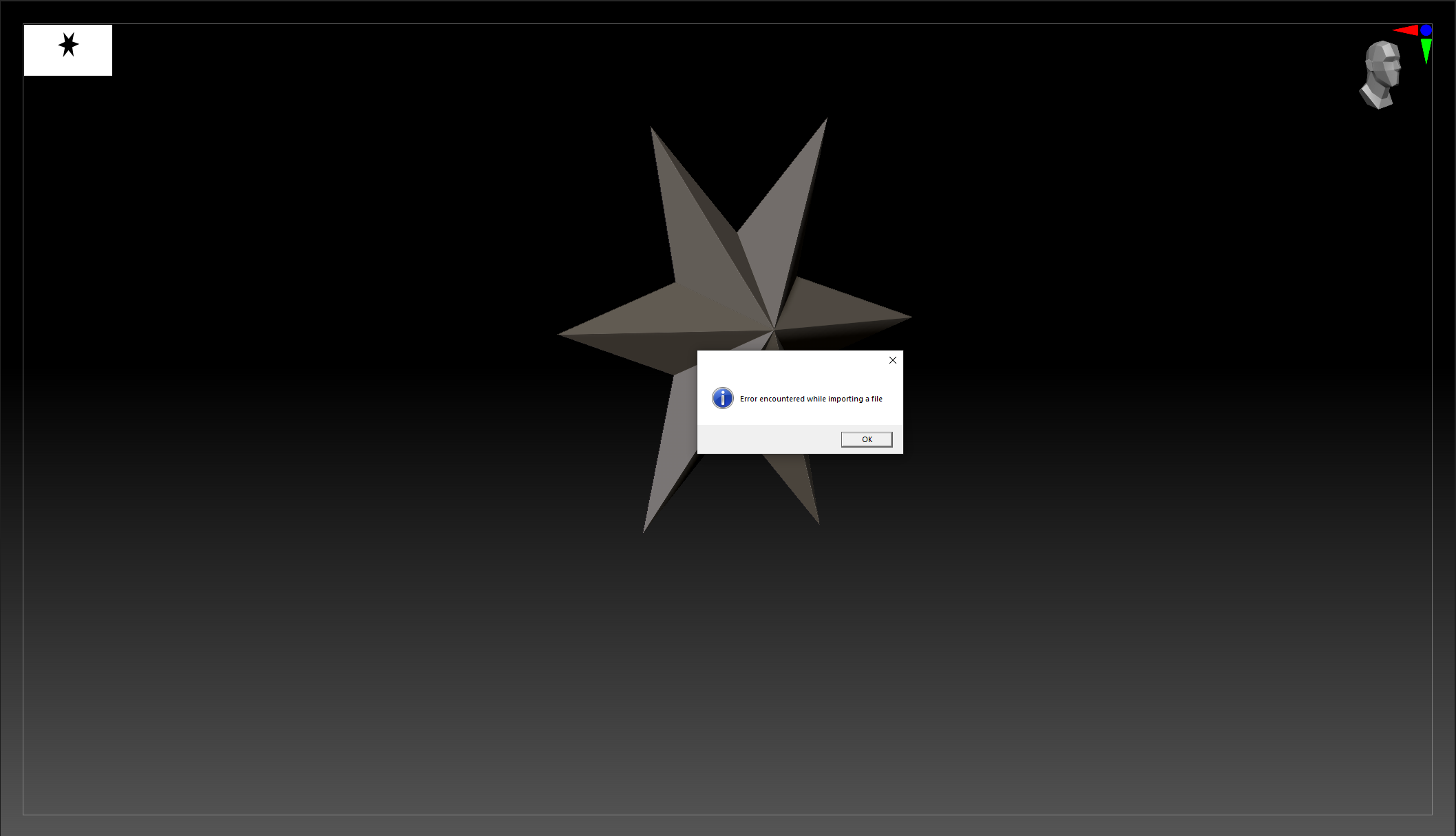

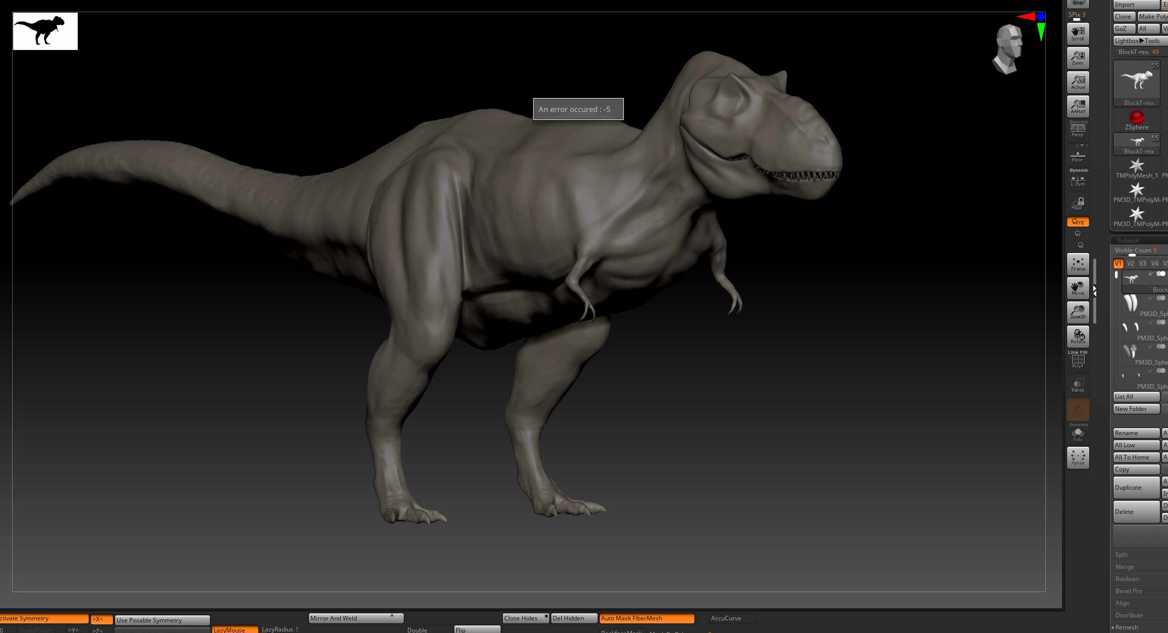

When I use TPOSEMESH, I receive the following message: “An error occured: -5”, then when I click mouse button, a new subtool with the PM3D_TMPoolyMesh is created just with a star. And a popup window with the title “Unable To Open File” with a path, the images attached show the problem. I discovered that the problem is on the subtool, I´ve zremeshed, tried to delete hidden meshs and didn´t solve the issue.
What shoul I do?TPOSE tpose1.PNG TPOSE2
I found the solution, the subtool name had a apostrophe, and it disturbs the code. That´s the reason that zbrush didn´t find the file.
