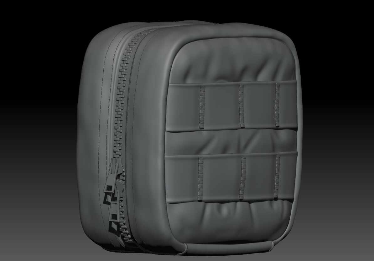

Finally i have created my first project using zbrush as it is out for ipad devices,
Had to export a simple model from Blender for working on sculpting on zbrush,
Any Advice so that i can further improve this?
Also I have been watching tuitorial as well seems like all panels / catagories are well set just like pc with slight different ui elements which is very touch screen friendly and which i really like.
And also I was not able to find some options?
Like for example surface Noise seems to be missing or i was not able to properly spot it? As I wanted to give rough consistant cloth texture instead of manually painting cloth
Any help or ways i could do would be very nice to know
Thank you!

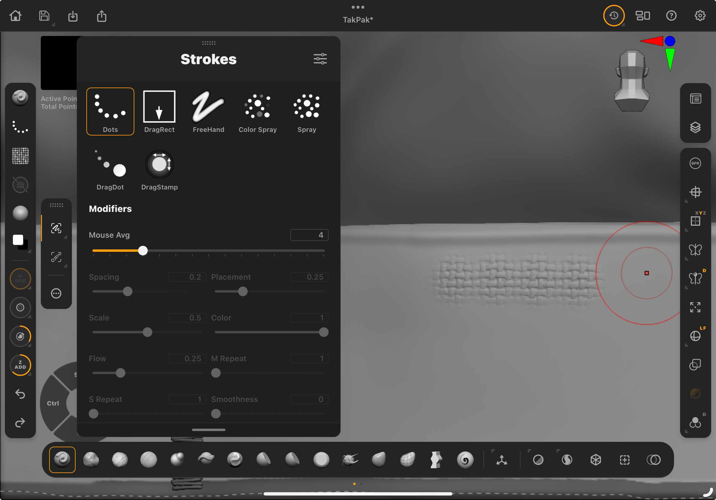

Thank you very much for your reply, I also have a question relating to brush, How do I Adjust focal shift of brush?, I have been trying to find but could not find that setting to manually stamp cloth pattern, the brush is having fade affect on the alpha edges or is fading.

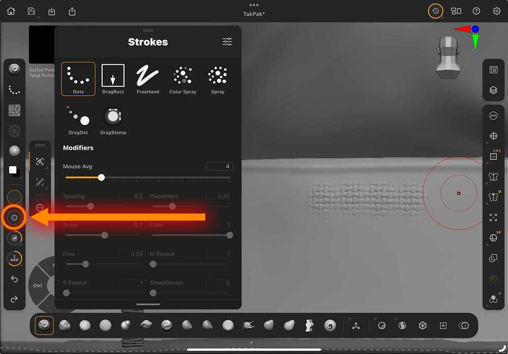

It’s the button of the left toolbar right above Draw Size :slight_smile:
focalshift2
Likewise it can be found in the Quick menu (Spacebar modifier button), or via the O key.
