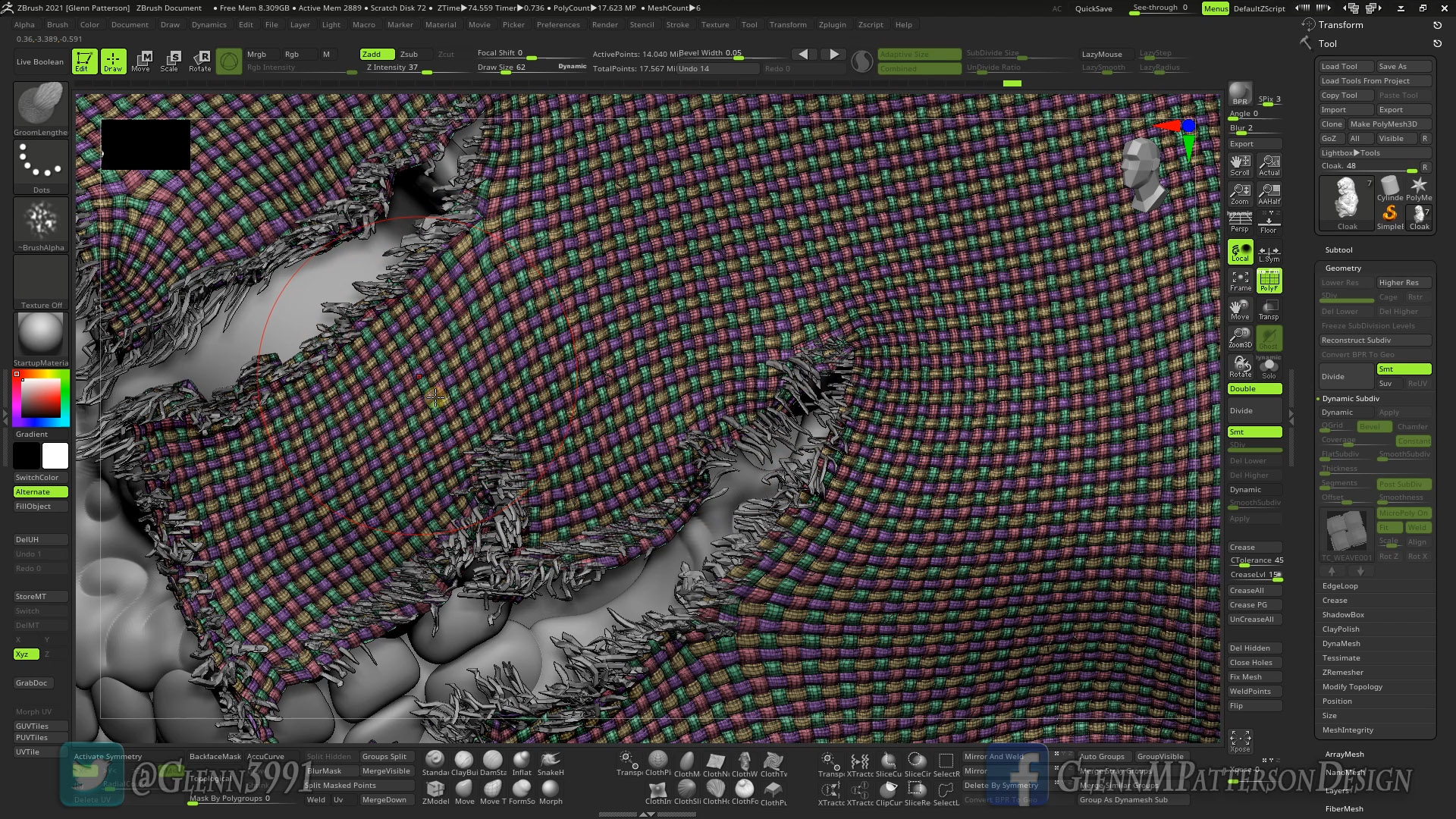

  1. You’ve by Now Figured out this Plug-In isnt a Magical Button that does all the Work for You. We still need to do some work to Finish this up.
  2. We need to modify those Edge Fibers to look better by using a Combination of Brushes. Groom-Lengthen, Groom-SpinKnot, and Cloth Smooth work well for this. Be sure to lower the Z-Intensities and add a Alpha to the Brushes. The Goal here is Randomness.

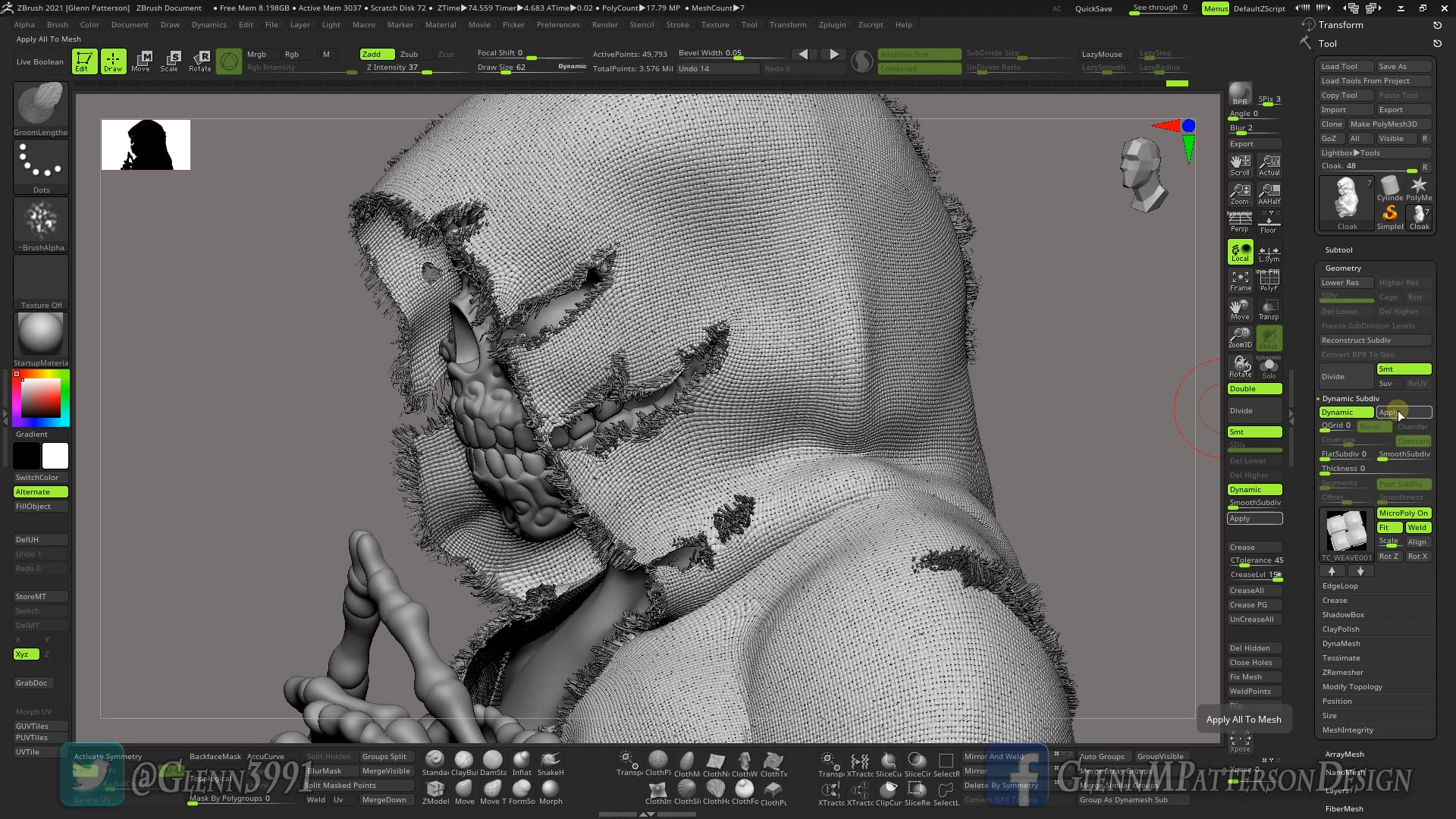

  1. Go into your Geometry/Dynamic Subdivision Panel and Click Apply.
  2. This will Generate a Editable Mesh to work with. Mind you this will Create 16-20 Million Poly on the Highest Preset of the Plug-In.
  3. Take Note that each thread has its own PolyGroup. This will come in Handy.

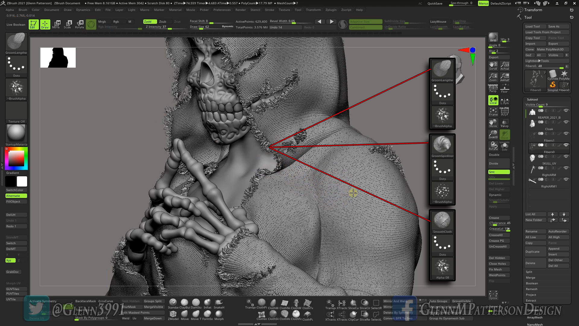

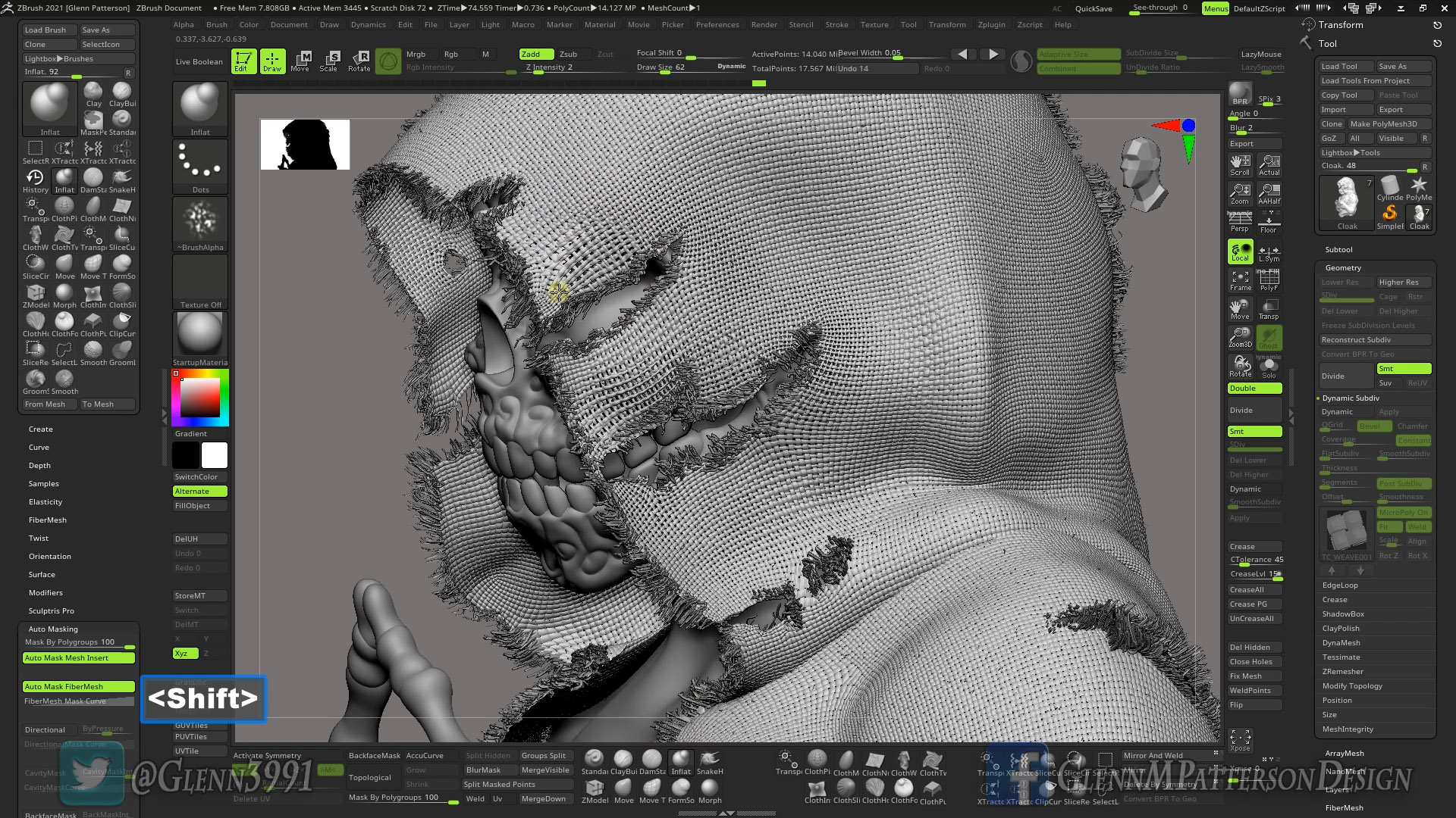

  1. Now lets go to Town on Manipulating the Cloth
  2. Best Brushes for this is Inflate, Smooth, and also Spiral work quite well. Keep the Z-Intensity really low on this Brushes. As Well as add a Alpha to them to keep things Random. Also turn on Mask by Poly Group every once in awhile to only affect just one of the 4 Poly Groups on the Cloth.
