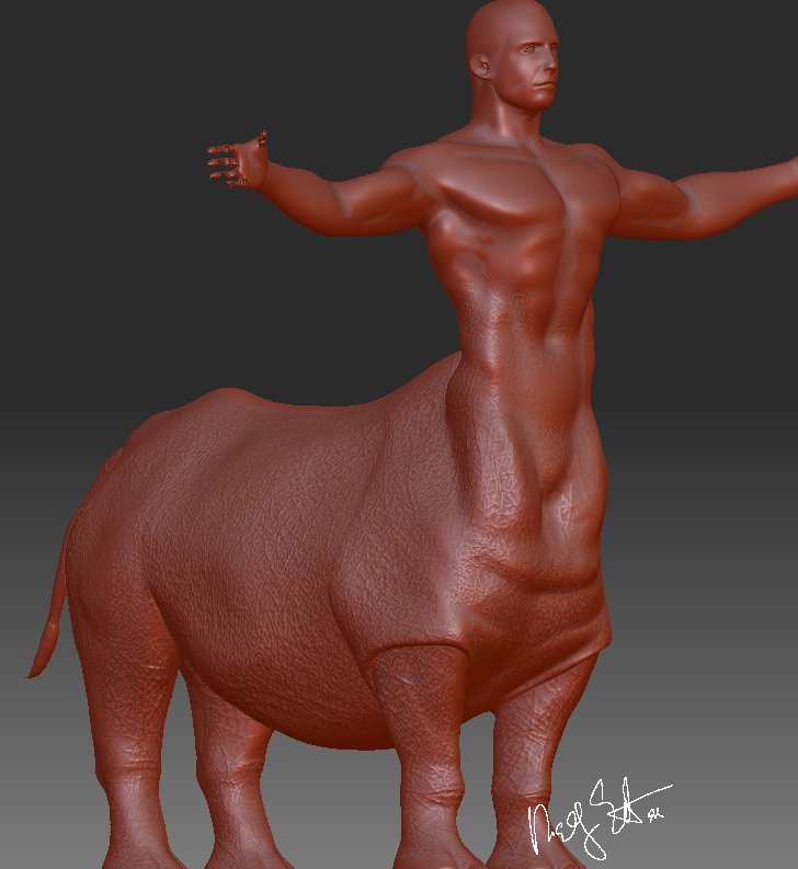

In this tutorial we will merge two mesh-objects into one clean new mesh by mainly using the topology-feature in a very quick and easy to handle way.

i already try this and it works well but as i can see you also didn’t solve the low-poly-retop-finger-hole problem!
Thanks to all.:smiley:
@Yiannis: yes, the fingers are indeed a problem.
I didn’t had the time yet to try an easy solution for that, but I will think about it later.
@ andreseloy: Yes, but no more time for that in the moment.:wink:
But I think the .pdf is clear enough about all what has to be done to master this in every individual project. The steps are almost very simple to adapt for ones personal needs.

any word on how to fix thouse fingers?
Look here:
http://www.zbrushcentral.com/zbc/showthread.php?t=44876&page=32&pp=15

You seem to have the same problem I’m having with corruption of the finger polygons. Any idea what causes this? I’ve searched tons of topology related threads and nobody has covered it.
I think I was able to find a possible in the main Topology and Flow Lab tutorial. For some reason the search wasn’t finding it previously when I was looking around that thread.

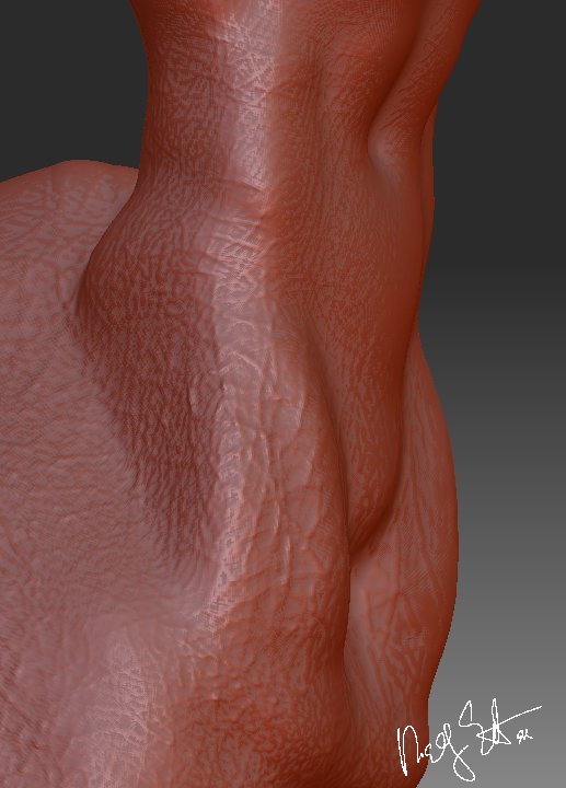

To proceed I have to merge the head to the neck, WITHOUT losing the subdivision levels of my head tool. Can your topo-merge technique manage this? Or will I loose my subdiv levels. Do you know a way this can be done?

Unfortunately I don’t have a solution (I just had the same problem in my work with Jana.) :cry:
Whatever I tried, by topo-merging the two parts in a low subd-level , the details of the previous high-subd-levels are lost.
Morph-Target does also not work.
I also tried to Makepolymesh 3D the both parts in their highest subd-level, insert-mesh to connect both as described and thought about using the Reconstruct-Subdiv - Feature to go to a low-poly-level, retopo and then get somehow the details in the new mesh, but no success.:-1:

And what about the ZProject tool/brush? I haven’t looked at it yet, but can’t it copy the details of our original models back on the merged model?
