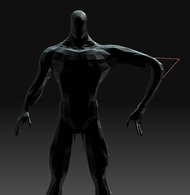

I did your toporig just as explained. But when I go to move the zsphere once they have been bound they do not rotate…the only move…and the parent to child relationship is broken.
this pic is me in the rotate tool trying to move arm.
Thanks in advance!
Nick, I already posted this in the Topo-Flow-Thread:
I only have sometimes an out-of-the-model-comming rig when I bind a rig to a model on which the rig-topology wasn’t originally created.
On the original-model, I never saw this behavior.
For posing, use Rotate-mode and Drag primarily the ZBones (the connection-lines between the micro-zspheres) . Only use the micro-zspheres for rotating around the length-axis of your Zbones.
In every case, the micro-zspheres shouldn’t move away from each others when you are in Rotate-mode and drag a zbone, they must always stay on their realtive length-positions to their neighbours and only move in a rotation manner.
Did you create the topology of this rig on this model or did you adapt it from another ?
In which modes do you work ?
You are sure to have Rotate-mode active, not the Move-mode ?
Unbind and delete your model from the rig and pose the rig alone.
If it also behaves strange, you might be in the wrong mode.

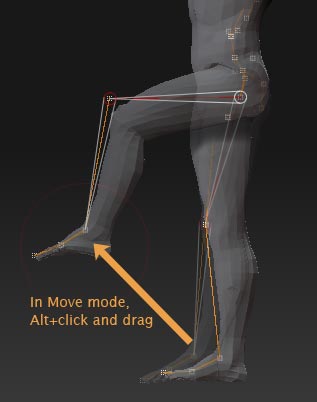

Whilst I agree that Rotate mode is great for posing, try also holding down Alt in Move mode for ‘natural-linked movement’. So, for example, hold down Alt and grab the ankle micro-zsphere, then move it up.
Haha, Marcus, do you know that you just found the hidden way to pose in IK (Inverse Kinematik) ? :grimacing:
Of course you know.:laughing:
You’re really genious. :bulb:
Any other secrets that you found ? :smiley:
So, folks, I will update the topo-rigging-tutorial and the top-post once again to include the previous known FK-like pose-method in Rotate-mode and Marcus’ way that represents IK-mode.

The tutorial is updated with a closer description of FK and Marcus’ IK-technique.
Again a big thank to Marcus.:smiley:
