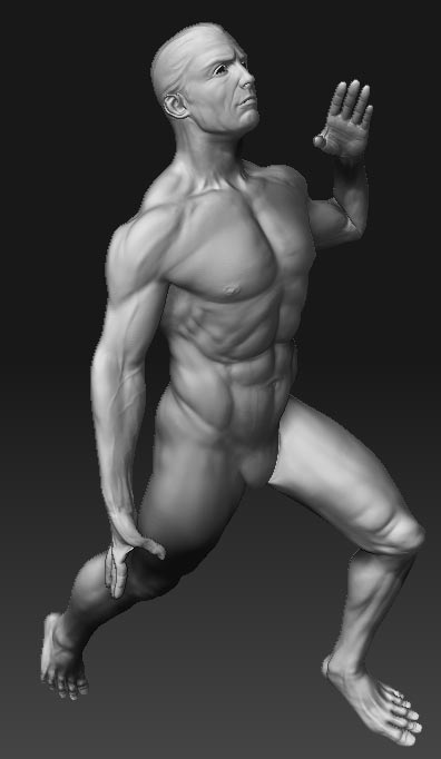

Yes there is. Try this:
First make sure you rig a copy of your model. Create your rig at the lowest subdiv level; bind and pose the rig. When your happy with a pose, create an Adaptive Skin, making sure that the Adaptive Skin: Density slider is at 1, so that the resulting mesh has the same number of polys as the lowest level of your model. Select the new Adaptive Skin posed version and export as an OBJ. Switch to your original unrigged model (remember, you made a copy?) and import the OBJ at the lowest subdiv level (you can create 3D Layers for importing multiple poses). Go up the subdiv levels and admire your work.
[attach=59839]SuperAvManHi.jpg[/attach]
Here’s a very quick pose using this method and Mr Petroc’s SuperAverageMan. Don’t look closely, it was VERY quick!
