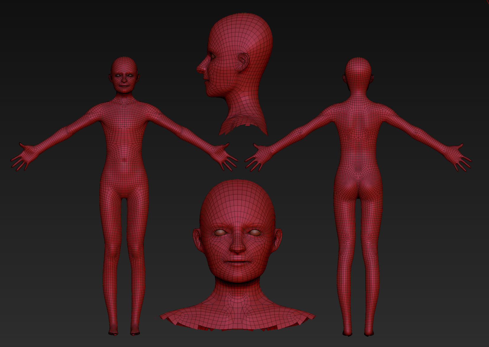

Here’s an image of the final mesh that has been generated with the method discribed in the vids. (I did add some polygroups after the recording so that there is more detail on arms and legs on the image than in the vids.)
With a bit of refinement this took me about an hour of actual sculpting, which is a lot less than when I do the same with Dynamesh, since I tend to struggle with base shapes at the high mesh density that Dynamesh generates with these kind of sculpts.
