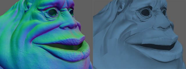

I have issue with my ZB3.1 normal map in Lightwave.
The model already has a displacement map applied. As you can see in the image on the left the UV placement of the map in LW is fine. But when its applied as a Normal map in the Surface Node editor this is the result I get. Has anyone got any idea’s.
Hi Big Gun,
I’ve been making normal maps with ZBrush 3.1 using MD3 and rendering them in LightWave 9.2. So far I’ve yet to see a problem. So if you don’t mind I’ll ask a few questions and hopefully we can get to the bottom of things.
What type of Normal map are you creating, Tangent or World? Also, how was the Normal map generated? Did it come from the Tool | Normal palette or was it made using MD3? If MD3, what bit depth is your map? And finally, what version of LightWave are you using?
Hi Steve
The Normal Map is World.
The Normal Map was created using Tool/Normal palette.
I’m using version 9.2 , lightwave build 1206.

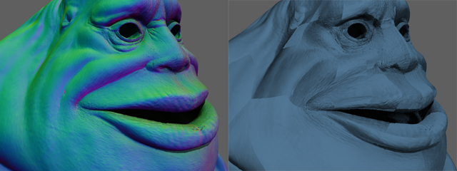

Thanks for getting back to me so soon. Since my post I’ve tried various Normal map exports testing the diffrent flip options in ZB. Although they all give diffrent shading results they all still have the strange UV map segmentation. The UV map is GUV. I will test a AUV UV and post the results in a few hours.

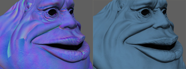

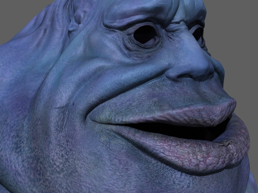

DB_Normals_issue_02.jpg Here is the the model with AUV’s normal and displacement maps. The same thing seems to be happening. Could it be to do with the way i’m exporting the OBJ file from ZB3. ?
Hi Big Gun,
My guess is that there are a couple of things which are working together to create the problem. LightWave 9 requires Tangent maps rather than World maps, so the first thing to do is generate a new map with the Tangent button enabled (or create them from MD3).
It also appears that you’re getting some strange UV shading. If I had to take a guess, I’d say that the problem is coming from the source object. For example, if your object is extremely low res in Modeler, it can create texture stretching that will give bad results. Also, if your unsubpatched object looks significantly different than your subpatched object, it can be problematic. Try freezing it before bringing it into ZBrush. Also, if you’re using CC SubD’s, try switching back to regular Subpatches.
If you’re comfortable doing so, send me the ZTool or exported OBJ. I can take a quick look and let you know if I spot any obvious problems. If you’re not comfortable with that, try the above suggestions and if you’re still having problems, let me know.

Hi Steve
Problem solved.
:laughing:
It would seem I have at long last lost my power to read tutorials with my eyes closed. Alas from this day forth I to will be consigned to reading tutorials with my eyes open.
In the immortal words of Homer J Simpson
“DOH!!!”
Turning the tangent normal map on did the trick. As it clearly states in your excellent tutorial. Thanks again for the all help.
