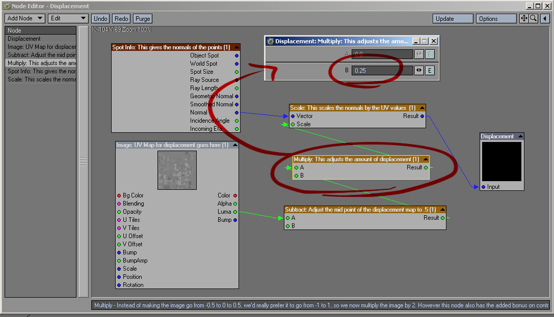

Steve, later in your tutorial you discuss importing a Zbrush displacement node while in the Node editor. This node does not appear to be included with the LW9 download. can you tell me where i can find it so i can proceed further using your excellent ZBrush to LW9 tutorial?
LOL, I always figured that LightWave 9 would be out by now, so I wrote about the displacement node as if it were already available. :o Since LightWave 9 is still in Beta, I can’t distribute the displacement node. But if you look at the screen shot, you can easily reconstruct it.
Just add the nodes in the attached image and connect them as shown. The amount of displacement is controlled by the Multiply node. Change it as described in the ZPipeline guide and you’ll be set. If you have questions or run into troubles, don’t hesitate to ask.

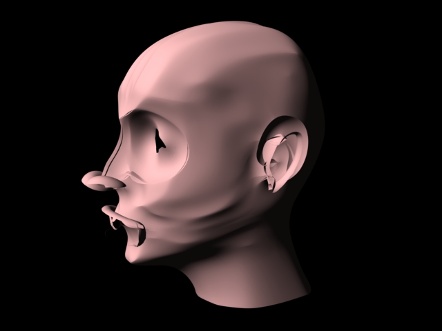

Please can anyone help, I’m having real problems rendering lightwave models using displacement maps from zbrush. I’ve followed Steve Warners excellent tutorial step by step but I always seem to have the same result. The problem I think I have narrowed down to the node editor set up part. When I enter 0.25 in the multiply displacement value box it makes my model go mad with polygons going all over the place. Even if I change the value down to 0.01 I still end up with a render like the one below. Normal maps and bump maps seem to render fine. Apart from I’m getting weird seams on the normal maps. Am I being really stupid and missing something very straight foreward. Any advice would be great. I’m using Lightwave 9 and running it on a mac, if thats any help.
Make it a negative number. What do you get?
