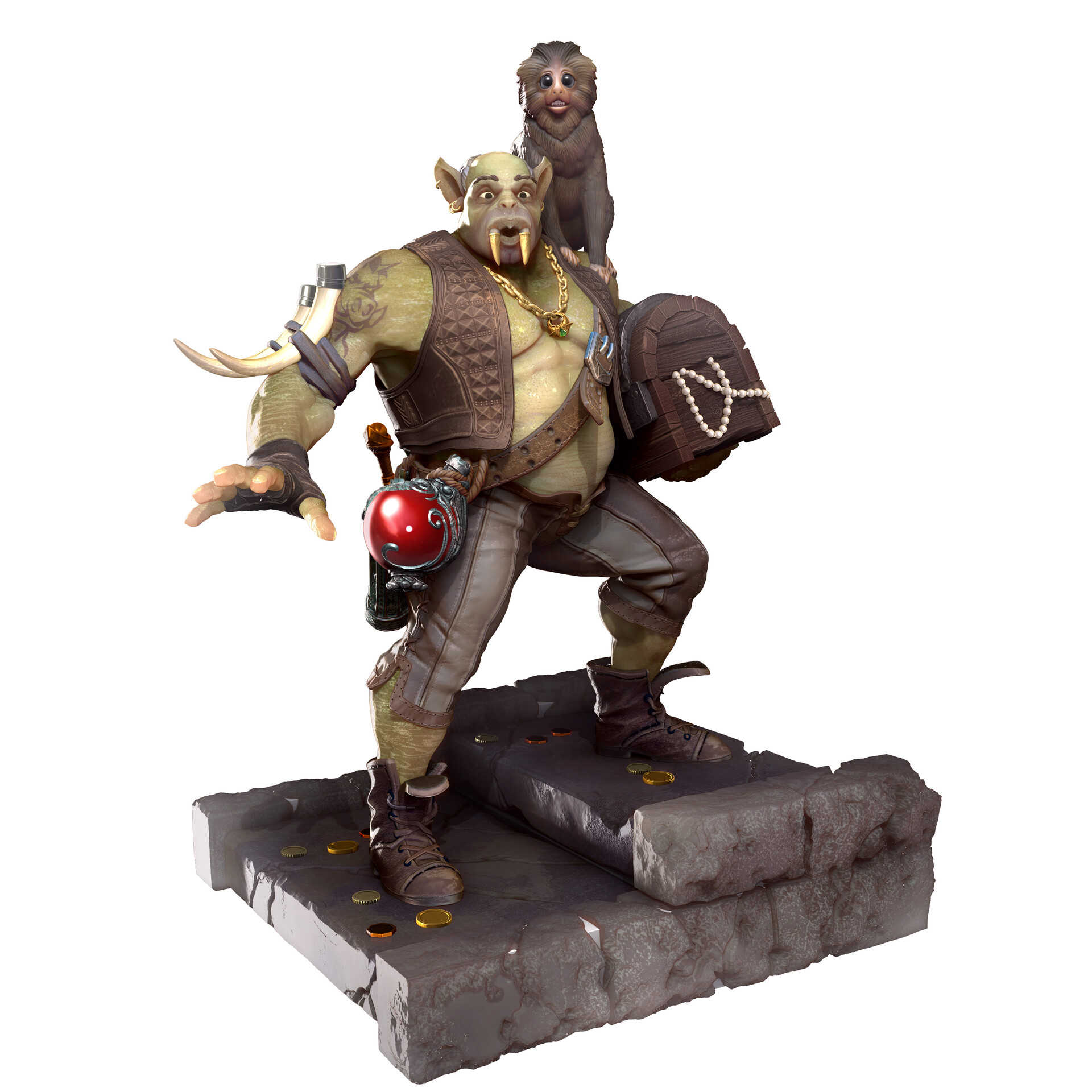

To speak on my process a bit. The first step for me always is to sculpt and pose the Figures. I like to poly paint a texture as I go, using the mask by cavity and surface noise patterns to generate my masks.

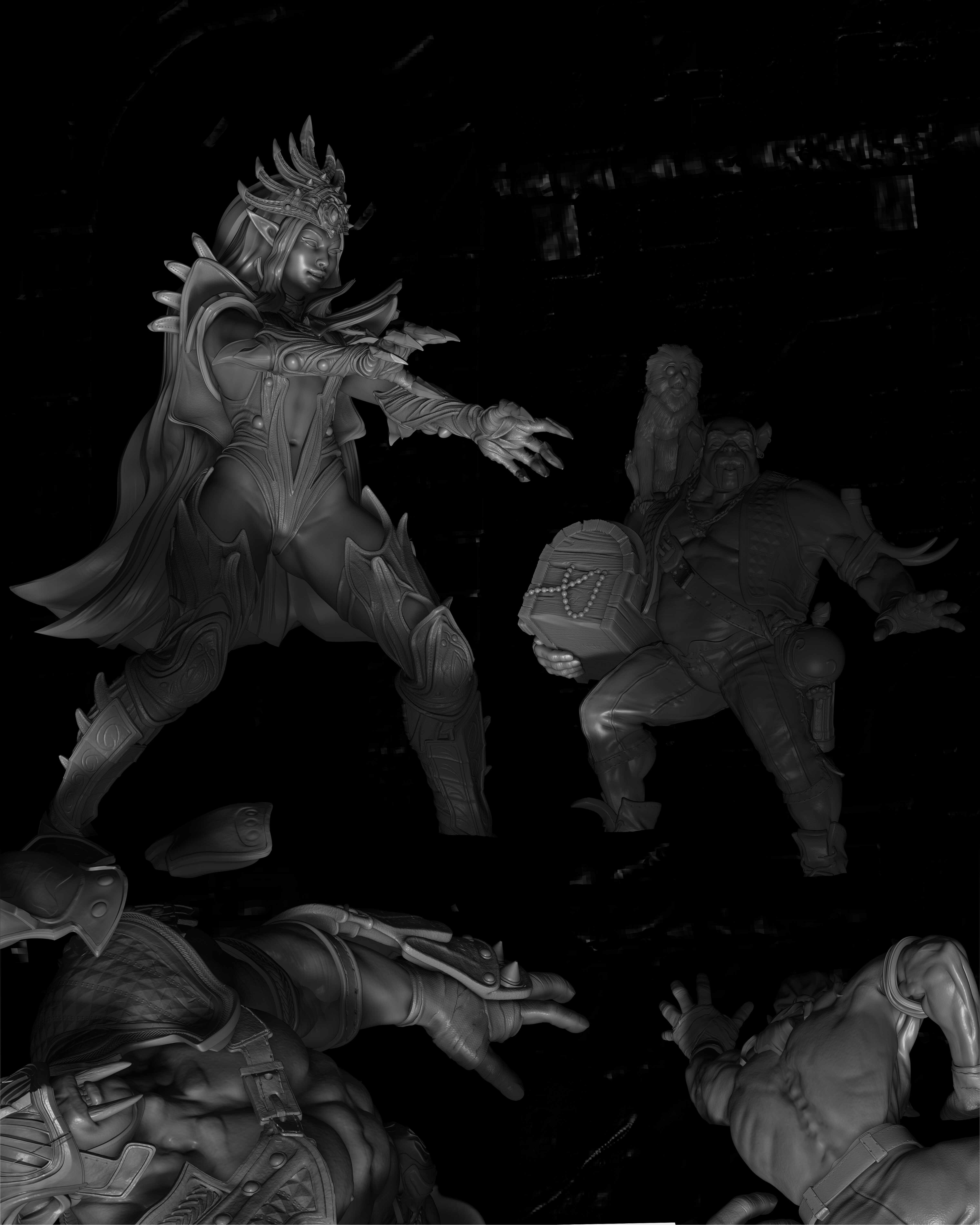

I try to capture every matcap and bpr layer that might be useful in the comp later. I often take a few different lighting passes at this point as well. To do this, just turn your textures off with the paint button in your subtool list and play with the lighting tab with no ambient lights and bpr away. This will give you back and white lighting passes to use later on. I find it super handy to render the scene with the normal map mat cap! You never know when you’ll need a sidelight to make some detail pop in the comp pass. Fake anything you need to.

In this image, you can see the characters in the primary lighting pass. The light is coming in from the explosion off-screen here. It’s probably the pass that showcases the sculpt the most. In the future, I might duplicate some of the standard materials and create a few different ranges of “smoothness” so I can really differentiate the material reads in on light capture. Please excuse the flipped canvas, it’s something I do pretty often over the course of the comp pass.
