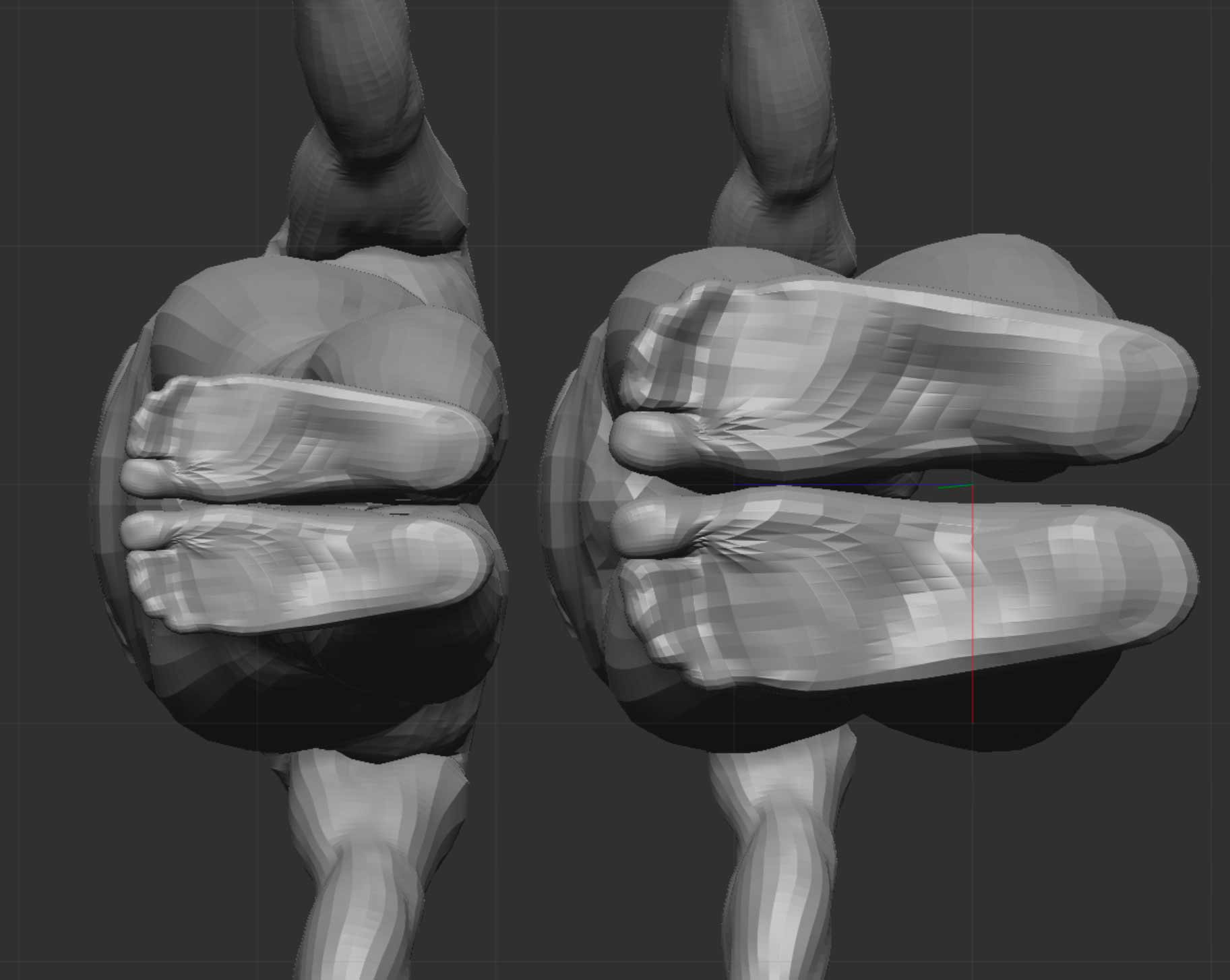

Please see the following image. On the left I’m viewing the feet of the demosoldier model with perspective OFF. It shows the actual dimensions of the model. The feet have a certain size relationship to the rest of the model and that relationship does not change.
This is physical reality. However this can only exist in the digital space. It does not represent how the physical object will actually look. Our eyes process information with perspective.
On the right is with perspective is switched on. Depending on the viewing angle, this now distorts the proportions to simulate the way it would look in reality. However, the physical relationships are no longer consistent. Depending on your viewing angle and distance, you might think the feet were actually much larger than the body.
This is optical or camera reality.

It’s mostly how I work. Your mileage may vary. However I emphasize getting the proportions correct and don’t worry overmuch about any particular setting. There are simply too many variables that affect the way a model will look in reality.
One additional factor I’ll make you aware of is the focal center for the perspective mode, which can change the appearance of the model depending on where it is on the canvas. Do as I have done with the demo soldier in that image, and position the feet toward you with perspective mode ON. Then pan the model around the canvas. You’ll see that the legs appear to change the angle they are sticking out at depending how far they are away from the center of the canvas. This is determined by the center of the canvas document, not the center of the viewport. So if your document is partially off screen, this can affect the skew of the model when Perspective is on.
You can actually deactivate this by switching off the Universal Camera in the Draw palette, and using the Legacy Camera instead. When you do, the “Align to Object” feature will become available. This is also sort of a cheat, but it will enable perspective as if the model is always being viewed from the center no matter where it is on the canvas. There is foreshortening, but the 'skew" of the model will not change.
