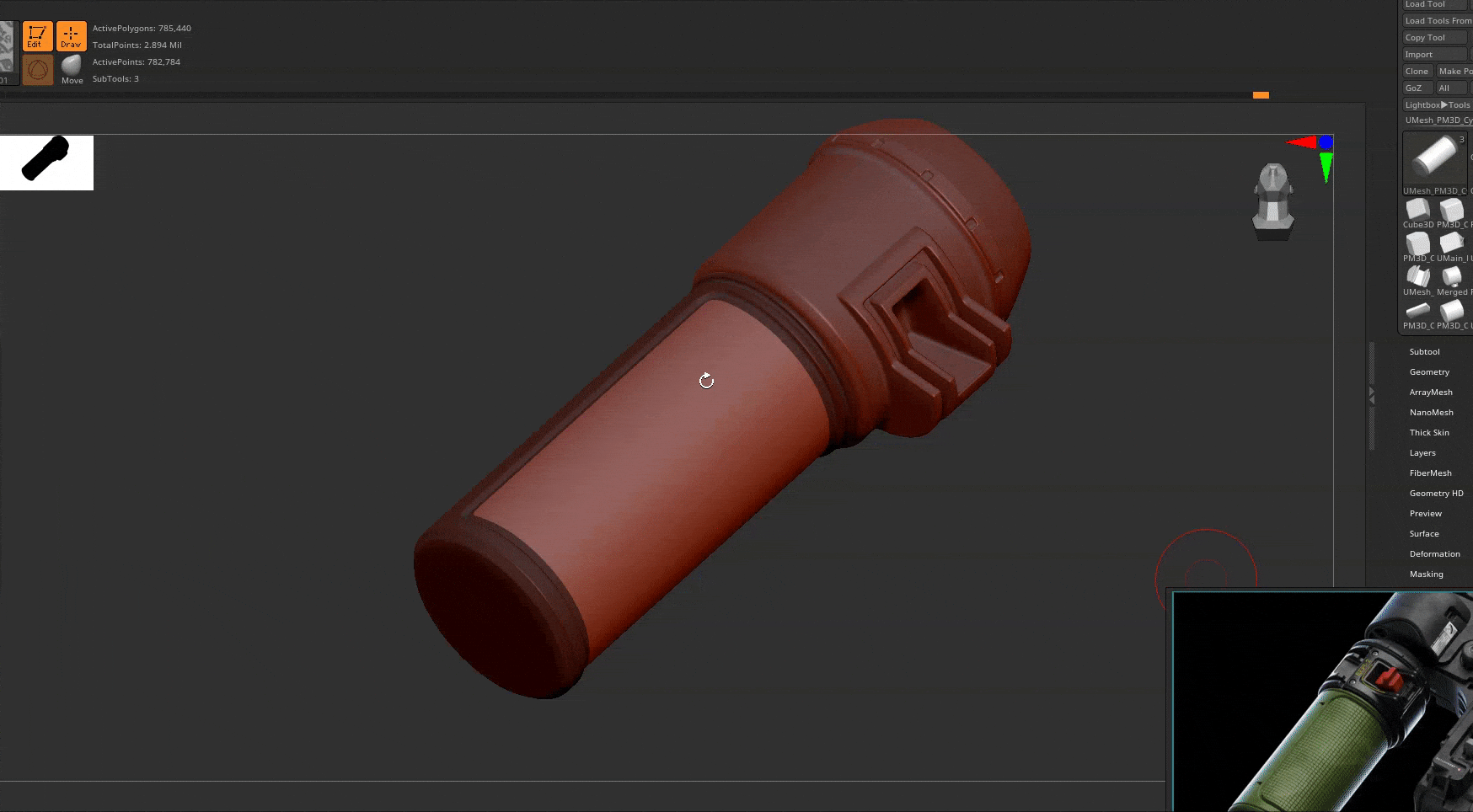

hello, i was playing with the surface noise, all the tutorials out there seems to project it directly to there mesh, but me when i use it i have to paint using the pattern 1 or 2 brushes( its cool) but i want it to be projected automatically, can any one guide me through this, much appreciation?

here is a Gif to maybe clarify the issue, I’m suspecting that the problem is the Uv’s, i did post in a separate section the Uv Issue so that people with the same related problem may find it when having similar issues (Morph UV Mesh Problem - ZBrushCentral)
GIF Recording 2022-02-03 at 6.41.10 PM
as you can see, i have to paint, i see others are just pressing okay and it applies the noise on your mesh, the documentation seems not to address this, or maybe i did read something wrong!
Edit: I fixed the Uv’s Problem, but still not projecting directly into my mesh.
I think I see the problem. You’re attempting to apply the noise via the Brush> Surface menu? This only applies to the brushes.
Go to the Tool> Surface> menu, and apply your noise through that menu. See if that resolves your issue.
Yep, didn’t notice that there is two Surface’s Menus, Thank you my man it worked :grin:
