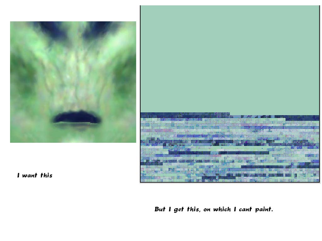

My problem is painting in projection master an imported texture around a curved belly.
What happenes is the seams get created at the edges even if I mask it.
I want to know how to fill texture in the canvas like in the kens tutorial .
when I fill it it comes like squares and rectangles. ???
If I can fill the texture like that then I might use deco brush to create a staright texture on the texture map reducing the seams problem.

i belive its happening because of auv tile.
I ahve already applied auv tilking to my model how to remove it now ?
So that i can use a texture which I can paint upon by filling in canvas.
[uvmapping.jpg](javascript:zb_insimg(‘36034’,‘uvmapping.jpg’,1,0))
For that, you have to ‘unwrap’ your model in another app. Or go through ZappLink and a photoshop equivalent image editor. Zapplink exports the ‘flat’ image during a projection master session. It’s all about UV editing. Which is the ‘science’ on how to map parts of your texture onto your geometry during rendertime.

Is there a way to remove auv mapping from the model without going to any other software ?
The problem is i dont wanan uv map it as it creates the squares in the above image which i cant work upon as a 2d map in zbrush.
The time I spend in learning other softwares I will try using it on zapplink for dissolving seams if without any choice. :wink:
you can use Zbrush’s other uv projection methods: cylinder, sphere, and plane. however, these are not very good for complex models, and you will end up losing all the work you have done in the texturing stage. you can recover the texture to some extend by baking it from the AUV model to the model with new UVs, but that requires other software again.
