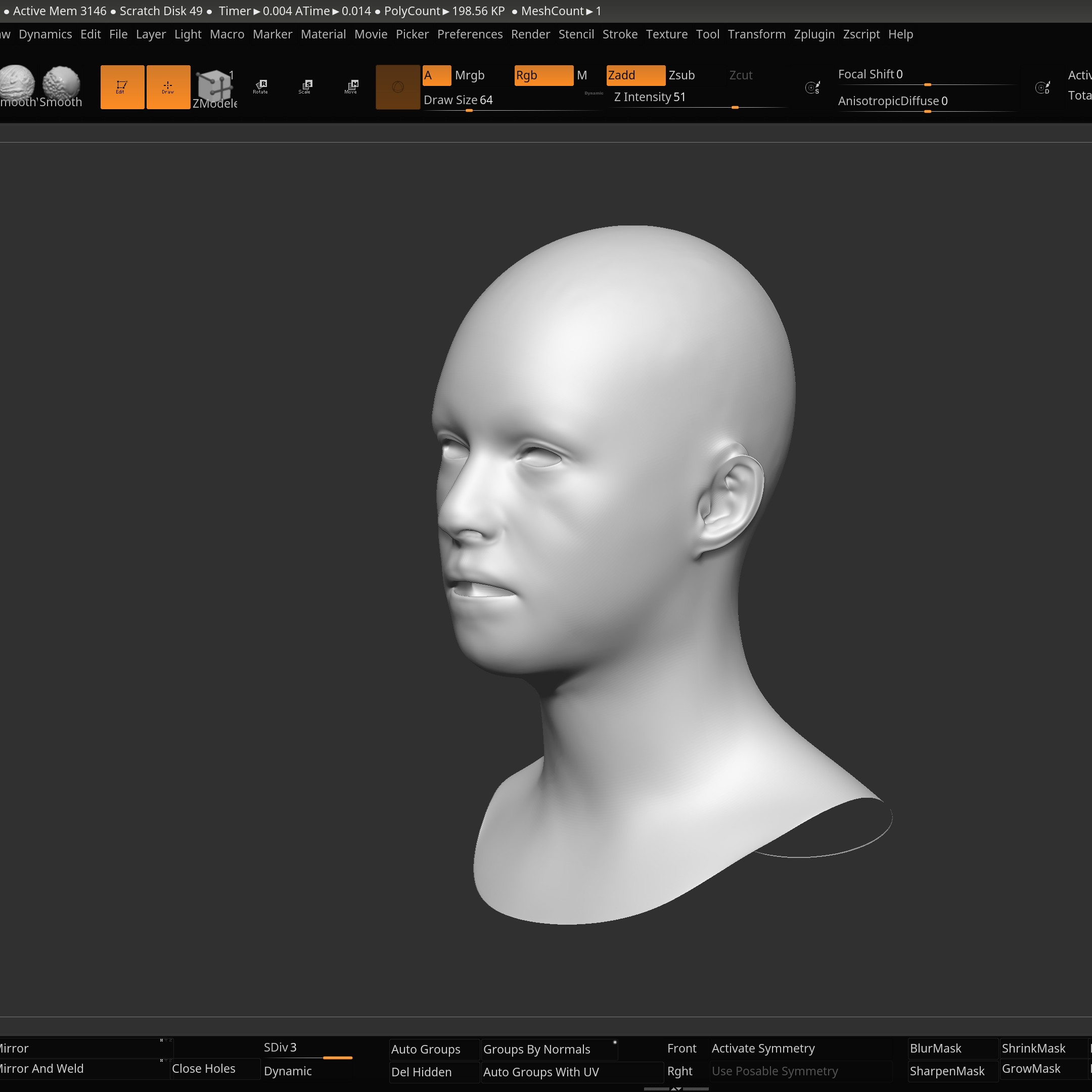

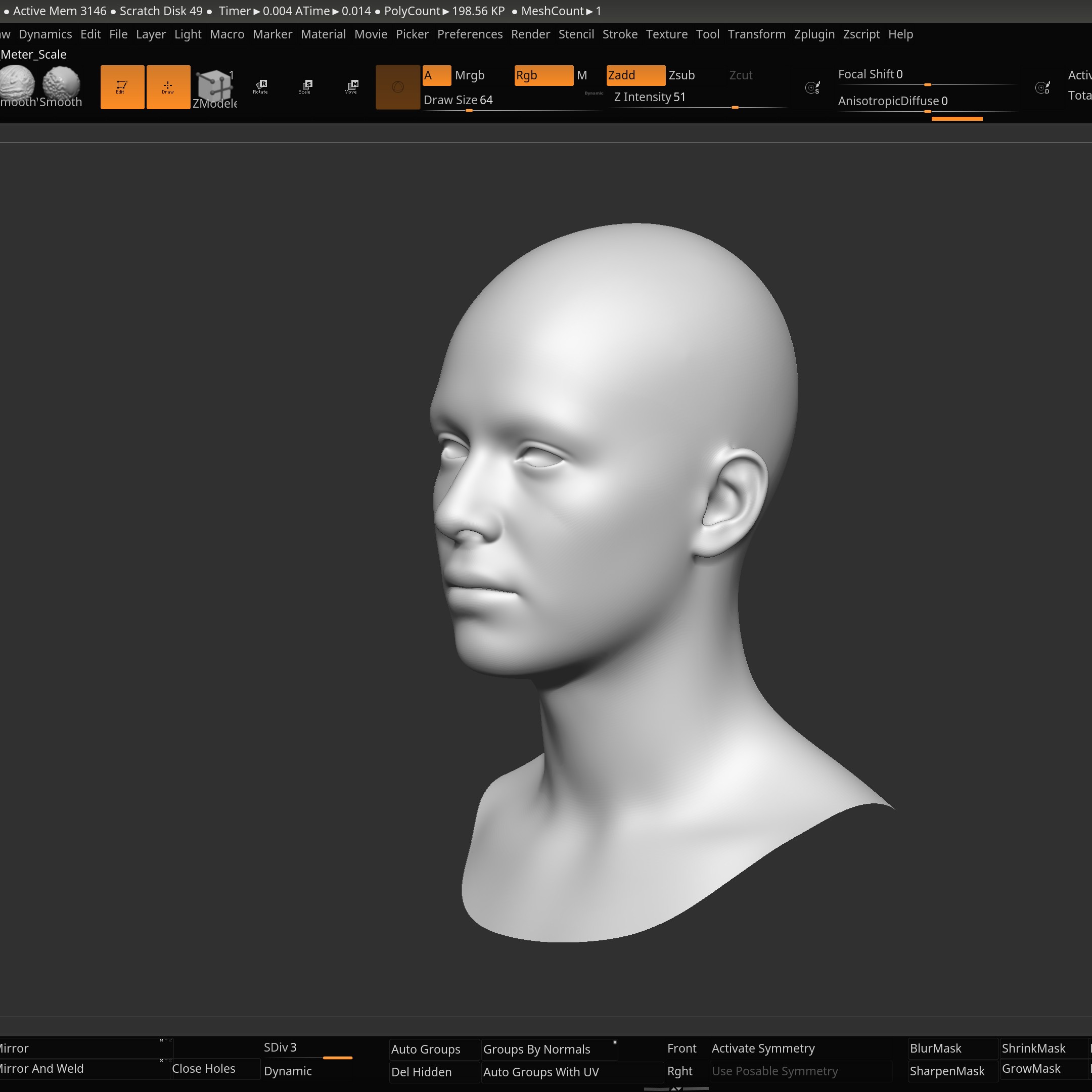

    Now the mesh has been smoothed
    Repeat several times, and your head is a different person
Original Smoothed
