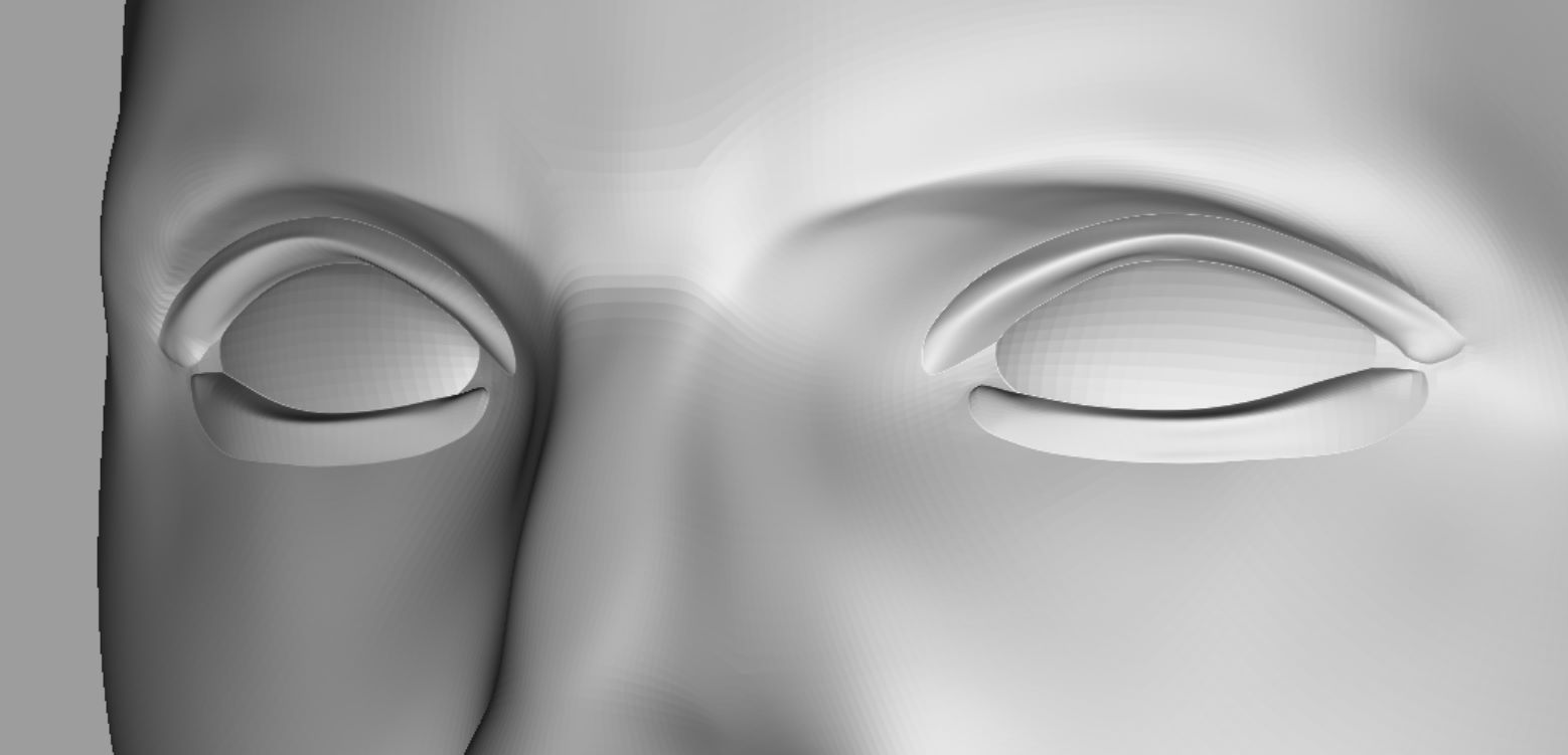

Hello,
how can i stick the eye lids to the cheek and the eye socket so there is no edge to see?
thank you
Hello,
thank you

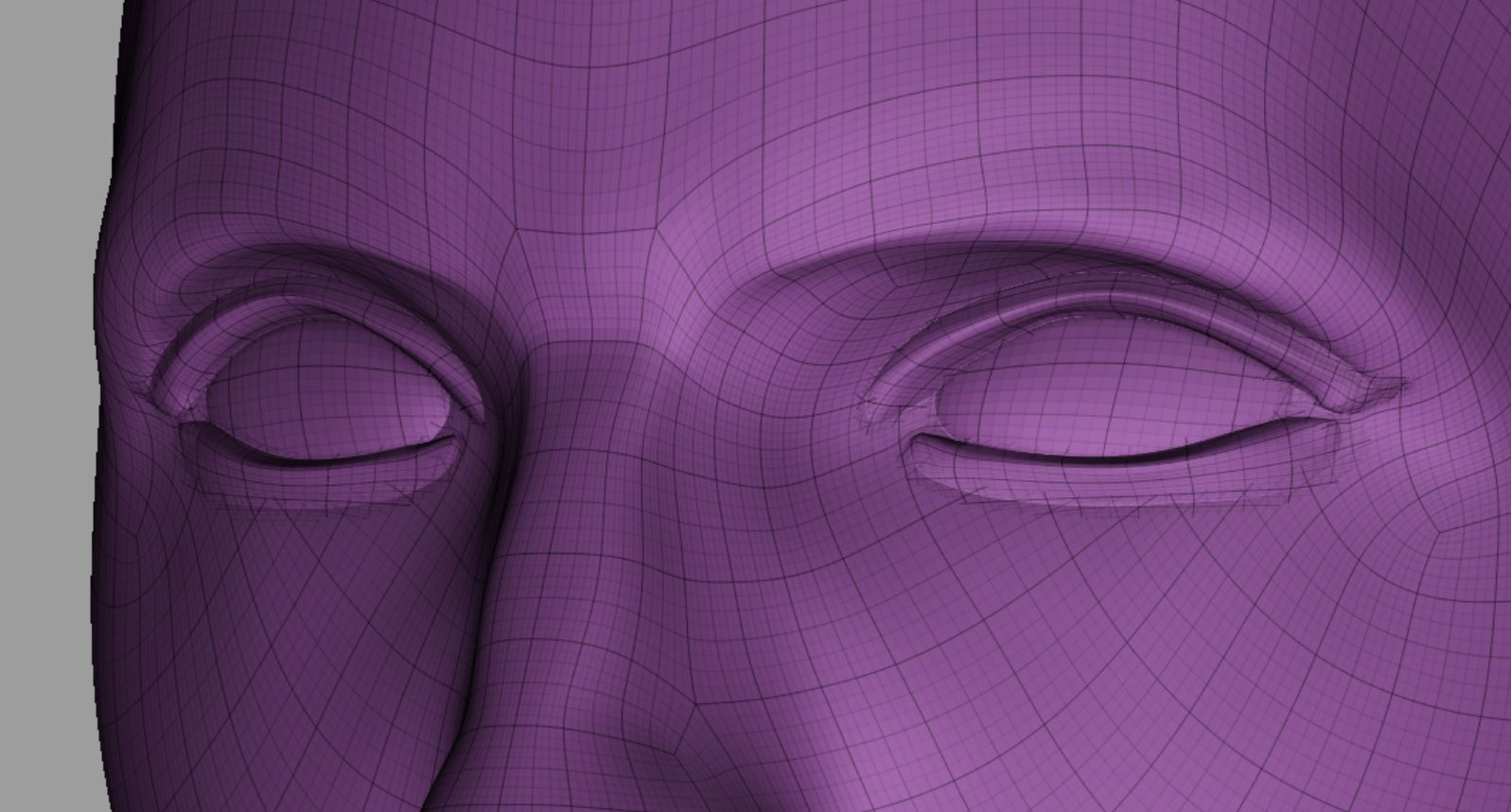

this would require you to merge two subtools into one, and connect the vertex.
usually this could be easily done using Dynamesh, and then smoothing the bumps, cavities.
then using ZRemesher to clean up the topology.
Pixo_Daisuke has a great suggestion. You could also use Remesh by Union in the deformers… That will keep the hard edges so you’ll probably need to smooth them afterwards.
