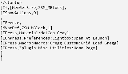

I have had for years, from version 2022 to 2024, used a custom macro startup grid when opening Zbrush. With each version upgrade I just copy and paste the text from my Zbrush startup default text and into the new one and have no issue with startup and grid loading.
I had to upgrade to 2026.1 and the script doesn’t work anymore. Please could someone advise me on what to do to make it work for the latest Zbrush version.

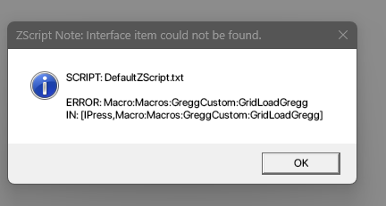

Thanks for the reply. Unfortunatly its the same thing happening.
I even tried recording the macro again, renaming, changing folder saves but still, the same popup appears.
I am at a loss here, its worked previously, never an issue.

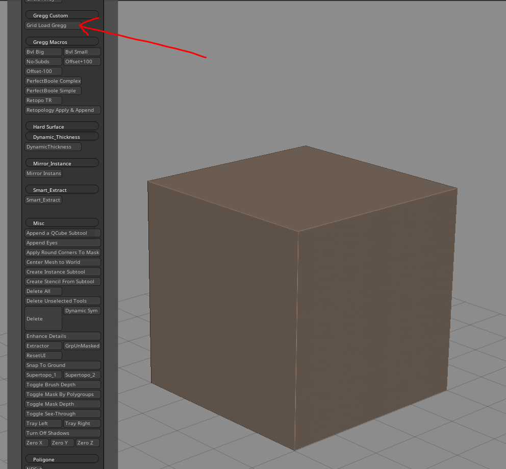

I mean, its there, in the ui, I click it and the grid appears. It just wont load on startup.
