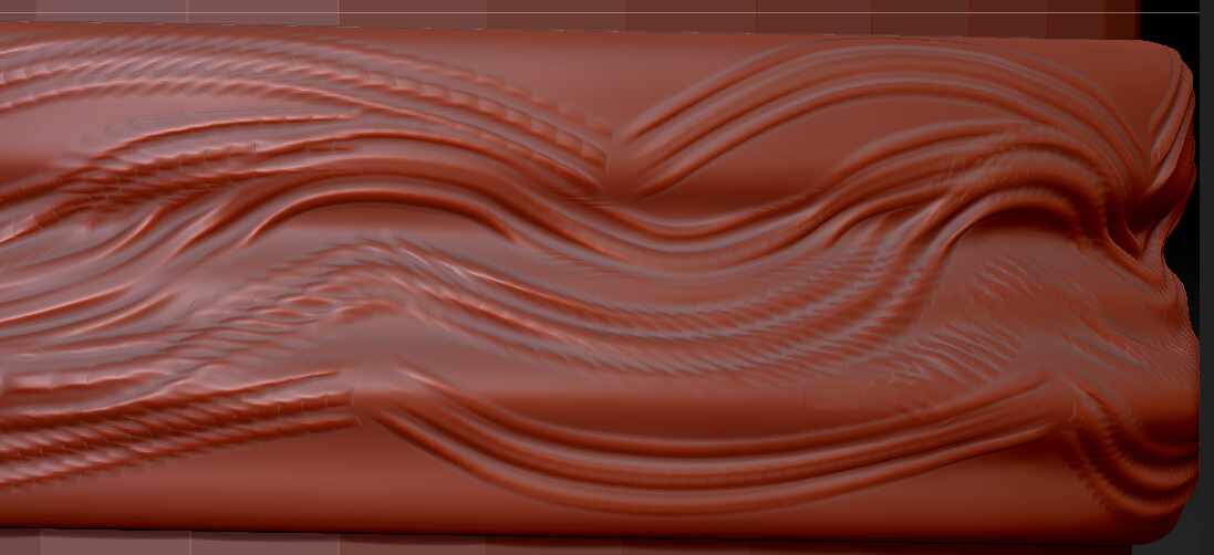

Thanks for your reply. I did a new experiment with a simple Thick Plane at about 596,000 polygons, ZRemeshed so topology is all smooth quads (please see screen shot), and made a few strokes with the standard Rake brush, no modifications to it. I still see the stair-stepping.topology stair-stepping2
In the second image this is definitely a case of inadequate mesh resolution. The dots on the outside of the rake alpha are very small and produce very fine lines. The surface will need significant resolution to pick that detail up cleanly.
However there are other factors. I estimate this is roughly :
  1. 70% Inadequate mesh resolution
  2. 15 % stroke speed. Slow and steady produces the best results. Fast strokes will begin to separate even on low resolution surfaces.
  3. 15% Viewing factors. You are zoomed in very closely. If you zoom in closely enough you will always be able to see the polygonal surface of the mesh which may not be visible with more casual scrutiny of after rendered with AA. Make sure the canvas is being viewed at either 100% or 50%( this creates an AA smoothing effect). Viewing at odd levels of magnification or at values above 100% will degrade the appearance of the image. If your canvas is low res, it may not have the pixel resolution to cleanly display fine highlights. Also, there are material considerations. Some materials in ZBrush are designed to make any sort of detail stand out and introduce contrast effects. This can cause a harsh appearance to very fine detail. The Red Wax is one such material. Consider using a material with a softer appearance.

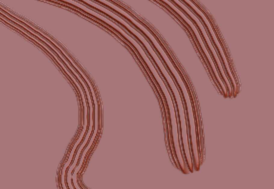

The following image shows the Rake Brush on the left used at the program defaults on a grid that has been subdivided sufficiently to capture the detail cleanly. On the right I have enabled Lazy Mouse, which will give you even finer control. Reducing the Lazy Step to a minimal value will produce the smoothest, least broken stroke but all of the above factors still apply. I have also chosen a material with a more diffuse appearance than the Red Wax.

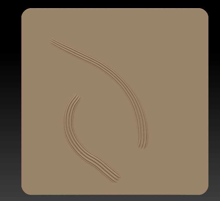

Spyndel, thank you so much for all this very helpful information. I just performed a new test based on your feedback, and the result looks much better: 2.4 million polygons, different material, lazy mouse set to 0.1 steps, and I made the strokes much more slowly. The screen shot is taken at AA Half. The stair-stepping effect is now essentially invisible.
I appreciate the time and thought you put into explaining this.
