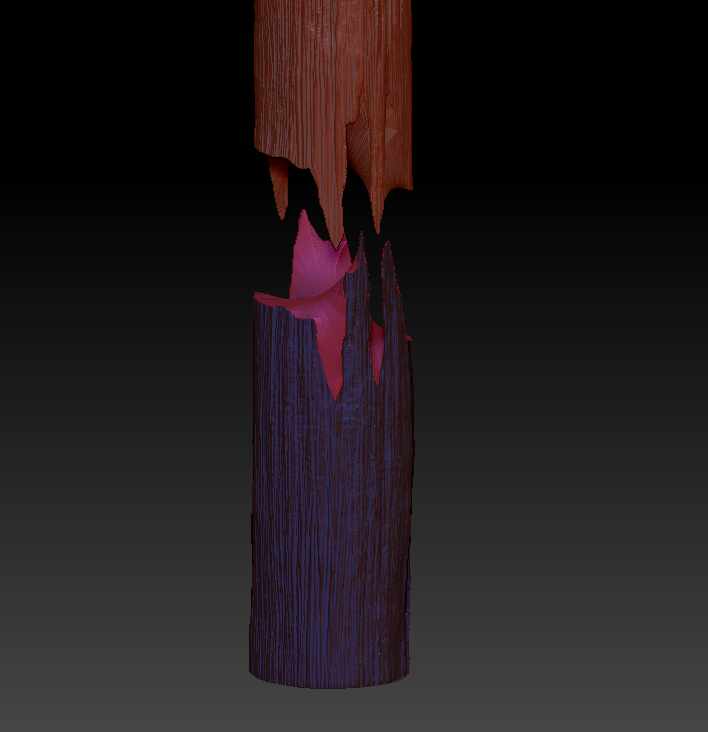

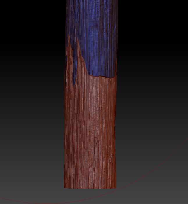

Hello, I am trying to 3D print a wooden telephone pole sculpt I made in ZBrush. The pole needs to be 8 feet tall, so it needs to be printed in about 10-12 pieces to fit onto my printer. I’m wondering if anybody has any advice or tips on splitting the model to create seams that appear as though they are a part of the wood texture, and not just slicing straight through the model.
I’ve tried using the slice curve tool to cut along the wood texture, separate the different polygroups, and then re-dynamesh to close the holes.
I can’t think of any other way to do this, would appreciate any thoughts, tips or feedback.

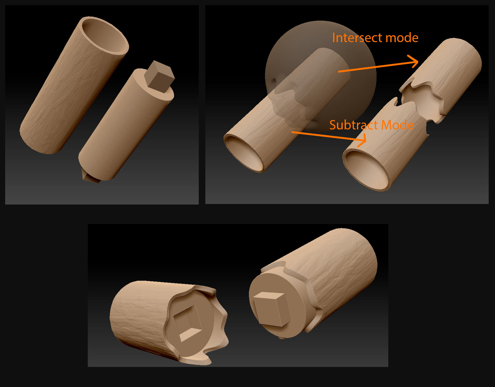

Please see the following image:
boolexcomp2
See in the above image that I have a hollow “bark” sleeve. I’ve completely enveloped one end with a 3D volume, then sculpted the intersection so it creates crooked “puzzle” dividing line. I can then use Live Boolean to create a new piece of geometry–one with “subtraction” active, and one with “intersection” active. This results in two separate new pieces of geometry that fit together perfectly.
You can then adjust these pieces independently of the “core” cylinder, and then recombine them with Live Boolean to produce complete pieces with a mechanically precise interior portion and key slots that fit together. You may wish to slightly increase the size of the core cylinder so that it intersects with the bark and will fuse together cleanly, and you may wish to slightly decrease the size of the cubical key so that it overcomes any swelling that may be a part of the printing process and still fits cleanly into it’s slot.
