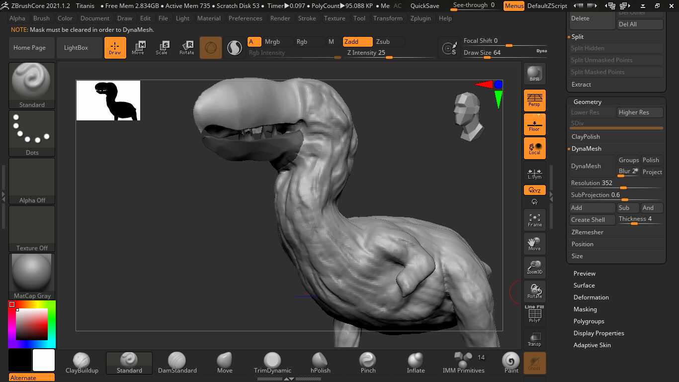

Everything under Split is masked out (I’ve included a screenshot). As I said I hid the lower beak by Shift +Ctrl + Click, started to drag the lasso tool around and then held down Alt to hide the selection.
HiddenLowerBeak

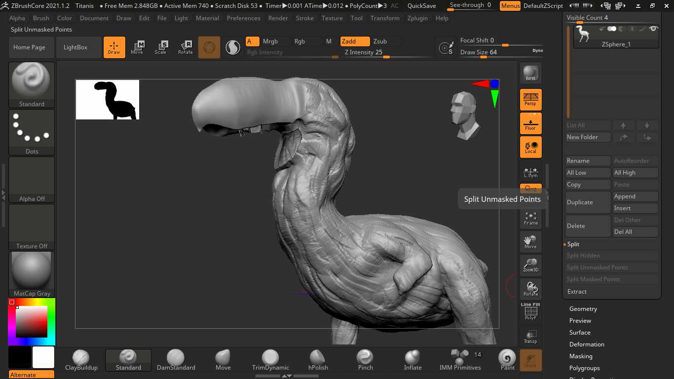

Unclicking Dynamesh turns the selected area into a mask and everything under Split is still greyed out.
As you can see this is fairly early into the blocking in of the form. I didn’t import this from anywhere - I started it as a Zsphere armature directly in Core.
DynameshCreatesMask
