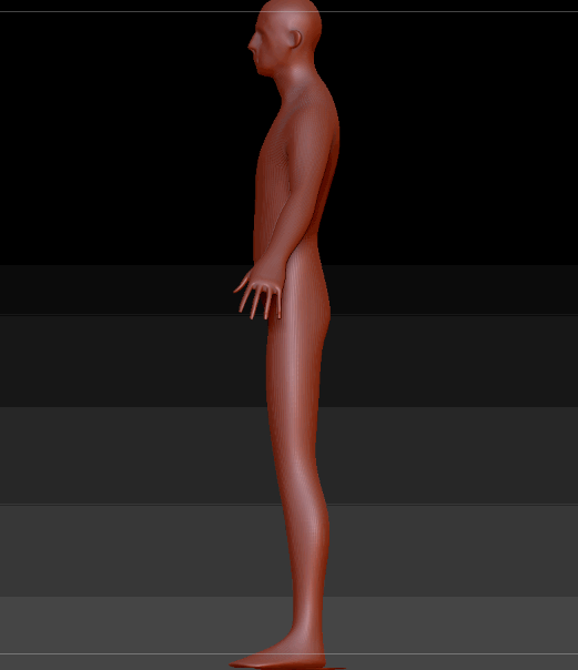

sorry to bump this old thread
how would i do something similar, yet easier of just flipping the camera to the opposite side view of the center of an object like this gif
