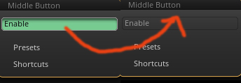

I need to know if a color button can be changed please. Just as the normal Zbrush toggle buttons (Grey and when you activate it, it becomes red; if deactivated = grey again)[i]
Can it be done?[/i]
Thank you.
nope you can’ tto change the switch button color, you can only change the color of every switch button via preferences > icolor section
Thanks Foceless for the aclaration, much appreciated.
Anyway… it seems weird that an incredible program like Zbrush cant make a button light up :confused:
Edit: Some plugins are actually doing this…
Finally Made it
[ISubPalette,“Zplugin:Tukor Buttons”]
[ISwitch, “Zplugin:Tukor Buttons:UseTablet”,1, “descriptionhere”,
[ISet,Preferences:Tablet:Use Tablet,1]
[ISet,Preferences:Tablet:Use Tablet,0]
Saved in the macros folder.
That made a new palette in zplugins called Tukor buttons wich has a button inside called UseTablet.
Now i drag that button to my UI, and it switches on and off.
Thanks :slight_smile:
